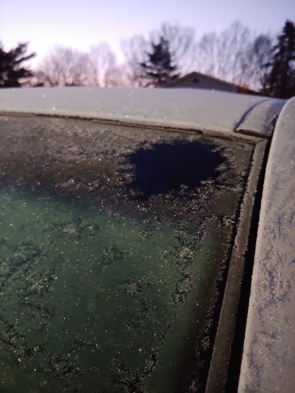

    elricfate
    elricfate Well-Known Member
    Nov 26, 2019
    #311771
    874
    2009 Tacoma AC Silver Mica
    also TIL the antenna for the 12v solutions generates just enough heat (probably via the LEDs) that it keeps the frost at bay.
    GRNT4R and TegoTaco like this.
