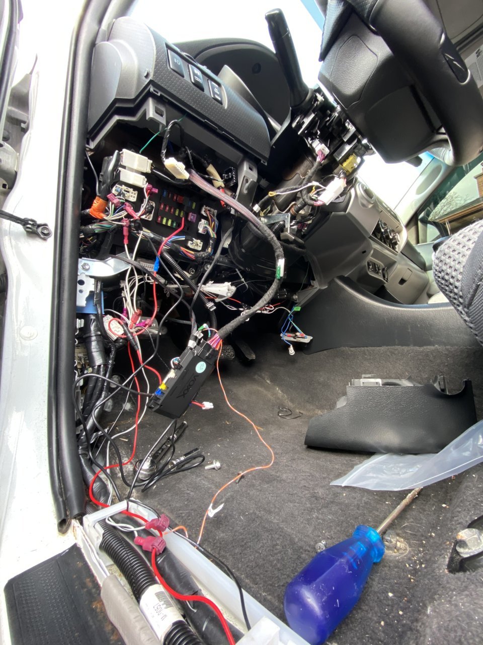

    Just installed mine and doesn’t work. Locks and unlocks the doors great but doesn’t turn it over. There were zero instructions on what connects go to what on the remote module after the wiring harness is done. Seems that they can only go into one spot per cable so... also the antenna wire has a black connector on one end and a white on the other. They are the same connectors but not sure if it matters which color gets connected to the module box or not. When I press and hold the remote start fob the dash blinks like three times and then does nothing

    If your kit came with the long range remote kit, it should plug right into black connector on the module, from the antenna.

    Yep and I plugged it into the module as per the picture on the instructions. I also connected the remaining cables of which had no instructions at all. Unless the only thing that gets plugged into the module is the antena? Which doesn’t make sense to me

    Pretty sure it was 3 harnesses that had to get plugged into the module.

    One plug has more than one option where to plug it into and there are no instructions as to which port it goes into. Also these is this long orange/white wire that just says “see instructions” which dont mention it

    I saw that one person had to reset the module and then it worked great. Anyone know how to do this?

    Which plug? Can you take pics?
