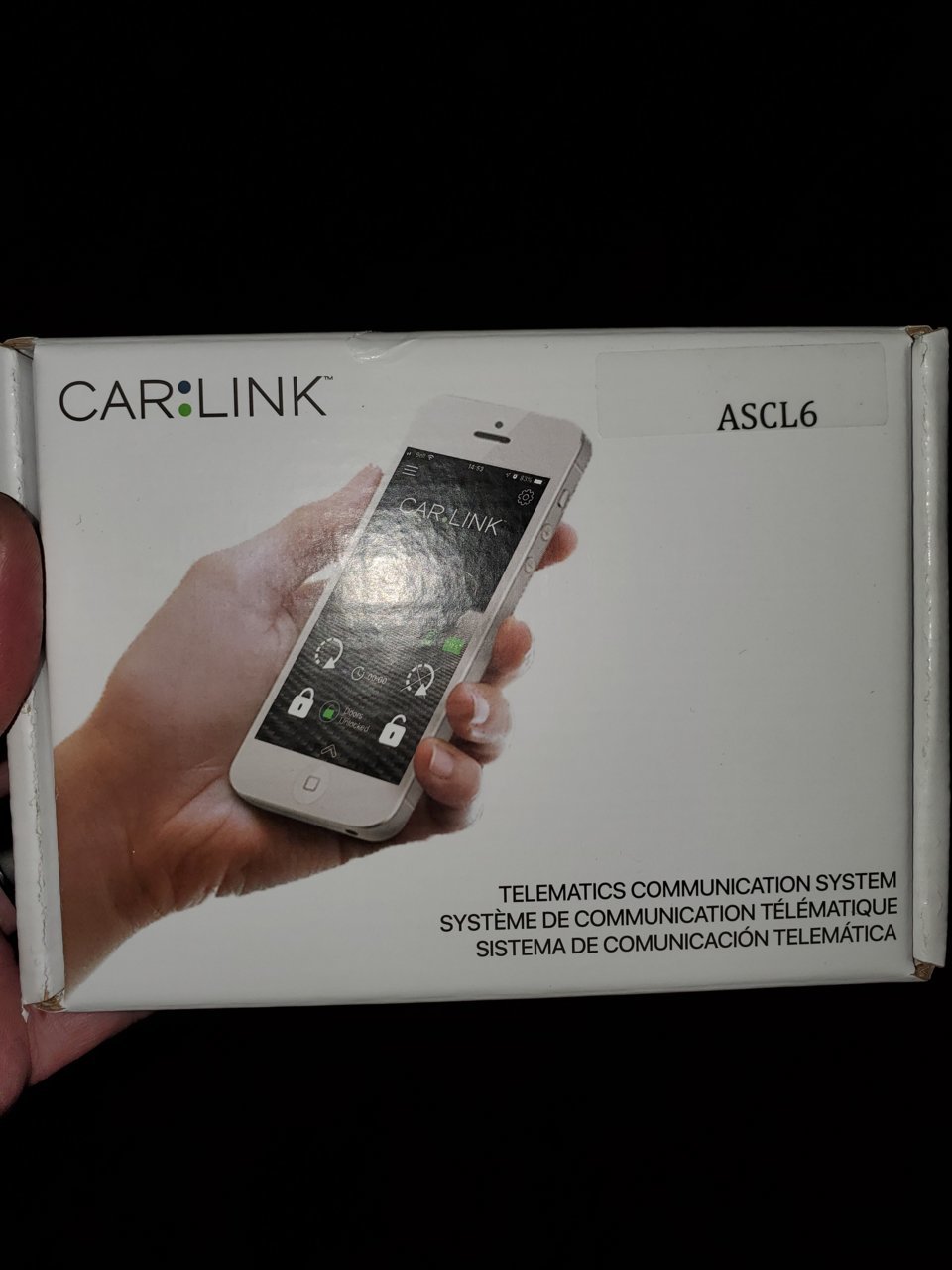

    ok i'm a little lost, help me out @jbaker1976 , what is the CL6 module from Amazon that you bought and how does that tie in with the 12V system ? also, does the kit come with an alarm ? what is the prestige alarm? or did you also purchase another product from them? apologies if there are many newb remarks here!
  15. Apr 9, 2020 at 4:36 PM
    #175
    jbaker1976
    jbaker1976 It's always Taco Tuesday
    Oct 18, 2019
    #308323
    272
    Jason
    East TN
    2015 DCSB OR
    Camper shell with side windoors and bed slider, JL Audio Component Door Speakers, JL Audio Stealth box, Grill Craft Grill, Husky floor liners, Hondo Radio knobs, Predator steps, Remote Start, Pop N Lock, etc...
    The CL6 is a an add on module for aftermarket remote start kits. Its not propiortery to one specific remote start or car alarm manufacturer.
    I cannot answer the alarm question. I have pressed the door pin on my truck and used the key fob to lock the doors and then release the door pin. The dome light came on, but no alarm?
    Prestige is a well know manufacturer for car alarms and remote start. The key fobs that came with the 12volt kit has Prestige on them . I suppose you could program a different key fob. But I assume the remote start module is Prestige as well. I'm open to corrections by anyone if they see something incorrect with any of my statements.20200409_190426.jpg

    I installed the 12 volt solutions kit about a month ago and so far it works well I would recommend it. I did get the CL6 or anywhere start witch has an app on my phone that also ties to my Apple watch so I can start or shutdown and lock or unlock my doors from my phone and or watch plus it give you info if your doors are locked or not and the voltage of your battery in the app. I do not carry the remote that comes with the kit, I just use the apps and keep my factory fob.
    E-Paz 732NJ likes this.

    so you got the app module from Amazon too or did u buy it from. Them ? This Is something u can add on later right ? Also do you have to get a certain kind to get the Apple Watch integration?
  20. Apr 10, 2020 at 5:09 AM
    #180
    HOOTERBIRD
    HOOTERBIRD Yeah You Right !
    Jun 20, 2013
    #106698
    72
    NOLA
    2013 DCSB TRD Sport, 4X4
    Yes I got it from them. Once installed you download the app to watch and phone it was worth the extra money. If your like me and park and get well away from your truck and say did I lock it. Thats worth it alone but also where I work I park far from my truck and can still start and get heat or ac going well before I can see the truck.
