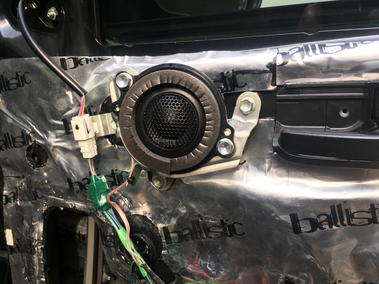

    The tweeters all mount a bit differently depending on what comes with them. I can’t picture the mounting options the Infinity’s come with but you should be able to make something work pretty easy. I’ve had good results cutting the factory tweeter out of the metal bracket and mounting the new one in its spot. This just needs a fresh razor blade and some tin snips (or deemed or whatever you have that can cut thin metal)

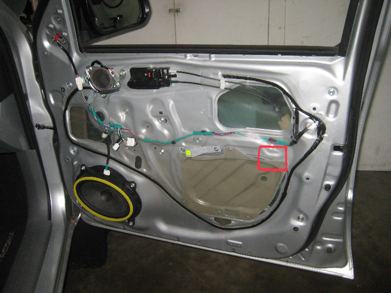

    As for the crossover, my usual spot is to zip-tie it to the bottom of the factory wiring running straight across the door. Far enough back that the big foam piece on the door panel won’t hit it. I’ll look for some pics and post them

    In this area, far enough back (you’ll see the foam piece I’m talking about when you get the door panel off)

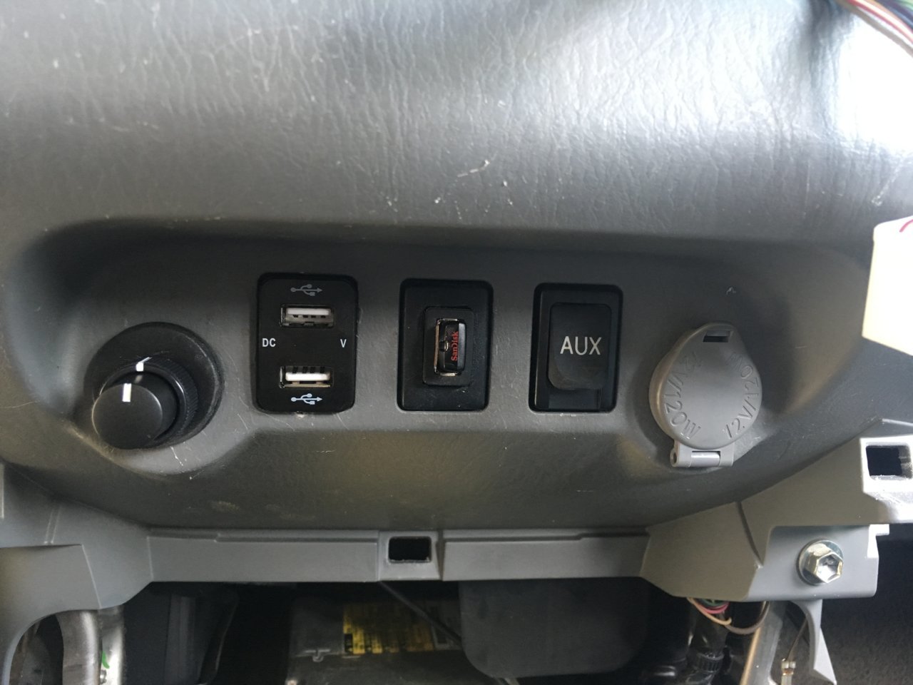

    I took out the cig lighter for my knob, it took some fabrication, and put USB jacks in place of the switch blanks.

    That’s when you just cut a rectangle in one of the blanks like Dolby shows in the previous post. It can look clean, and prevents cable length issues.
