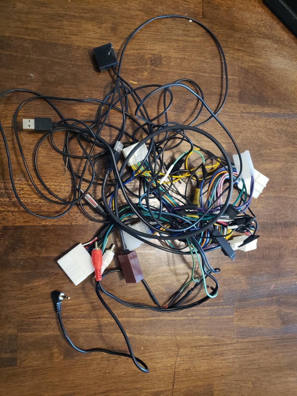

  16. Apr 12, 2020 at 12:44 PM
    #16
    seymourless
    seymourless Well-Known Member
    Mar 20, 2016
    #181857
    56
    If anyone is interested, I have a full plug and play wiring harness for non-JBL systems, including aftermarket microphone that fits in the OEM location for sale. Send me a PM of interested.
