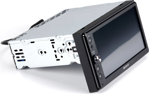

    Could be the dashkit or just needs some fiddling. With the harness adapters and all, there ends up being a lot of cabling behind the radio. It’s real easy to get one of the bundles pinched between the back ot the radio and part of the dash, and that’d keep the unit from sliding all the way back. You can also end up with some wires wedged between the “feet” of the brackets where they bolt down, and that’d also keep it from sitting all the way in.
    Neither the scosche or metra kits are immune to this... it just take some patience to make sure all the cabling is clear as you feed the headunit in.
    Single DIN radios are a little easier because they aren’t so bulky, though some of the newer double DIN units are very compact, especially those without discs players. The Sony XAV AX100 I have installed (not the one in the photos above) is like a single DIN radio chassis but with w double DIN face display... it was notably less fiddly to install than the Unit in those photos.
    Here’s what the Sony chassis looks like:

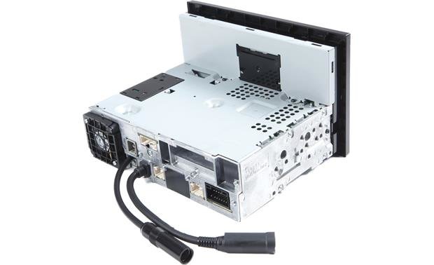

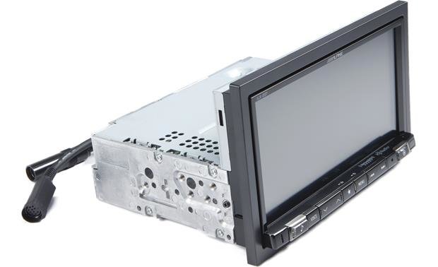

    https://www.crutchfield.com/p_500ILX207/Alpine-iLX-207.html?
    Alpine has a nice one too. The ILX-207.
    DRegs[QUOTED][OP] and drewskie like this.
