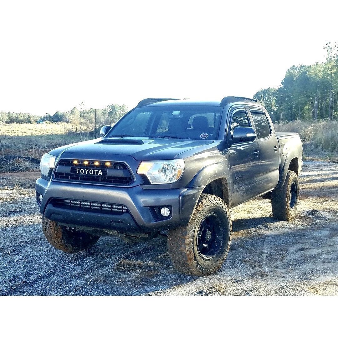

    I have been searching for a grille that has white raptor lights (instead of orange) for my 2015 Tacoma like in the photo. Anyone know where I could find one or have someone custom make?

    Thanks! However those lights fit in the TRD pro grills for 16+ :/
    That’s all I could find

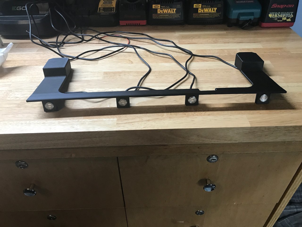

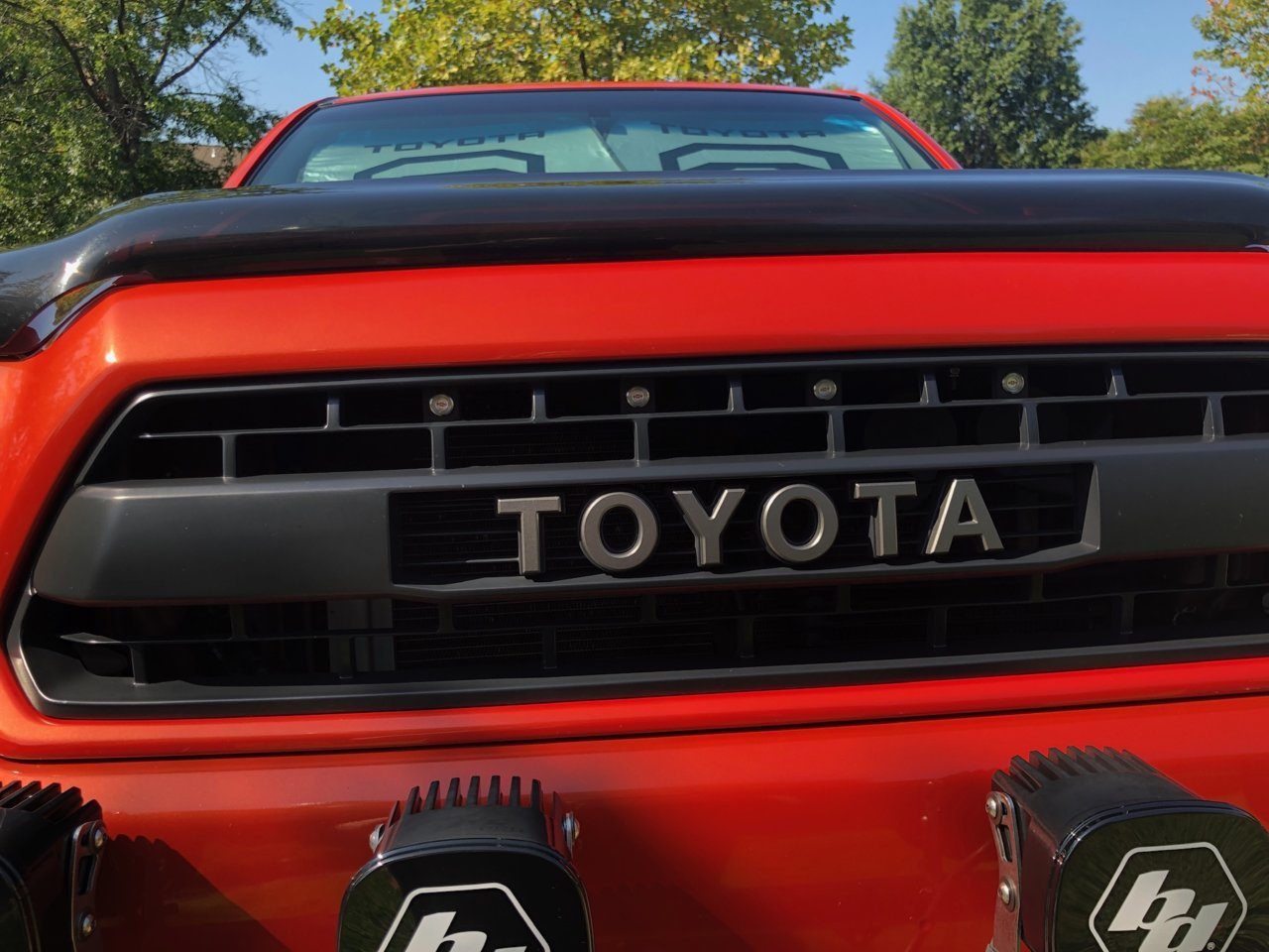

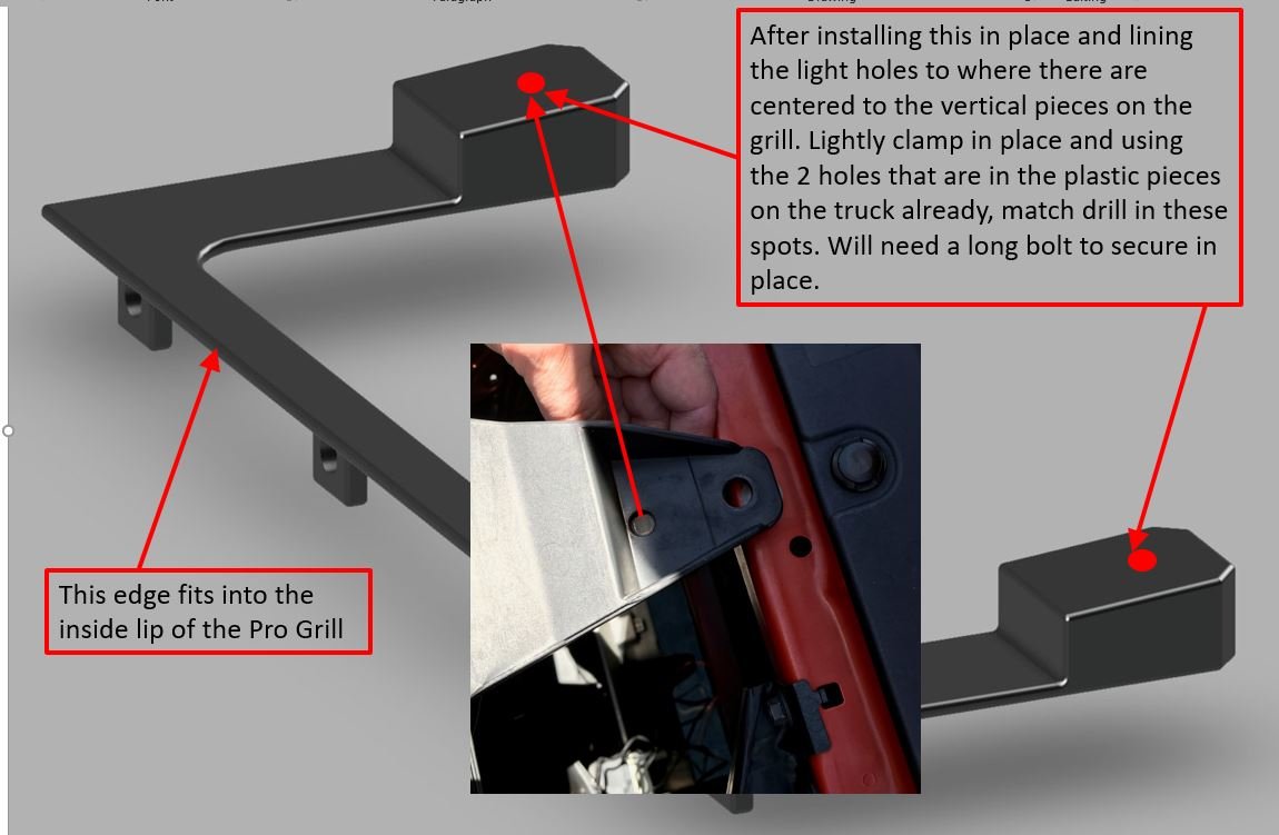

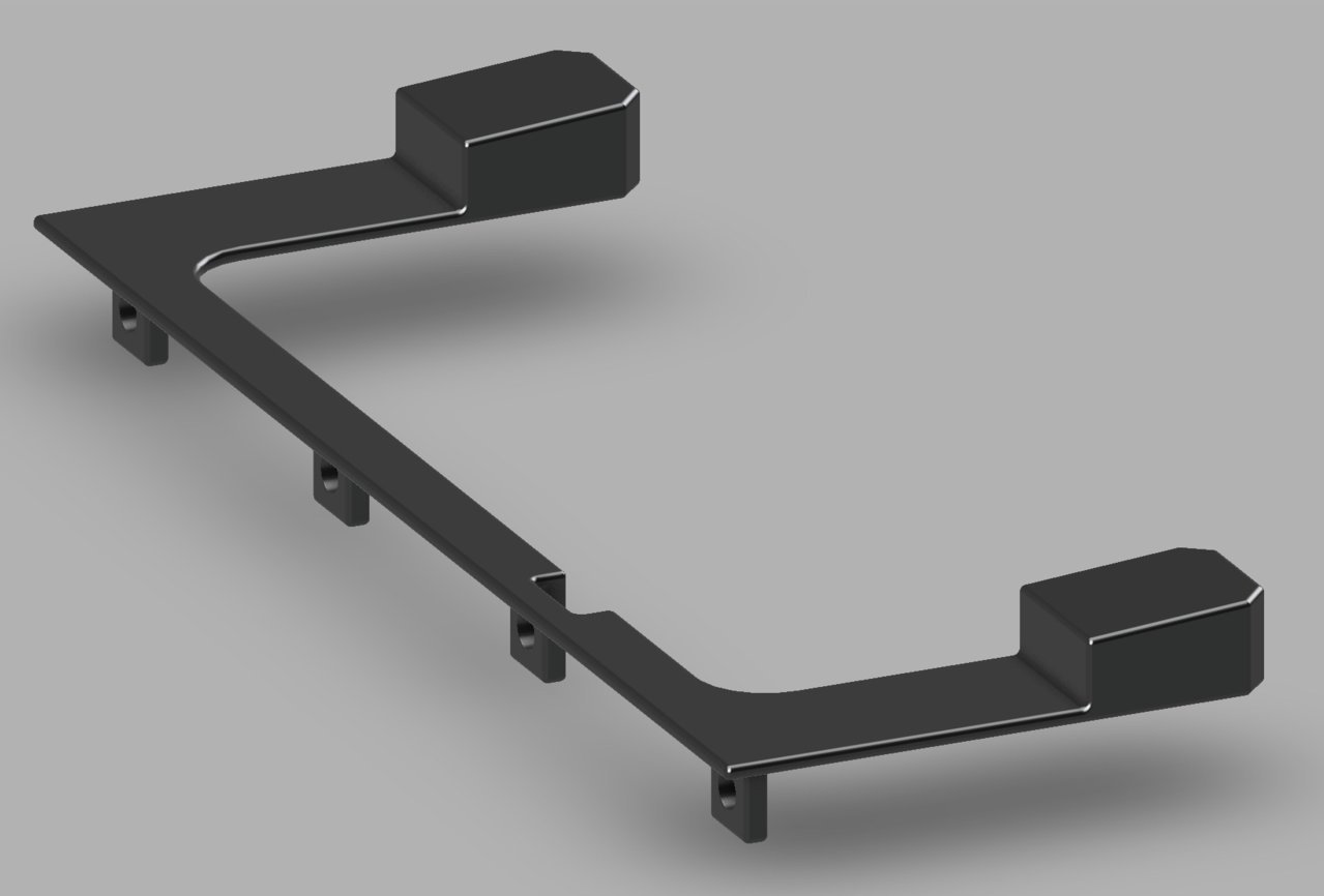

    @Shan92wow, I relied to your PM. Here are the picture of mine. The pictures do not show it properly, but each of the 4 lights line up perfectly to the little vertical pieces of the grill. I designed the part and had to print it 3D times to get it right.
    Mine are amber lights, but they do come in white as well. I believe these are the one I used, 11mm SS which do come in white.
    https://www.oznium.com/led-bolts-prewired-leds/led-bolt
    I need to verify the part number to what i actually ordered
