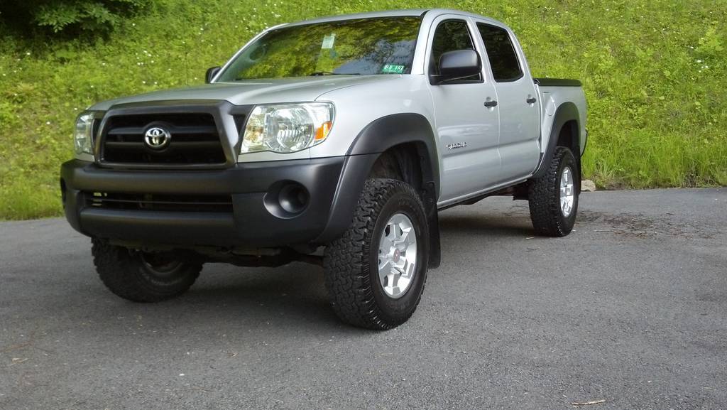

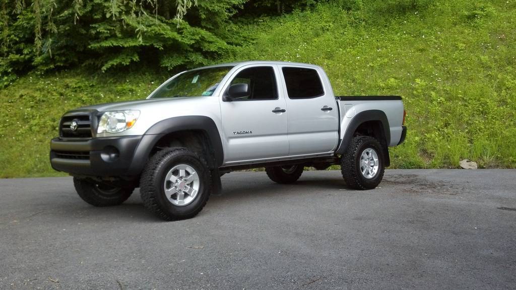

    Here she is with the rear aal and the Bilstein 5100's set at 2.5". Thanks guys

    Yes on the bushings. Is it common to have spring/sway bar contact?

    Why is it hitting the sway bar? Why is it with some set ups and not others?

    Was you alignment in spec at 2.5? What's the height of your AAL?

    Local garage was able to get my alignment in spec and my aal was supposed to be 2-3" but after installation it was almost 4".
