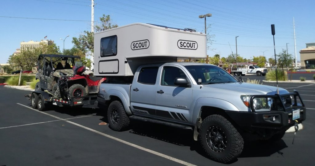

    The Travel Trailer isn't something I normally tow, but it was fine traveling over the Cascade Mountains and halfway across Washington state. I was just pulling it for a friend while he towed all our toys. The ATVs are actually about 1000 pounds heavier on that car trailer, and I've towed it from the Seattle area, down to Utah, across to Vegas (that photo) and back up with no issues whatsoever (with the camper on the truck). Gas mileage sucked, but that's to be expected.

    Nice! Yeah, gas mileage went out the window a long time ago for me. For years I've been camping out of my CVT on the camper shell and we just moved to the Casita for the camping duties recently. This is good insight though, greatly appreciated.
