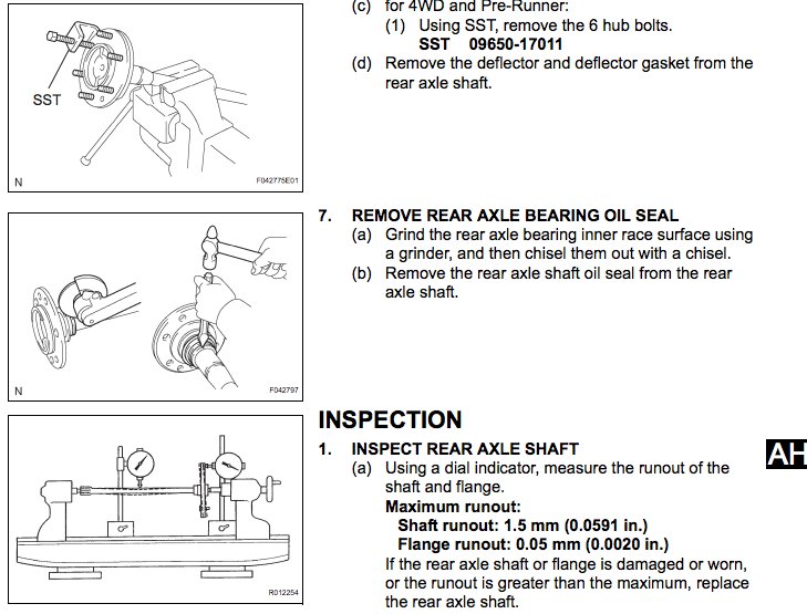

    There's not much out there aside from a write up on TTORA for 1st gens. My write up isn't exactly thorough but I think it's enough to help out the more mechanically inclined.

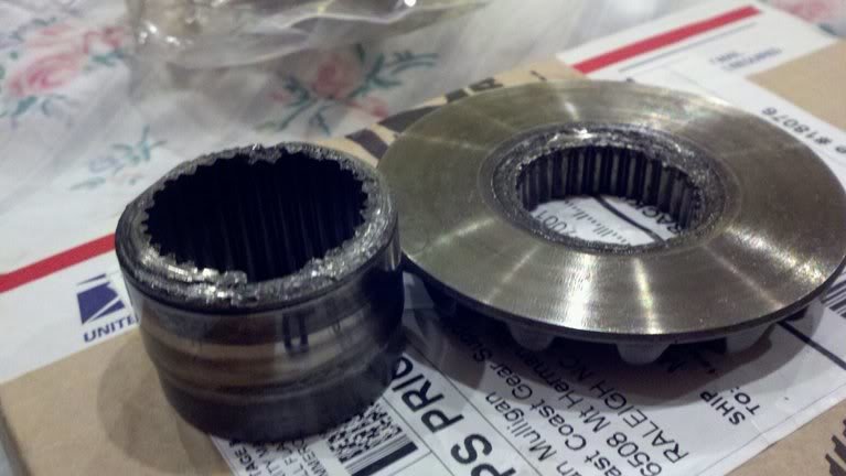

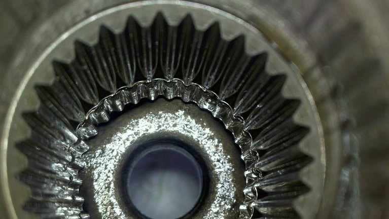

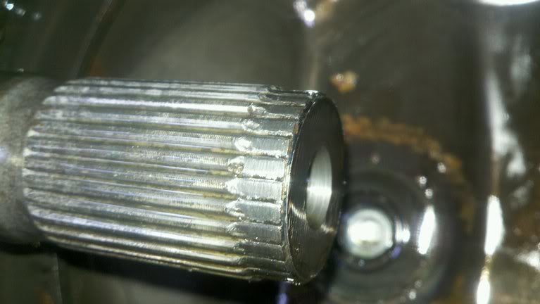

    Unfortunately I uhh stripped some splines off the stock shaft in a Moab TW meet mishap and while the bearings are good I needed to replace the shaft. I ordered a "right" axle assy with backing plate and good bearings from a wrecker. Everything seemed good until I went to install and found out the damn backing plates are side specific and even though this was a "right" axle apparently they think right means driver. So... rather than messing around with trying to find more parts I figured time to suck it up and do THIS.
    FWIW heres my stock axle and side gear. This is also what a broken side gear looks like in the diff.

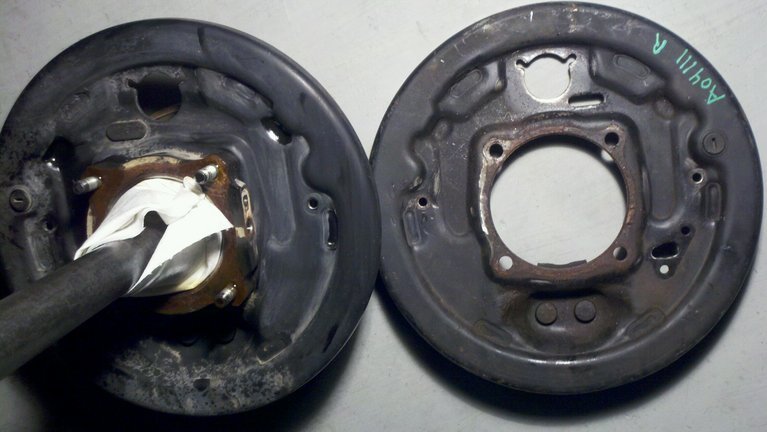

    To start off the driver and passenger side bearing and backing plates are side specific. However from my measurements both passenger and driver axle shafts are the same lengths. 31 and 13/16" roughly.
    You can see the differences in backing plates here.

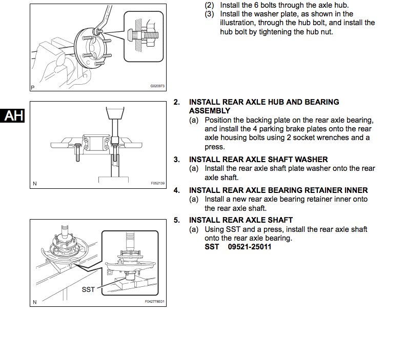

    You can see the Toyota SST here.
    Pretty simple tool, hangs from the press and then the bearing bolts to it. Then simply push on the end of the axle shaft.

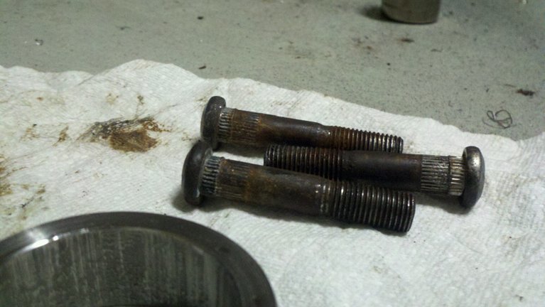

    Once you have the bearing and backing plate off the shaft you'll need to drive out the mounting studs. I got 3 of em out but the last was a PITA! I ended up drilling the head out. EDIT: the stock shaft was much easier
    I used a small sledge and a socket to go under the backing plate/stud. Thread your nuts on to protect the threads and give em some good whacks.
    You'll need to re-use these unless you get extras from Toyota.
    You'll also need your backing plate so don't trash it either. It's pretty stout though.

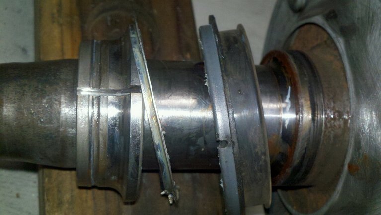

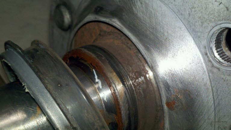

    You need to get the inner race off the shaft.

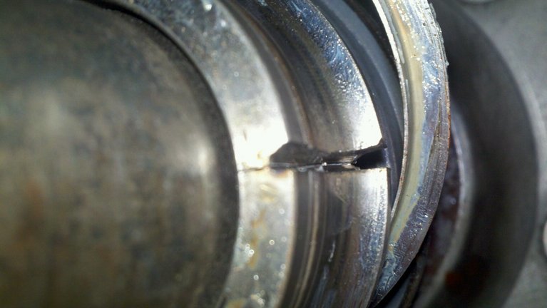

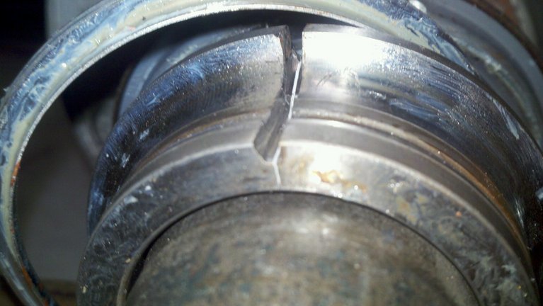

    You'll take an abrasive cutting disk and carefully notch the inner race. Then take a chisel and give it some good whacks while supported by a block of wood. It should crack and then you can slide it right off.
    You'll be left with a pile of parts.

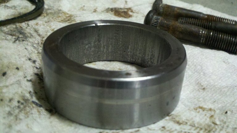

    One of the races, this has the tone ring.

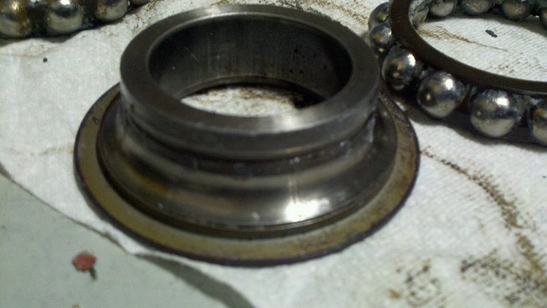

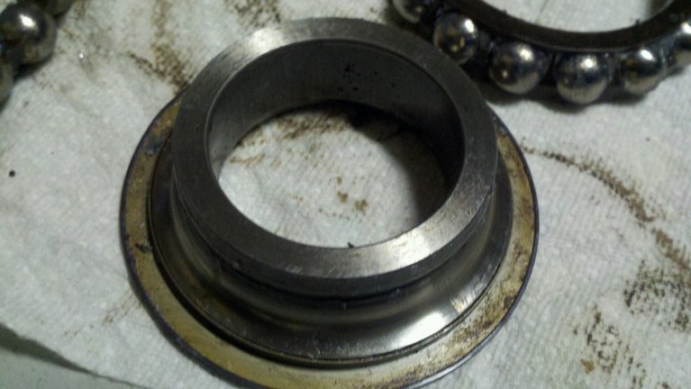

    You can see how much galling took place, the shaft (much harder) is unscathed and perfectly smooth. This collar (softer than the shaft) is also what the oil seal rides against.
    Studs

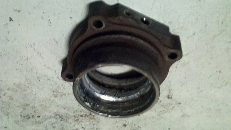

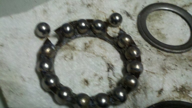

    Heres the bearing housing/race
    Ball bearings rather than taper roller oddly enough.
    Also take note the washer in the corner, this sits behind the pressed on collar. Convex away from the bearing.

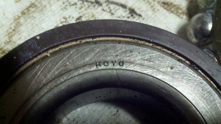

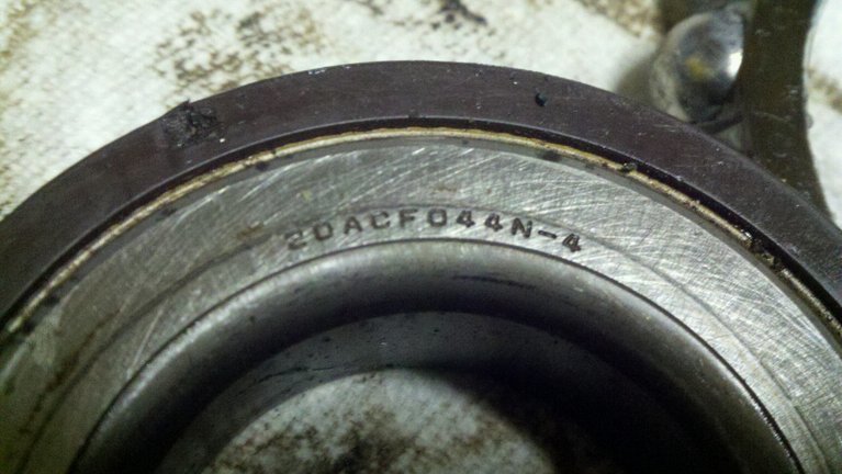

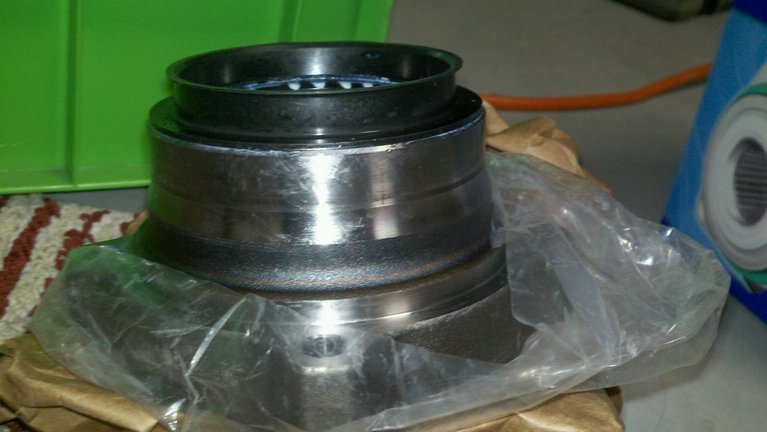

    Koyo OEM
    Replacement bearings from Napa, think ahead order online and save a butt load.
    Napa "BGR" in an SKF box. Good fortune would have it that they're Koyo bearings!

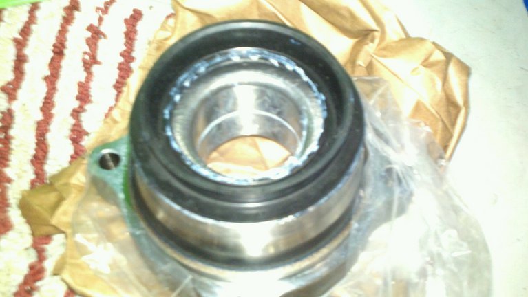

    Also bearings are side specific, I think the only difference is the mounting for the ABS/tone ring sensor.
    DRIVER
    PASSENGER

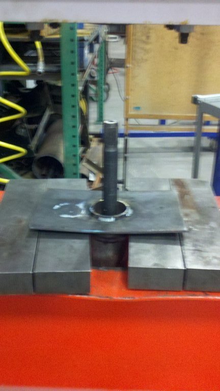

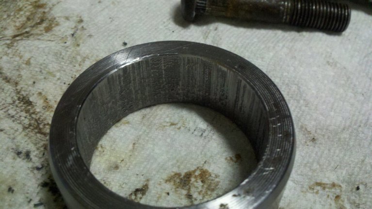

    So back to pressing the bearing off...

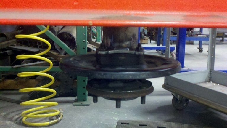

    Heres my tool in the press. 1/4" plate isn't quite adequate, the bending of the top plate is from something else but the bottom at the bearing started pulling apart on this 2nd pull. I had the welding shop weld it up for me more. The 100 ton press would have had no problem tearing this thing apart.
    I ended up pulling it back out, setting the collar on an anvil, and striking it with a chisel, trying to spread it out (similar to splitting the inner race). I already had a new collar which you should get regardless. After giving it lots of good whacks, we put it back into the press. Came off much easier. I won't say it's a requirement but probably a good idea.
    After I got the old bearing and backing plate off the shaft I threaded the nuts on the studs and pounded em out, they cam out super easy this time for whatever reason. I believe I just sat the whole thing on the anvil.

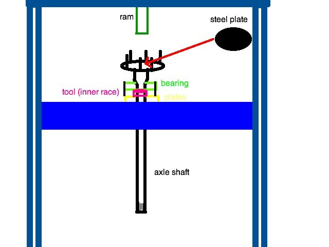

    This is how I pressed the bearing in.
    Bearing first, the inner race you split off the shaft from the old bearing is perfect (as it easily slides back off the shaft), under that put a piece of tubing that will fit over the shaft and fit against the inner racing you're driving the bearing on with. Find a flat round plate that can sit on top of the hub between the studs and use that to put the ram on.
    Go slow and turn the bearing while pressing to insure nothing is binding. Also be mindful of the safety hazards present (exploding race comes to mind).

    So now I follow where you get that measurement stuff. Did a bearing on a Tundra shaft... kinda. Definitely prefer the Taco. No measurement for the Taco.
