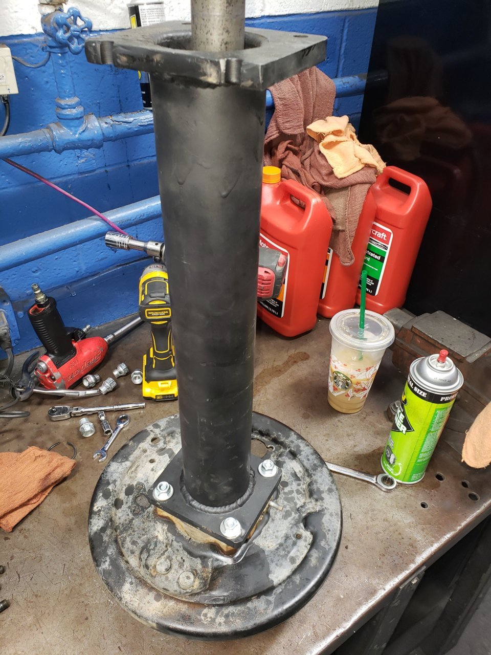

    Anybody know the diameter of the axle shaft? I'm getting ready to do my 2010 prerunner and I'm going to make the press tool. I have a piece of pipe, just not sure if it has a big enough diameter.
  14. Jan 13, 2019 at 7:43 PM
    #34
    Dalandser
    Dalandser ¡Me Gustan Las Tacos-mas!
    Feb 19, 2015
    #149090
    17,635
    Anthony
    Downey
    08 PreRunner Regular Cab / 98 4x4 Extra Cab
    Empty Wallet Mod
    I have one out right now do they get wider at the bearing or anywhere else or all they all the same od?
  15. Jan 13, 2019 at 9:27 PM
    #35
    Steeler
    Steeler Active Member
    Sep 17, 2009
    #22917
    33
    I don't think it'll matter down past the bearing.
    What's the od down to that point?
  16. Jan 13, 2019 at 9:37 PM
    #36
    Dalandser
    Feb 19, 2015
    #149090
    17,635
    Anthony
    Downey
    Empty Wallet Mod
    The shaft diameter is 1.32" down to where it flares out to the snap ring at 1.74"

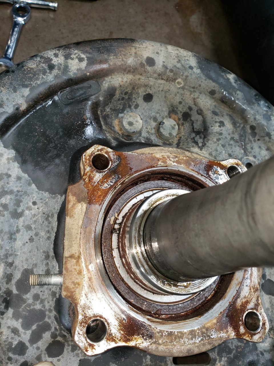

    Hey all, ill be doing the driver side rear bearing in a few weeks.. does the tone ring come off of the old bearing?
