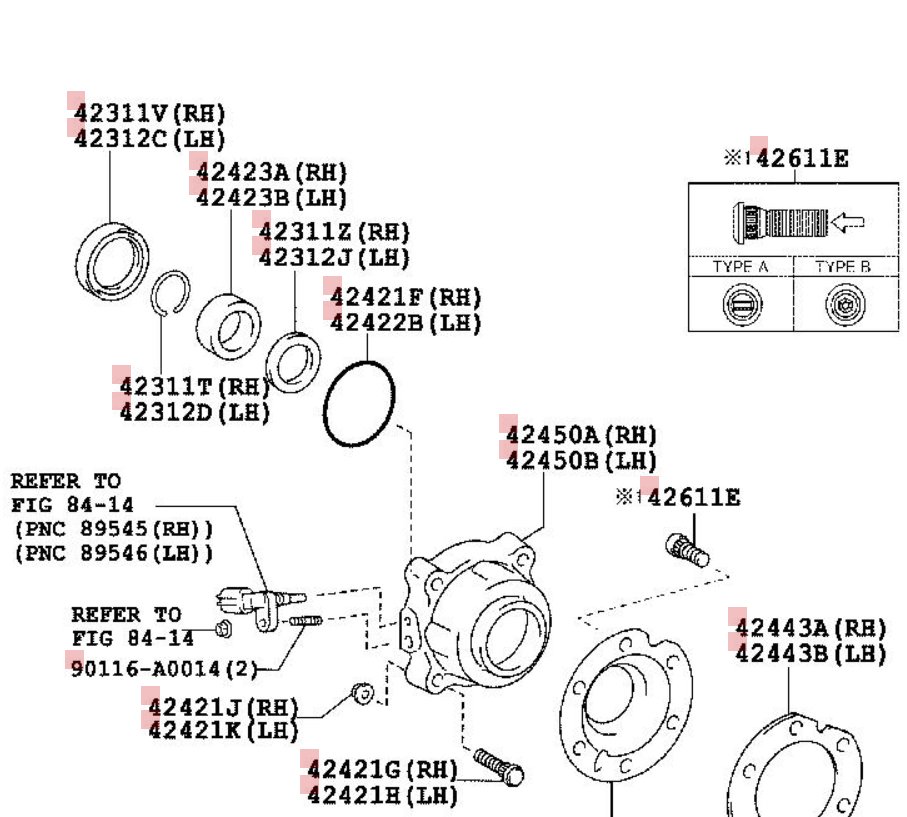

    Here’s the P/N for the rear axle shaft
    4231104082

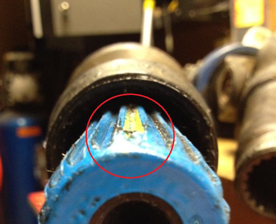

    I've spent quite a bit of time beneath my rig looking at the male and female splines on the driveshaft, and I'll be damned if I can see any differences on the male side. The female side has two gaps, 180 degrees from each other, but the male side looks to me like it is consistent splines all the way around.
    Also, when you pull the axle, undoing the four bolts behind the backing plate, it appears that there is no gasket or o-ring, just flat steel surfaces. Isn't there gear oil out to the end of the axles? Or is there an internal seal that keeps the lube toward the pumpkin and not out on either end? Or even more likely, did I miss something? Is there supposed to be any kind of seal?

    The male end has two splines that fit in that key, hard to tell but this is what they look like
    There is an o-ring, it comes off with the hub/axle shaft assembly when you remove it. Oil is in the differential housing all the way up to the rear hub, some dana axles have a seal at the differential that keeps oil from entering the axle tubes. If you don't have an o-ring, there would definitely be gear oil leaking out onto the drum brakes, the PN is 9030183002

    I'll figure it out one way or another. Thanks for the part number.
