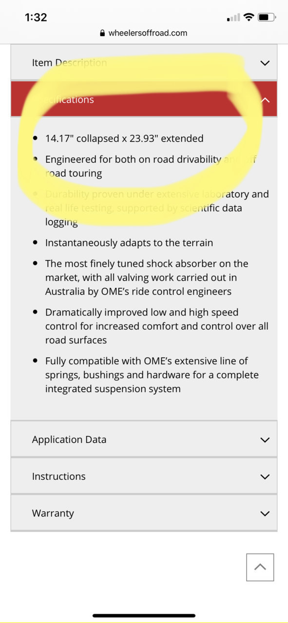

    please just post the correct numbers. According to wheelers this is what it says B9A56CC8-4F2E-4774-A0FA-091B530D27D5.jpg

    The reason I didn't is because I don't know their actual lengths. I see different numbers in different places. But I know the "14.71" collapsed length that was originally posted here seems too long to work without extended bumps, and looks like a likely typo from from Wheeler's 14.17.
    But also, other vendors say these shocks are shorter at extended length than what @Wheeler's Off-Road Inc says. Since I haven't personally measured them, I don't know who is right, and I don't want to proliferate possibly errant numbers: someone destroying their shocks on account of me posting wrong numbers would be an expensive mistake. o_O

    ... I have these shocks, so will measure them this weekend if no one can chime in before then with some authoritative numbers.
