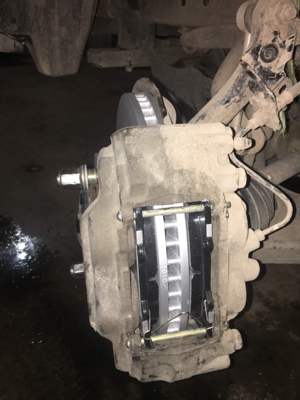

    I really liked the Napa Ultra Premium Rotors with the Adaptive One pads on my 07.
    The Ultra Premium rotors are coated and have a guaranteed runout of less than 0.002. D38999A1-927F-402D-9ED2-18CB5CD0275A.jpg
    I just put a front and rear set of these on my sisters 2005 Chevy Trailblazer and she’s a fan as well.
