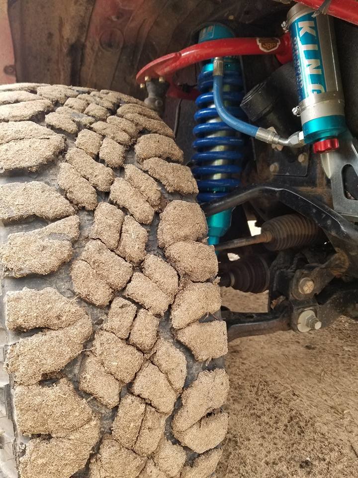

    So what I ended up doing was buying the 6" front and rear shocks from King (contact Noah on Toyota Tacoma Enthusiasts Facebook Group). I also bought the JBA UCA's as well. Did all the work myself and it's been fantastic. I still have to dump the rear blocks and replace with leafs from Deaver. I contacted them and got a quote for around $700 something last I recall. No fitment issues with any of the RC components either and I did put new lower ball joints in since the JBA's have them. Obviously you want to get an alignment afterward. Also, check your sag as I think I was about an inch lower on the driver side after it all settled. Hope that helps. I don't regret any of it. Glad I went the route I did.
    I should also note that I dumped those stupid 18s and put 17s on. With the King shocks and 17s it's a much nicer ride plus I can air down a lot more which is a big deal for me as I do a bit of offroad.
