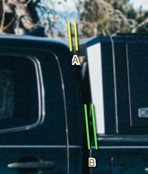

    Hello OP (and others)
    forgive me for repasting a cut from your photo posting.
    I have my cap on order and i was wondering if anyone here that has one could measure the gap distance between the smartcap and the cab at the bedrail height and along the top as shown?
    I would like to be able to have both the cab rear window on my 2015 open and the smartcap window open and have a weather seal between the two so heat or cold air being vented via a hose from a dashboard vent can be placed thru to warm or cool the cab when i remote start and do it without want the outside air also penetrating thru each open window
    trying to find a way to somewhat seal the passthru between the two windows
    i have head that the window on the smartcap is a bit recessed back from the outer panel it sits in and that the outer panel is closer to the truck cab than the two windows are from each other.
    im trying to determine if a 1.125 inch seal (greater or less) can be placed on the forward face of the smartcap before it is put onto the bed to help for somewhat of a seal (doesn't have to be water proof) but enough to minimize outside air penetrating excessively into the gap area between both windows when open
    or maybe a seal on the smartcap and another on the back of the cab and have them lined up to touch each other if the gap is greater
    any measurements or knowledge of any way that someone might have done this short of or in lieu of inserting a small innertube and lightly inflating it while parked will be helpful
    id like to avoid having to install and inflate something and then remove it each time i have to drive

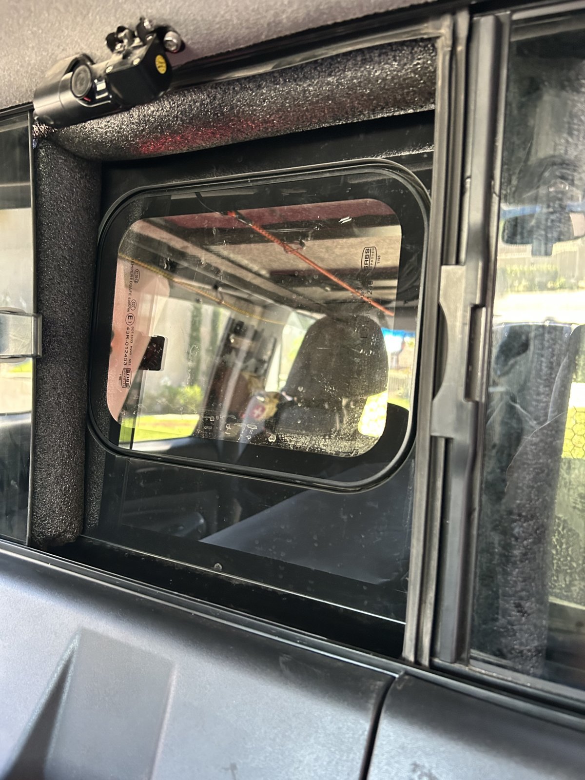

    to seal the gap between the truck rear window and the smartcap forward to cab window...........I found the perfect thing....ridiculously simple.....
    a 3 inch diameter pool noodle.... a solid core one..... i cut one piece to be just wider than the truck rear window center sider and it fit perfect when pushed up from the inside by doing so with the windows both open and wedging it upward between the truck and the smartcap until it stops against the cap window frame and the the truck body just below the third brakelight on the cab...its a press fit so it just stays right there in place, no glue no tape just compression between the truck and the cap holding it in place......... then i took and cut two pieces for the vertical sides and took a sharp knife and sliced an angle taper into each one leaving them full at the top and about half width at the bottom and then wedged them in between the two open window from the inside i made sure the top piece over hangs the side pieces for water repelling fit no vertical gaps. .... After doing this, i drove thru a carwash with the truck rear window open and the smartcaps forward to cab window open and no water penetrated. the three pieces stayed in place without having to be glued or anything even at 90 mph ... and hey, if they do wear out.... then ill just cut new ones and push them in
    bottom line is i just returned from a 23 day road trip from socal outbound to mt rushmore and then back thru yellowstone and grand tetons and other places in between and it stayed in place the whole time even during rain and high speed hwy driving as well as off-roading on trails and backcountry routes never got any rain or water or dust come in thru the open windows.. yes, i left the two windows full open the entire 6900 miles and 23 days and they stayed in place.....also i was able to remote start the truck while in my sleeping bag on my mattress and had the heater controls preset for high and hot and a little portable fan hanging at the open windows drawing the cabin heat into the cab so in the mornings i had a nice warm cab in about 15 minutes after remote starting and before crawling out of my bag and starting my day (of course i also insulated and carpeted the inside of my smartcap)
