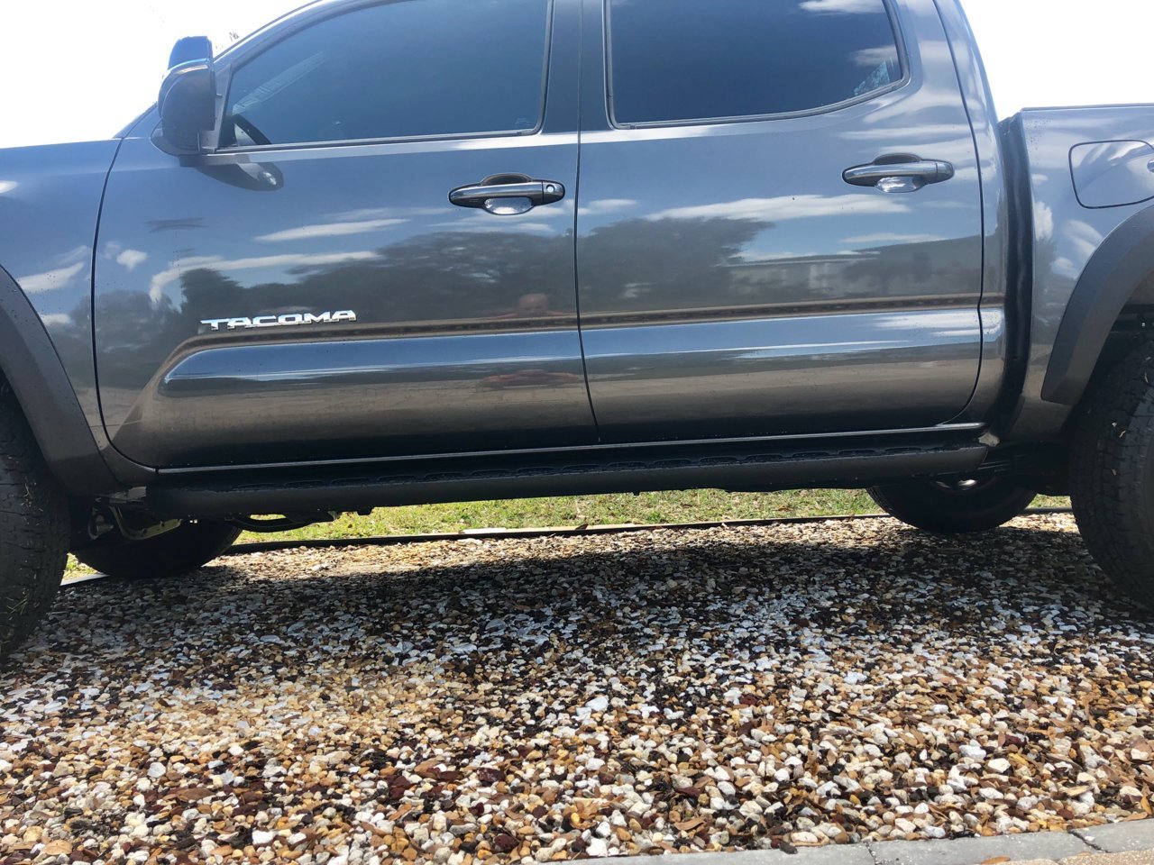

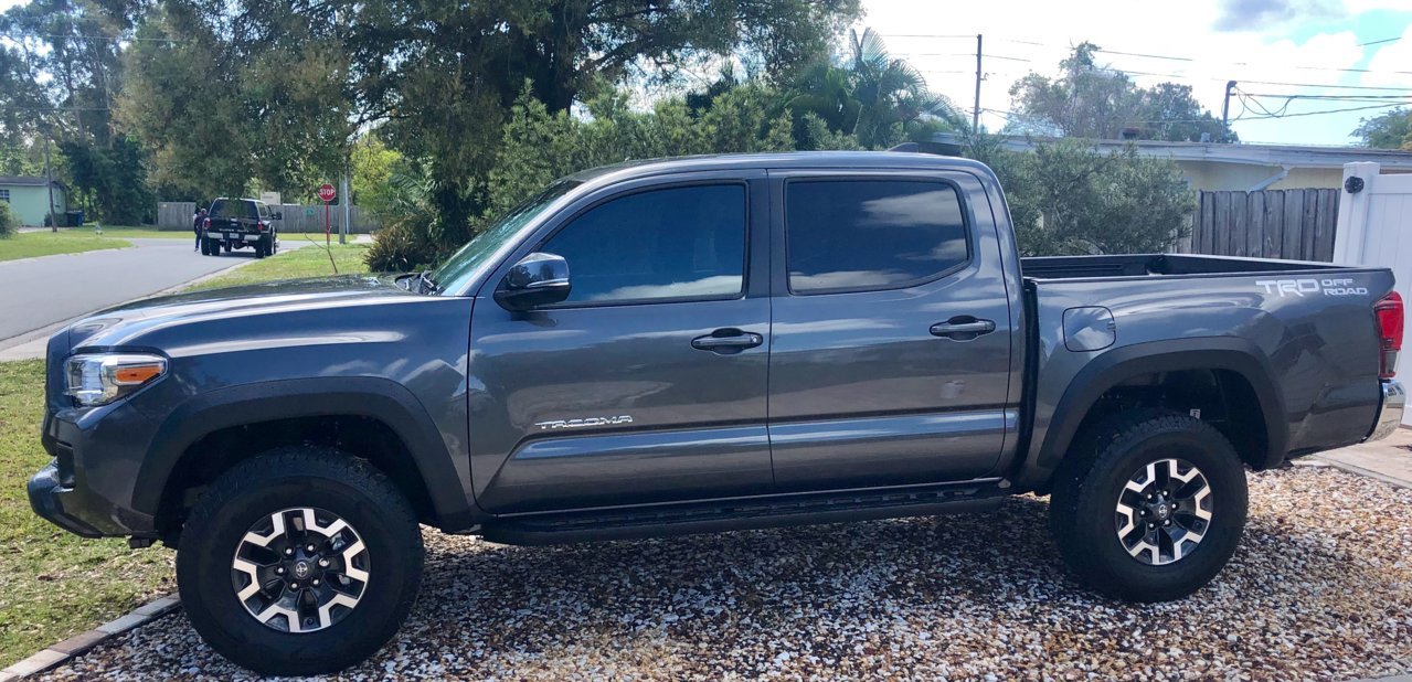

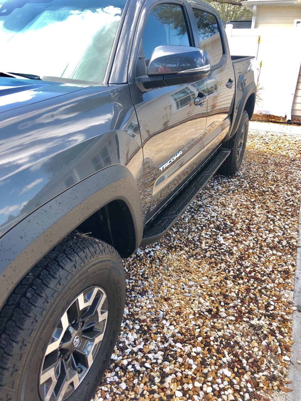

    I purchased 2nd gen old style oem running boards and installed them on my 2019. They were only $299 from eBay. I had to slightly enlarge the bracket bolt holes with a Dremel so I could easily line up and thread the bolts into the frame by hand. I had these same boards on my 2013 and loved them. They tuck up high so they don’t reduce ground clearance and don’t scrape your leg skin off like other designs. They should make it easier to reach the roof and protect against door dings. Most online resources say they won’t fit but they do as you can see.

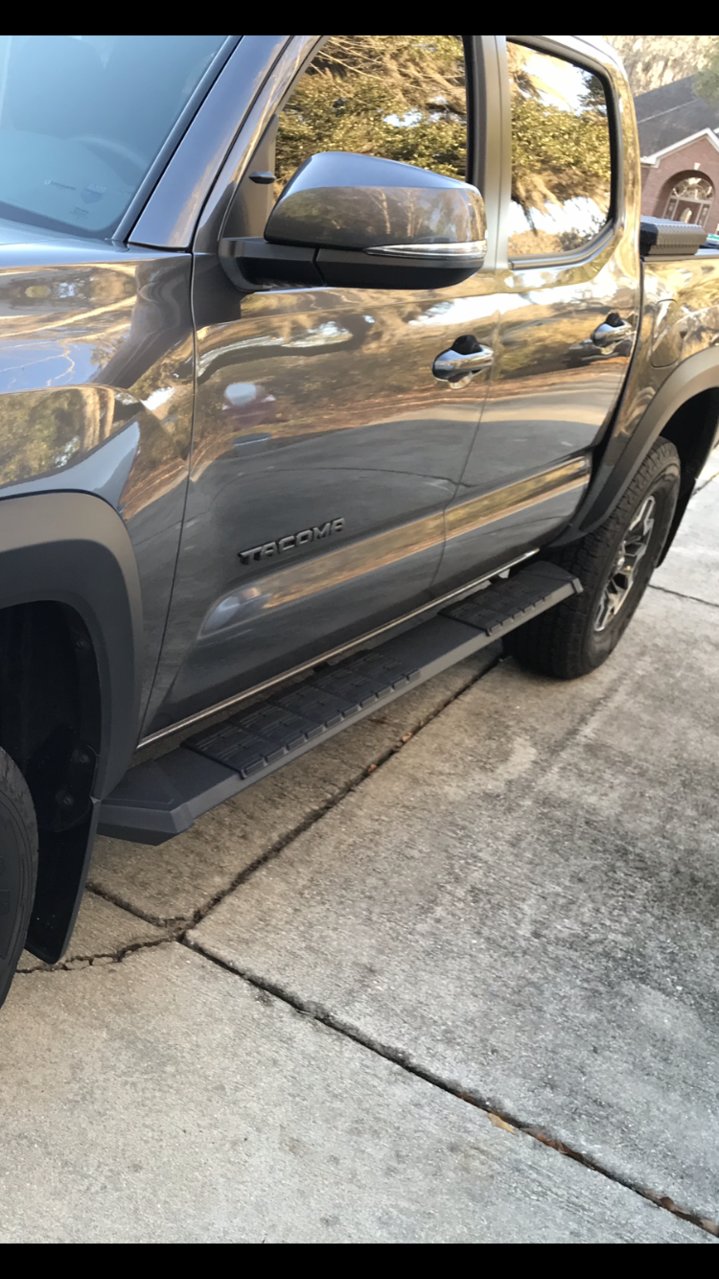

    Yeah it’s a good solution. I like them too. I took one off my 2006 tacoma and it bolted up fine. I like them better than these. They don’t stick out as far.

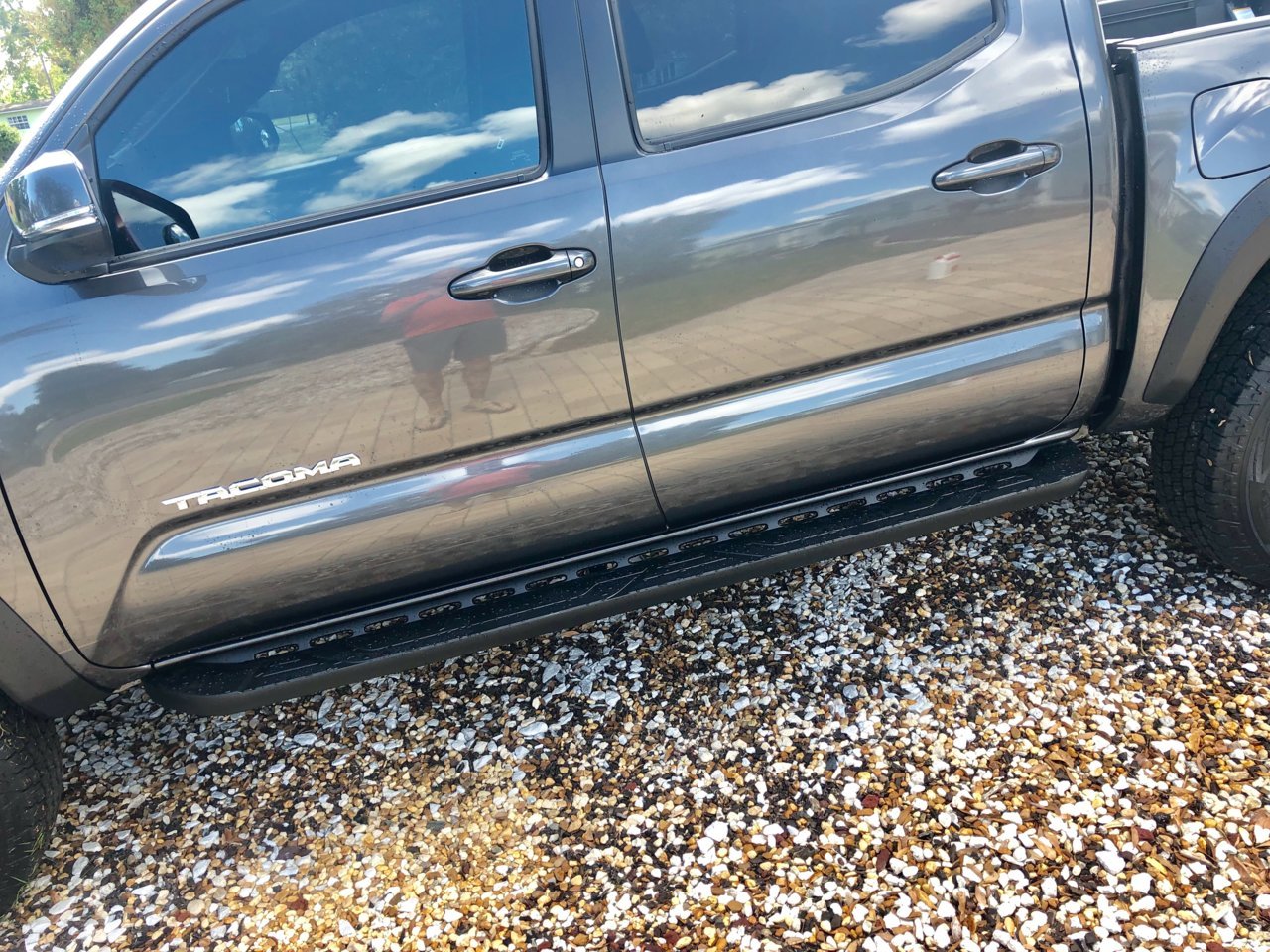

    I like both of these. I'm not all that crazy about my Predators honestly...
