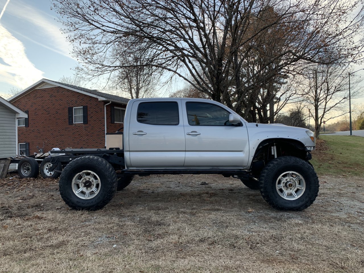

    Just curious if there is anyone else who has a 2nd gen solid axle truck with leafs up front. I’ve seen one other one before, but most people 3 link them.
    I’d love to see how other people did it.
    See if I could have done things better or what not.
    here’s mine.

    Any close up photos of what's going on up there? Looks like the leafs are flat and it isnt a sky scraper so that's good.

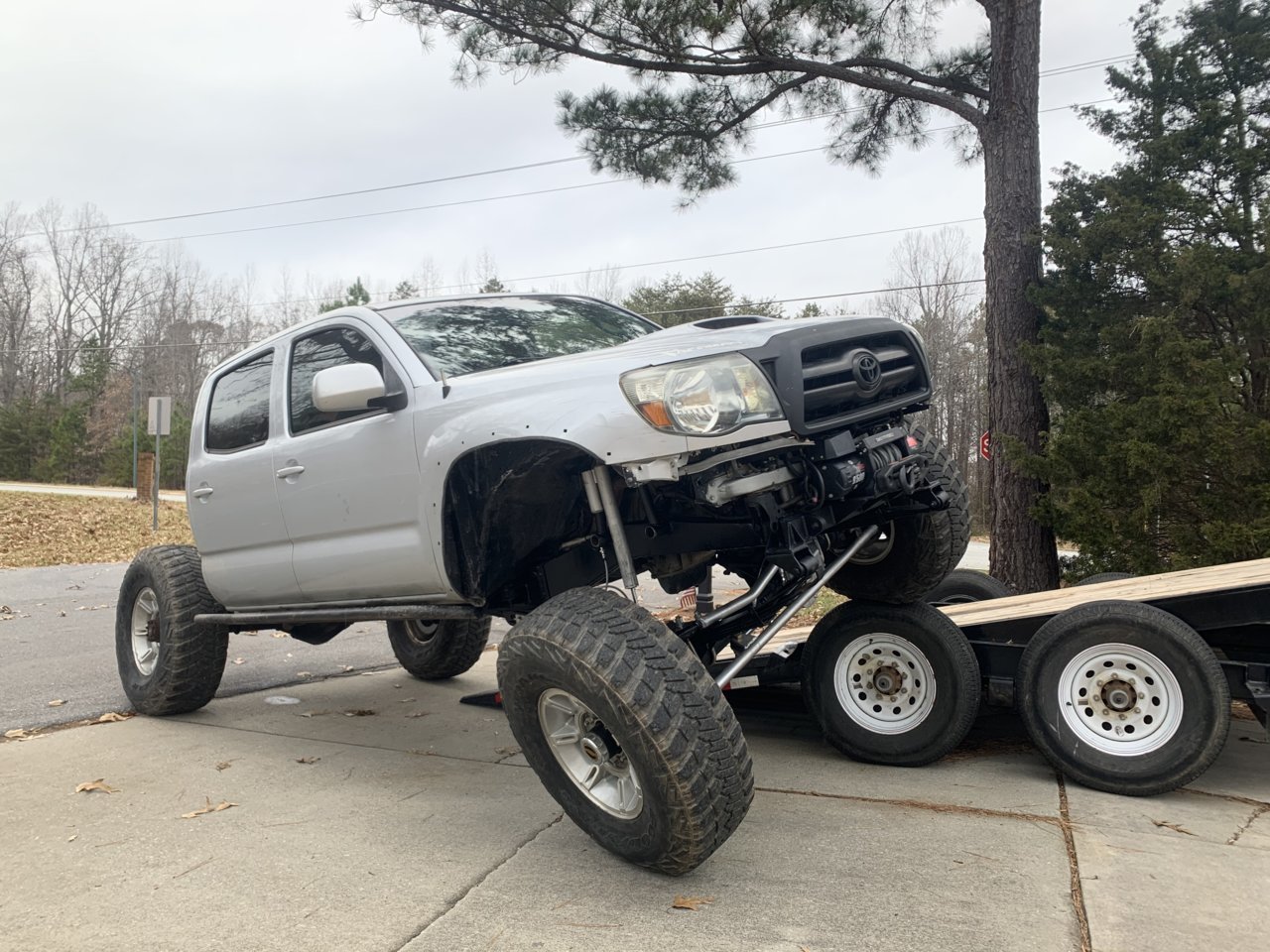

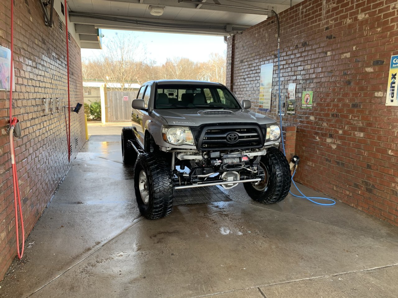

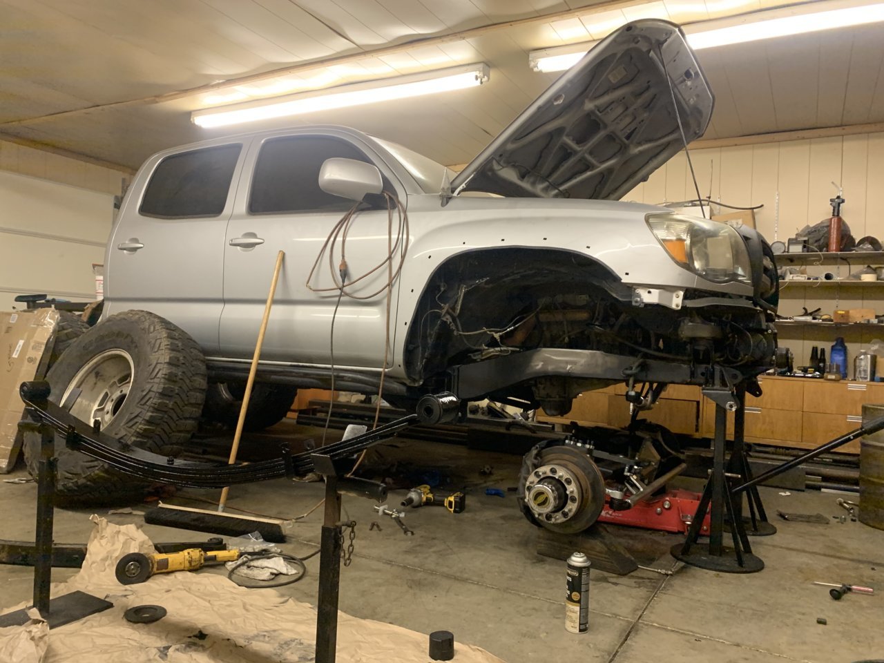

    They sit pretty flat. I have about 3 inches til the bumps hit. They compress about 1.5-2inches. Rides pretty smooth.
    I used slider boxes in the rear instead of a shackle. Keeps it a little lower.
    Fenders are cut pretty high so it looks higher than it is up front.
    https://www.tacomaworld.com/threads/budget-solid-axle-2nd-gen.644264/
    here is my build thread.
