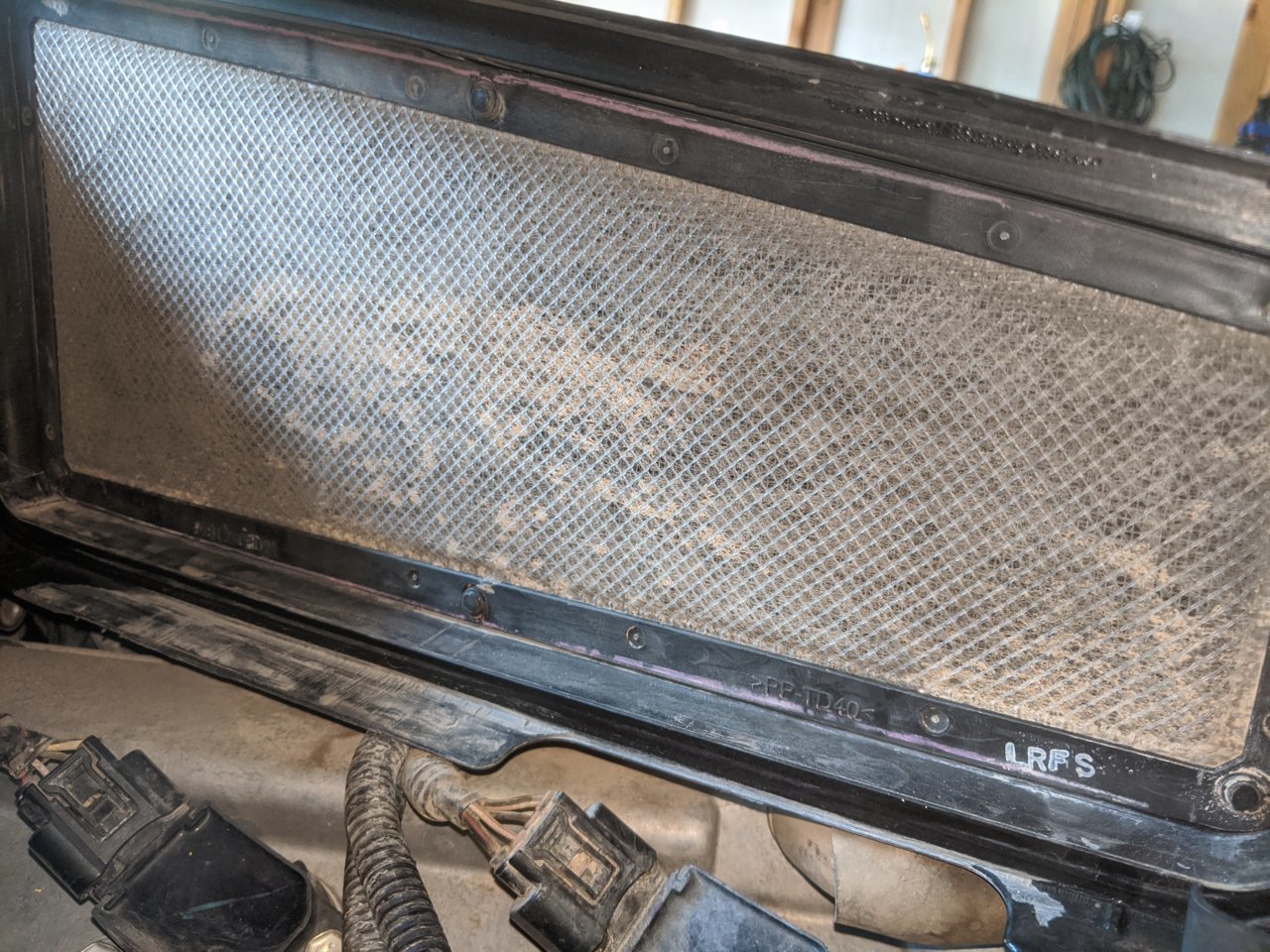

    My secondary filter has mud stuck in it from a while ago. I was wondering can I remove this or is there a way to take it out and clean it?IMG_20200828_123329.jpg IMG_20200823_132921.jpg

    Use a soldering iron to heat up those plastic rivets and pop the filter out. Then use a high quality air filter.

    Mine popped right out

    That's a charcoal/ carbon filter, to trap fuel vapors.
    Really, it should not be dirty at all.

    I would consider the Rug Doctor method, using a squirt bottle, wet it down and try shop vacin' it out?

    Hey that's a badass idea thanks.
