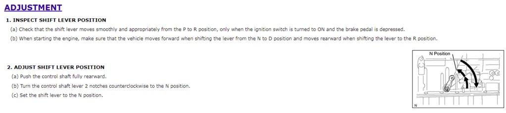

  15. Nov 13, 2024 at 4:17 PM
    Dm93
    Dm93 Test Don't Guess
    Mar 3, 2015
    #150066
    13,614
    Texas
    2014 DC OR 6spd 4x4
    Predator tube steps, Ranch Hand grill guard, Magnaflow CatBack exhaust, Toyota tool box & bed mat, 2LO Module by @Up2NoGood, Rearview Compass/Temp Mirror, Tune by @JustDSM.
    This is literally all I can find about adjustment but it doesn't say where/what to adjust.
    Was it an OEM cable?
    What led to the cable getting replaced?

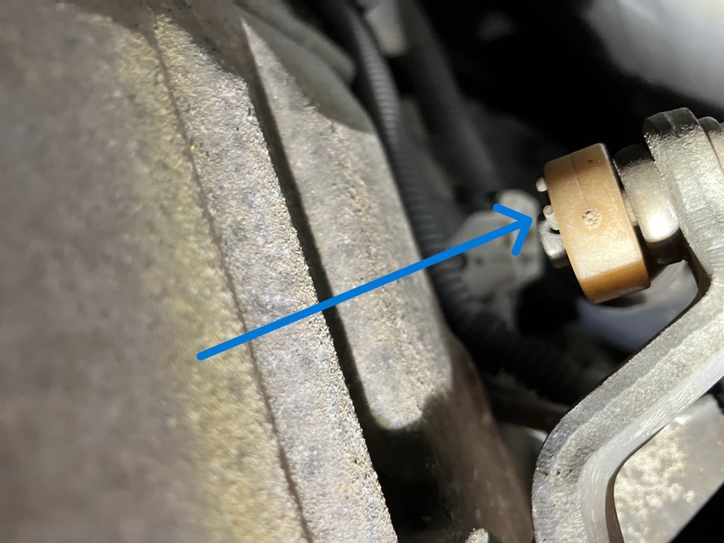

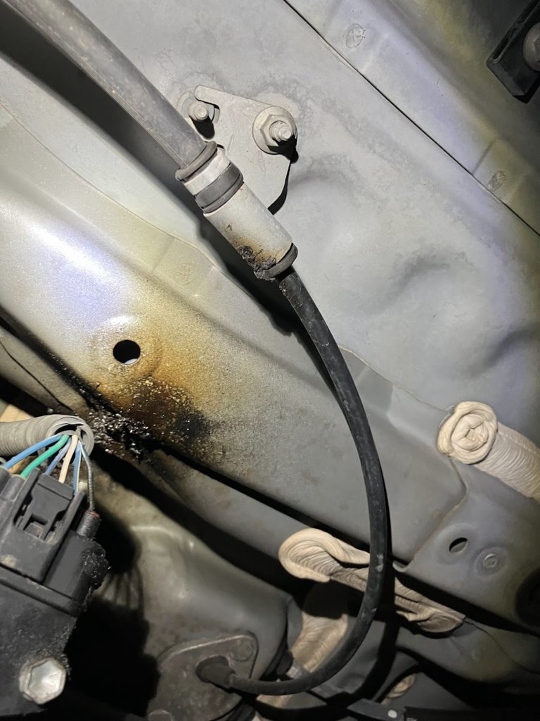

  16. Nov 13, 2024 at 4:28 PM
    #16
    TnShooter
    TnShooter The TacomaWorld Stray
    Sep 2, 2010
    #42625
    21,206
    Deogee
    07' TRD Off-Road, Auto
    STOCK
    Ok. Pics incoming.
    But I see no adjument.
    There is a cotter pin that holds the cable to the linkage.
    Are you sure it didn't fall out and the cable come loose?
  17. Nov 13, 2024 at 4:32 PM
    #17
    Tony79
    Tony79 [OP] Well-Known Member
    Nov 25, 2022
    #411560
    55
    Tacoma
    I'm not sure if the cable isn’t putting the truck in gear since mine doesn’t have the brackets yet. I’m putting the center console on a single-cab. Could probably be the reason that the cable isn’t putting the truck in gear.
  18. Nov 13, 2024 at 4:34 PM
    #18
    TnShooter
    Sep 2, 2010
    #42625
    21,206
    Deogee
    STOCK
    Is this cotter pin there?
    Linkage arm
  19. Nov 13, 2024 at 4:38 PM
    #19
    Tony79
    Nov 25, 2022
    #411560
    55
    Tacoma
    I have the pin on the shifter cable but don't have the shorter shifter lever and the bracket that holds the cable in place.
