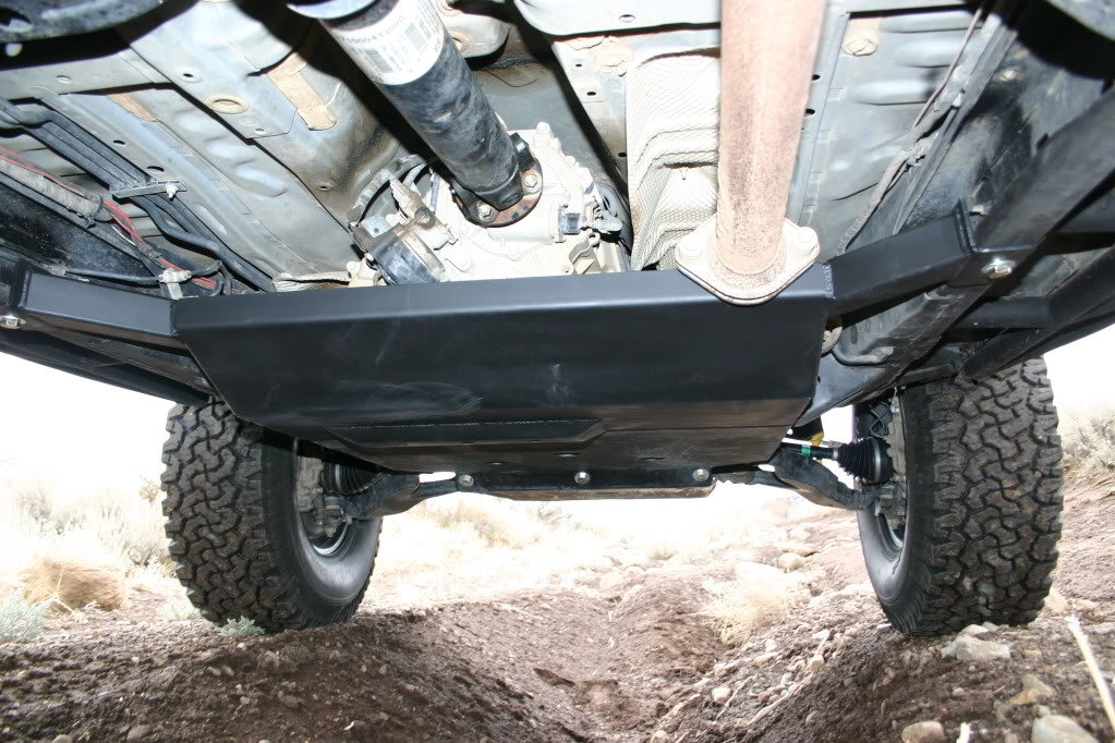

    My truck with relentless mid and t-case and the IFS I made myself.
    Forgot about Pelfrey but I'd still maintain Eric's covers more and is stronger. You'll pay tax too on Pelfrey's if you're a CA res, FWIW, which possibly negates shipping depending on how many skids you end up buying.

    Thanks for this pic & the info. I like how this t-case skid looks! This thread makes me lean even more towards Relentless.
