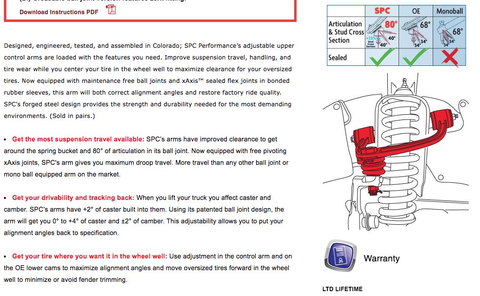

    Hmm, yeah. Your results may vary with the intermediate shaft replacement. I just know it didn't work for me. I'm starting to wonder if it's low-quality tie rods OR LCA bushings. I've had multiple alignments from various off road shops and nothing seems to fix the issue. I know the problem seemed to start with the combination of new/larger wheels & tires (285/70R17), new UCAs and new shocks.
    Just to verify. Is the issue you're having a wandering feeling needing constant input to maintain a straight line? I find that above 60 mph it needs almost constant correction and feels like a loose/floating feeling in the steering.
    Also just noticed this on SPC's website. The uniball is similar to stock UCA according to the chart. I wonder how that 80 degrees of articulation affects steering.
