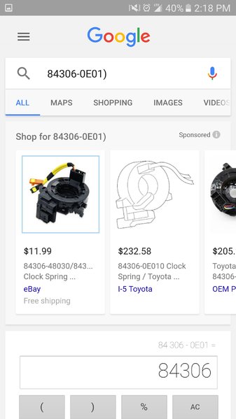

    you have to replace the spiral cable if you don't have steering wheel control for one w/controls

    Can you list all the things you need to get?

    With the spiral cable is that the airbag thing?
  18. Mar 10, 2017 at 12:20 PM
    #18
    desertrunner24
    desertrunner24 Well-Known Member
    Oct 30, 2016
    #201101
    3,954
    Jake
    Fresno , CA
    2011 TRD offroad 4x4
    Some
    that what your bag plugs into as well as controls and cruise control
