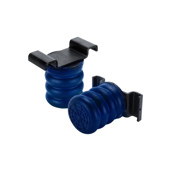

2nd gen sumo springs on 3rd gen

    SSR-611-40 is intended to be bolted to the frame upside down for 5-lugger spring-under-axle applications. If you attempt to mount it on the leaf pack in a spring-over-axle config, the threaded stud will interfere with the leaf spring center pin. It's also half the stiffness - 500 lb at 50% compression.
    The 2nd gen 6-lugger P/N is SSR-610-40, rated for 1000 lb at 50% compression.
    3rd gen P/N SSR-612-40 is rated for 1400 lb at 50% compression.
    Seems to me either SSR-610-40 or SSR-612-40 can mechanically fit (the install guides use the same photos), so your choice depends on the expected cargo weight.
