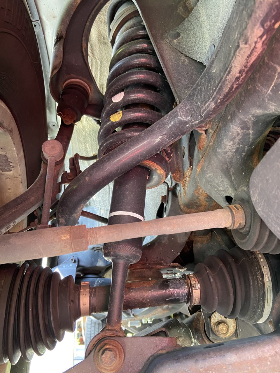

    I have a 2014 DCLB Limited with about 115k on it. I have a 2" spacer in front to level it. When I had tires mounted a while back the tech noticed the rear dampers are leaking. I'd like to swap all four corners for new but don't know if I should go exact OE, find takeoffs which are common, or upgrade to aftermarket. I'm wondering if the Limited model has specific shocks/struts or are they same as the base. I know they're not the yellow units found on TRD's. I ask because I actually like how the Limited rides (99.5% on road) and don't want to lose this nice ride. I assume most aftermarket suspension would create a stiffer ride because aftermarket is geared toward off road, right? There's also a Craigslist ad for 3rd gen Limited suspension (new takeoff with 10 miles swapped for a lift at the dealer) for cheap. Would these work?
    TLDNR: looking for suspension options for my Limited but don't want to screw up the ride.

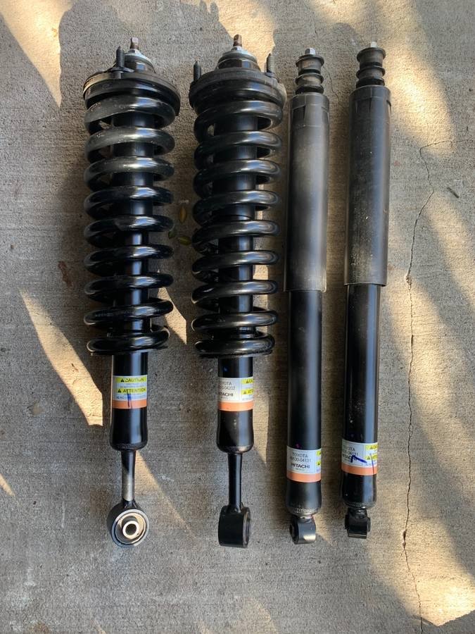

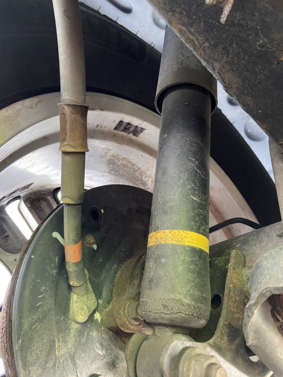

    the new take-offs I can get for cheap are:
    Front; Hitachi Mexico 48510-04202 (black dampers and springs)
    Rear; Hitachi Mexico 48530-04131 (black dampers)
    You guys have provided a lot of good info and I appreciate it but I'm a total Taco noob and lots of the part numbers and nomenclature mean nothing to me.

    No worries. Take a look under your truck. You should see part numbers and vendor markings on the existing units.
    Sammy4x4Taco[OP] likes this.

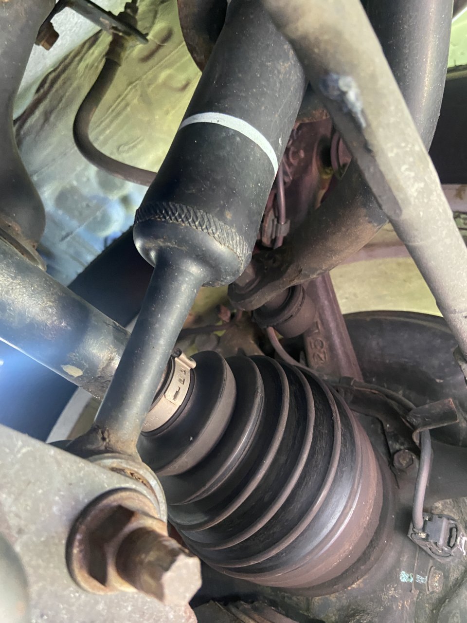

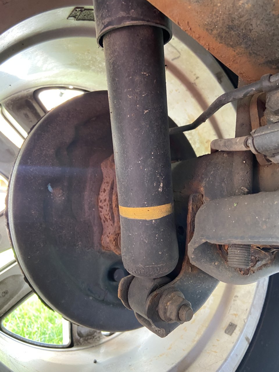

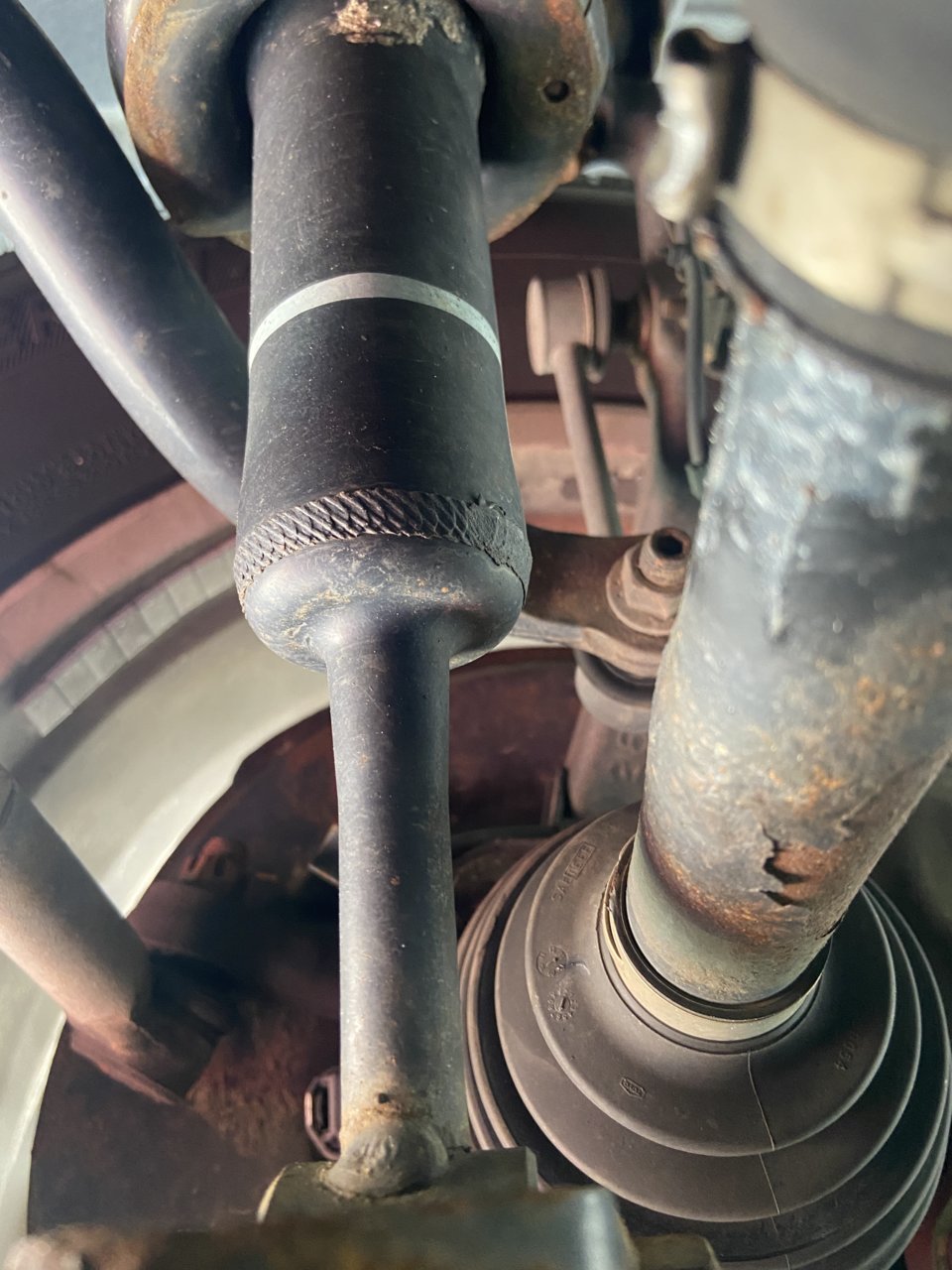

    So no numbers or writing. Just colored markings.
  13. Sep 3, 2021 at 9:49 AM

    The 3rd gen take-offs I'm considering are clearly marked.

    All of the struts/shocks are interchangeable. So, if the price is good, happiness.
