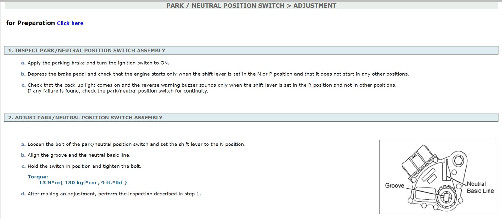

    The biggest issue you face is if the aftermarket switch will work to begin with.
    If it works, it will likely work for a long time.
    But the reality is, there is a good chance it wont work straight out of the box. :rofl:
    100% you need to pull the switch and see if the connector is wet, or has corroded pins.
    The sensor connector has been known to leak around the seal. CHECK THIS FIRST.
    No need to stick a new sensor in it if the pins are "bad" (corroded)
    Also, it would be a good idea to put dielectric grease on the rubber seal of the connector when you plug it back in.
    Do NOT put it on the pin. ONLY THE SEAL.
    When removing the senor. DO NOT reef on it too hard.
    There is a seal behind the sensor that the rod goes through. (the rod is what the nut screws onto - See picture below)
    If you damage the seal, it WILL leak. You don't want to have to replace that seal.
    It has to be removed and installed from INSIDE the transmission. You don't want a simple job turning into a a complicated disaster.
    Cut the nut off with a Dremel if you have too. (seriously)
    Also, Make sure you get the sensor aligned correctly.
    The Sensor and "Nut"
