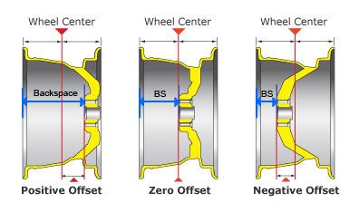

    the higher the number the more it sucks in the wheel well.
    The second gens have a wider stance so the suspension sticks out further, a flatter faced wheel is used.
    Rule is the lower the back space and offset the wider the wheel will sit.

  11. Aug 4, 2015 at 2:37 PM
    Brice
    Brice [OP] Turbo Member
    May 28, 2015
    #156265
    2,304
    Brice
    Texas
    1999 Tacoma PreRunner V6 SR5
    Wastegate assisted turbo delete
    Thanks for the graph...looks like ill need a 1.25 spacer?

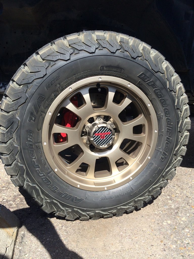

    Thats what I have, I am running a 4.5 back spacing though.
    06+ Tundra 231mm brake kit.
    17x8.5 wheel with -6 offset, I still rub frame at full lock with articulation.
    4A150DEF-6178-4055-9A9B-79ECC999E687_zps_dba9d278b82b6ed1d4f5ce451e98b00a64c591f6.jpg
    464DB10F-19E0-40ED-8D53-547B9F7C9E72_zps_e00381d242f681145d03202e35fb6b785adb1659.jpg
    12TRDTacoma likes this.

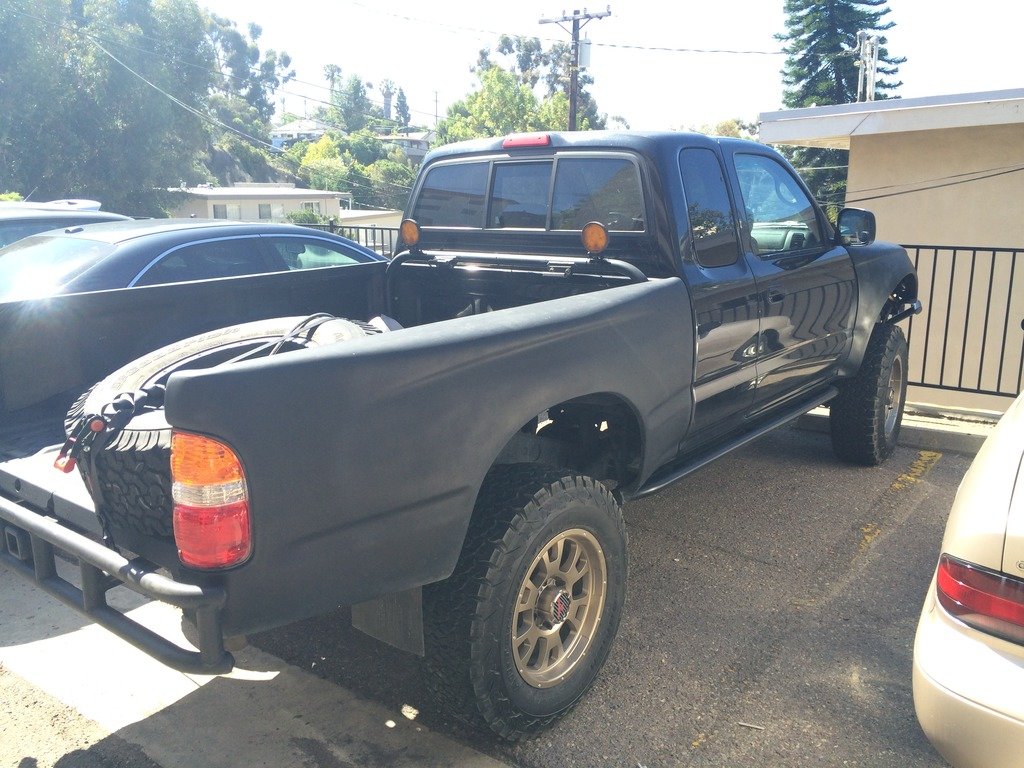

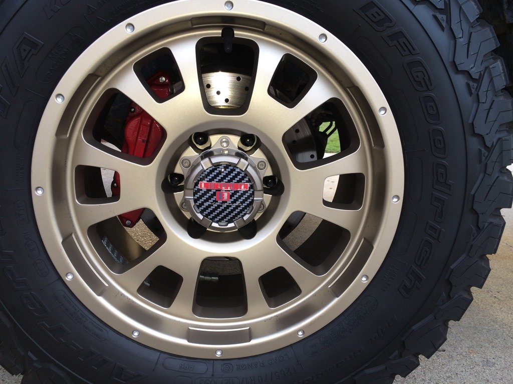

    I dont run spacers and this is how it sits.
    48BAAF94-190E-46FA-B1EC-7BB9EC1E9A0D_zps_b54cbf8758db1b847ec1c1fd23d66cf1b53e0896.jpg
    4699EF4C-ED84-4BFF-BE89-BE5AF93159A8_zps_4b4c8041c9f824fa3f6d20253d472b51bb9a74a8.jpg
