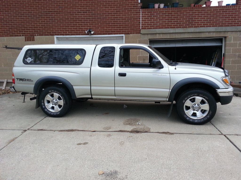

    the 231mm were used for the heavier Tundra double cab that usually came with 17" wheels. 16" still fit but as elmo said minimal clearance.
    the 199 were standard due to the v8.
    also the stock TRD wheels are 16x7 (not sure where 16x8 came from)
    and here ya go, with stock tires you will have no issues. 265/70-17 will rub at full lock but will fit (same as 265/75-16) depending on tire manufac/model:
