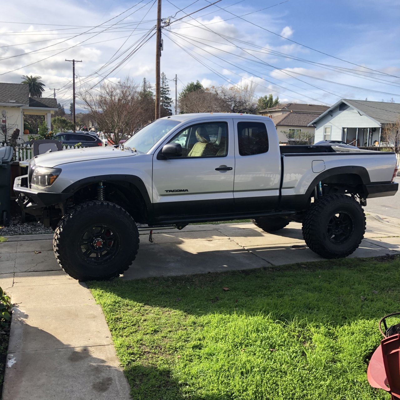

    I figured I’d make a thread for the process of my 3 link solid axle build. Here it is as of today. I started to break it down. This will probably take me till the end of the year to get it back together at least with work and family life.
    C26ACDF5-FD3A-42D9-8D92-0C18DA90E042.jpg.
    -2011 4.0 V6 Auto access cab 4x4
    130”wb moved 2.5” forward
    71”wms
    Wheels and tires:
    -37”x12.5”x17 Pro Comp Xtreme M/T2
    -17x8 Pro Comp alloy 4.5" backspace
    Suspension:
    -Front:71” wms ruffstuff housing and 3link high pinion fj80 ARB locker
    -Rear: Chevy 63" leaf springs
    -Ruff stuff 63 swap kit
    -All pro Ubolt flip kit with bump stop
    -King 14”
    -extended brake lines,
    -extended ABS sensor tab
    -trail gear weld on bump stop extension
    Drive train:
    - Yukon 5.29 ring&pinion
    - ARB Lockers
    Armor:
    -ArmorTech Offroad high clearance bumper
    -4x innovations sliders with kick outs
    -rear diff protection by Comersons toy
    -CBI Dakar front bumper
    -warn m8000 winch w/ synthetic rope
    Exterior:
    -2" cut out of rear fender
    -3" cut out of front fender
    -cab mount chop

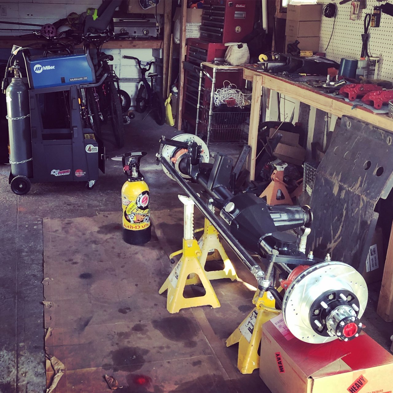

    I Bought this axle from a now friend who I met on the rubicon. Picked it up Jan 1st this year and tore it down and put new races seals bearings and all hardware and repainted the housing and knuckles. It’s looking fresh and ready.

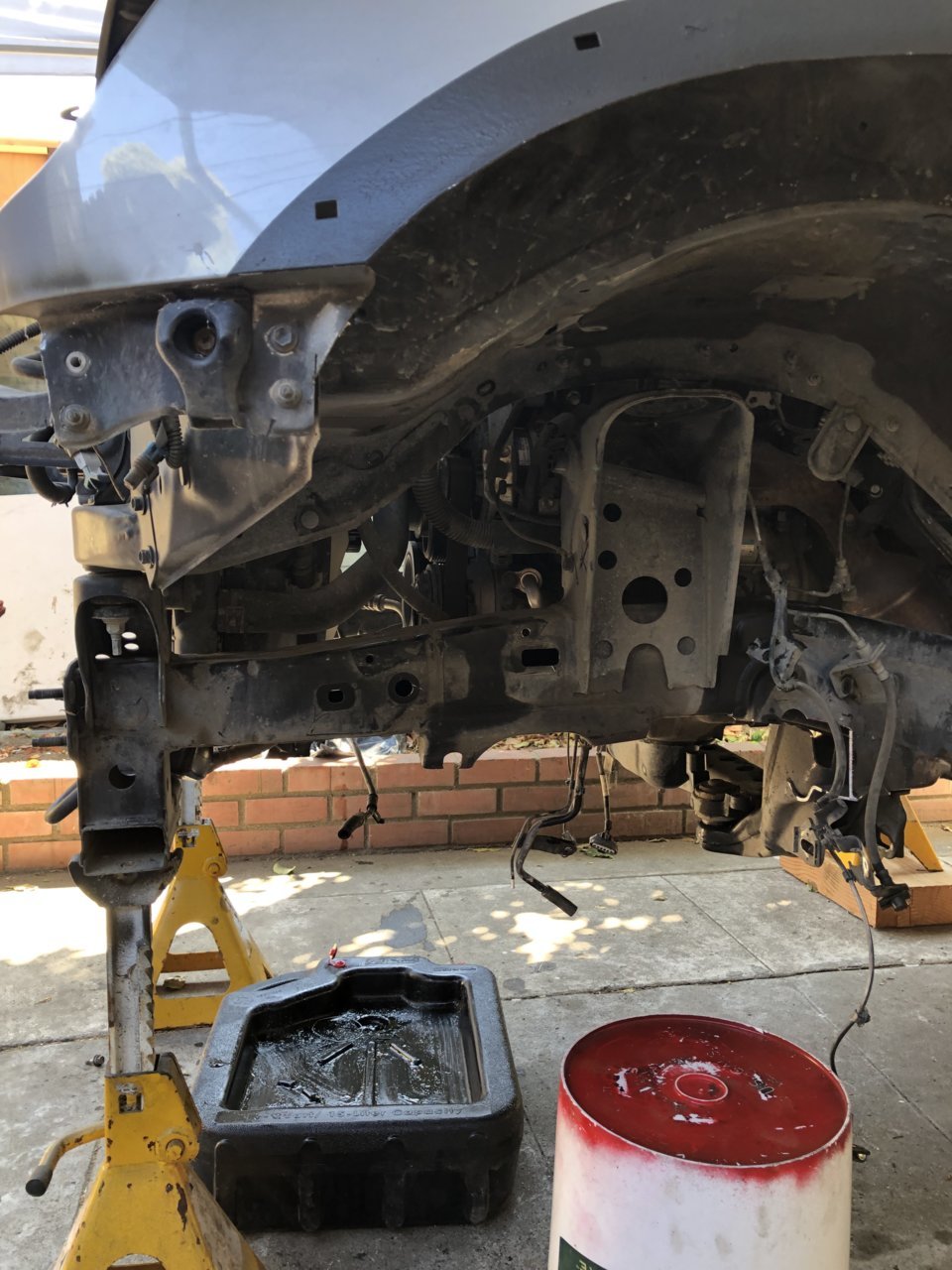

    I pulled all of the IFS components off the truck today and picked up fresh 37” procomp mt2s I was planning to use my new plasma cutter to cut off the cross members but I used a sawzall on the first one and it was like butter. No biggie. I’m going to keep with that. My next stage will be to clean up the frame and prep in for the frame plates.

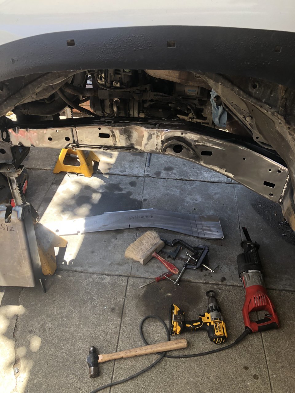

    Got all the IFS out. I still have prob 5-6 hrs of detail on the frame rails before I burn on the WFO frame plates.

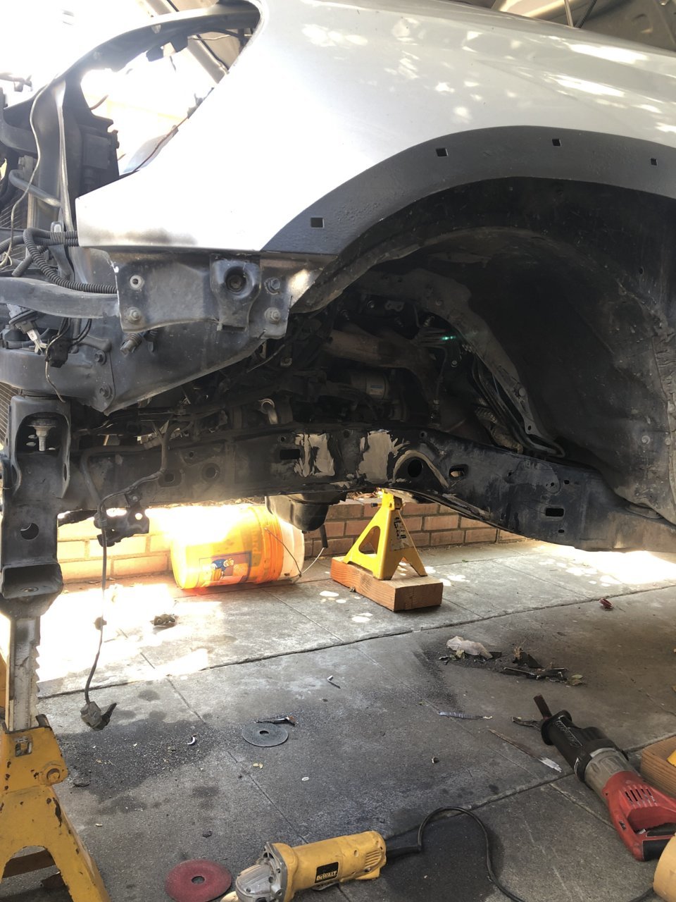

    I threw the shock towers in the wheel well On top of the frame to see roughly how much I will need to cut and realized I’m goin to have to remount the battery and fuse box on the drivers side. Passenger side is clear. E3EBDAFE-D633-4D4E-8931-20BEBB1D336A.jpg 101EED4A-8673-4209-A169-AE4C4902F90B.jpg

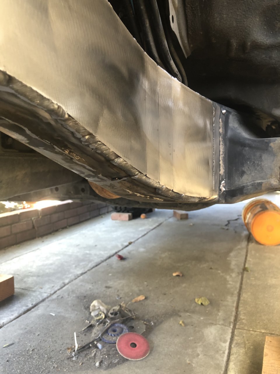

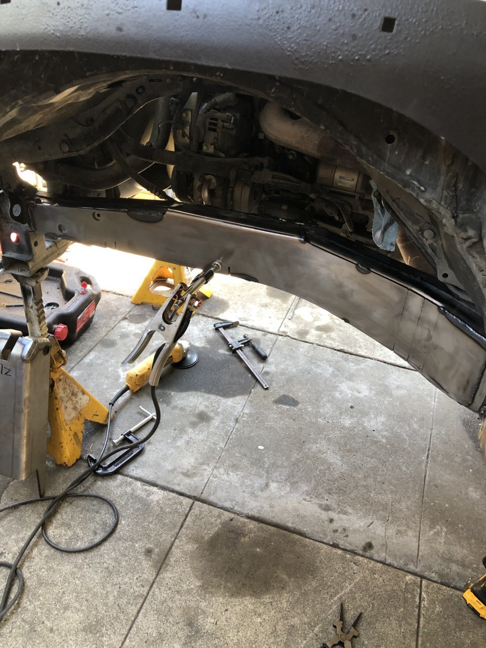

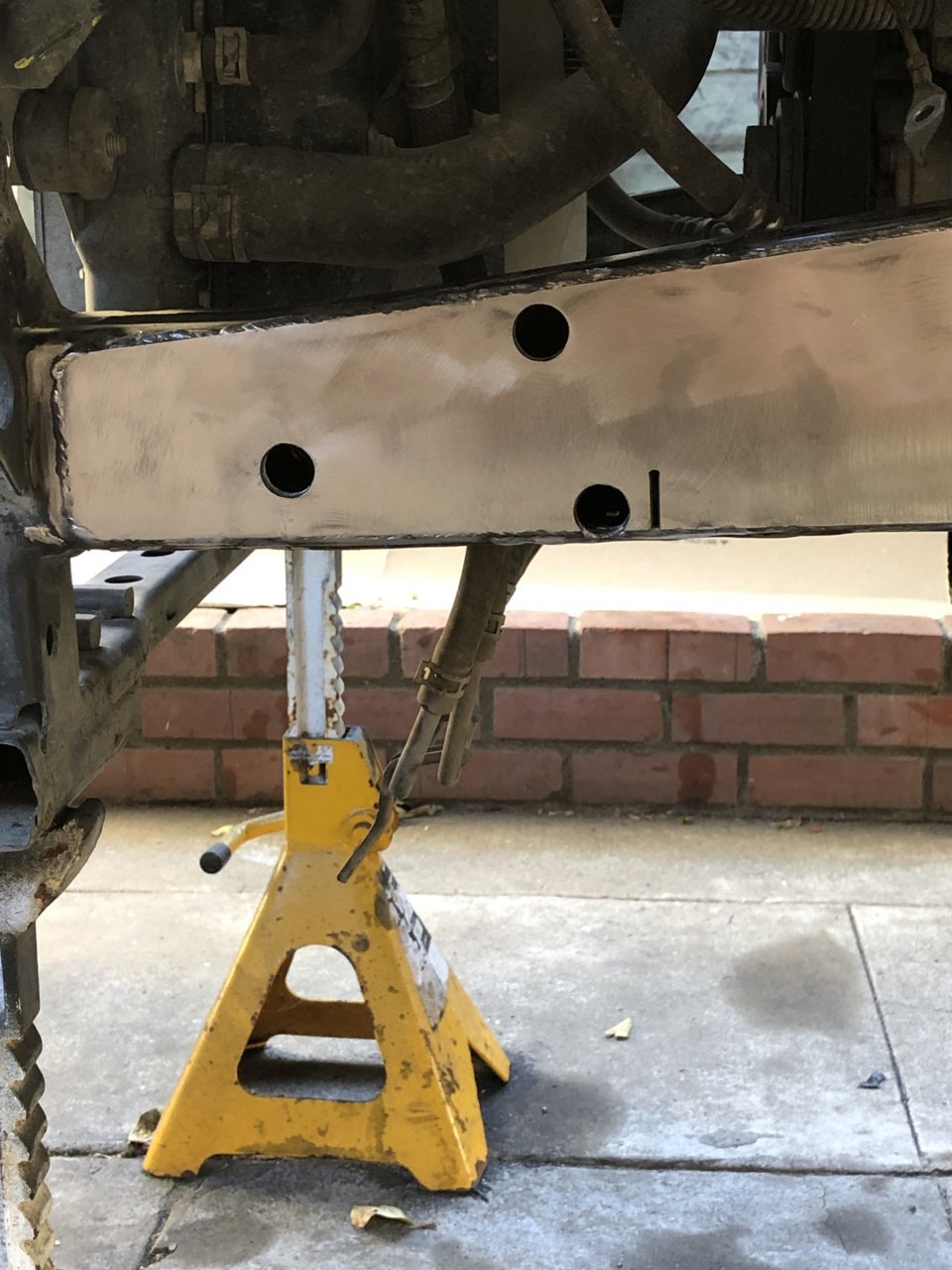

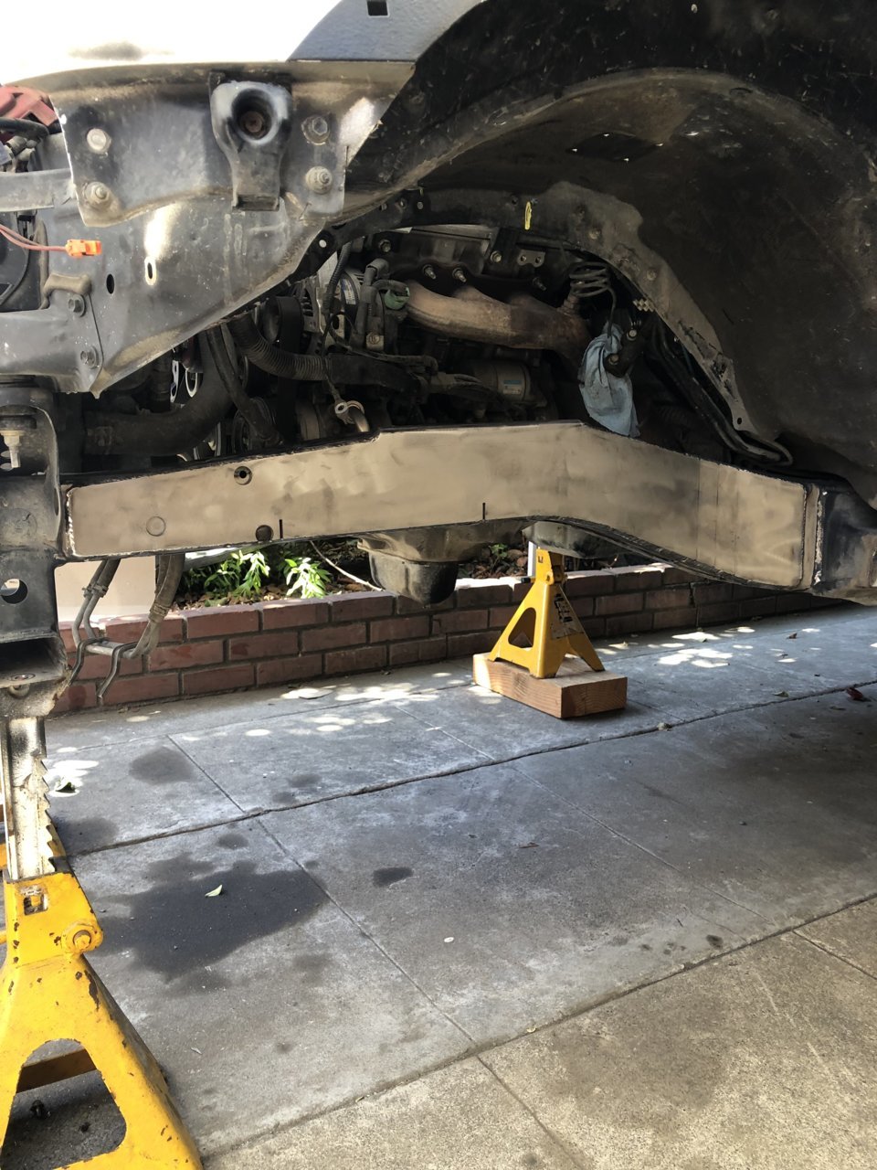

    3 link solid axle 2011 Tacoma 4x4

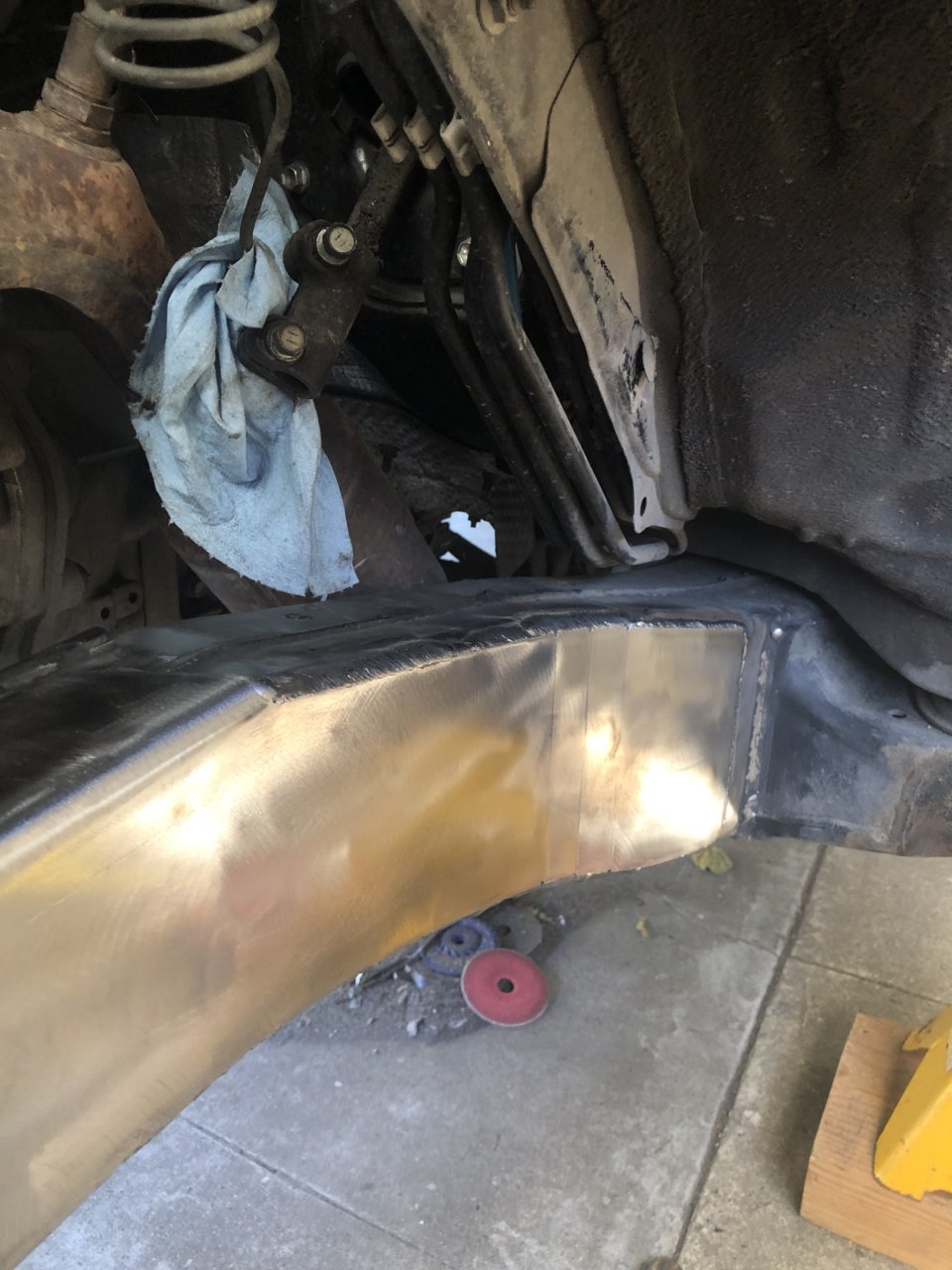

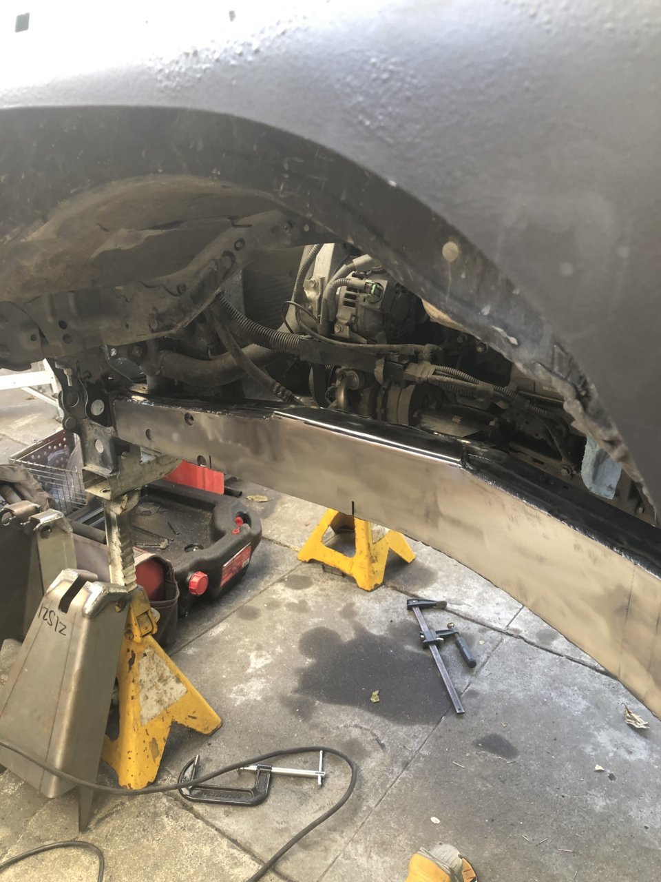

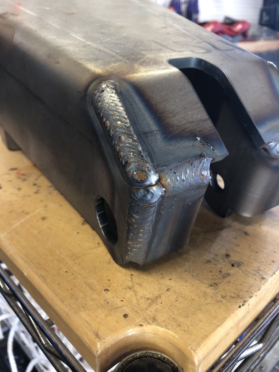

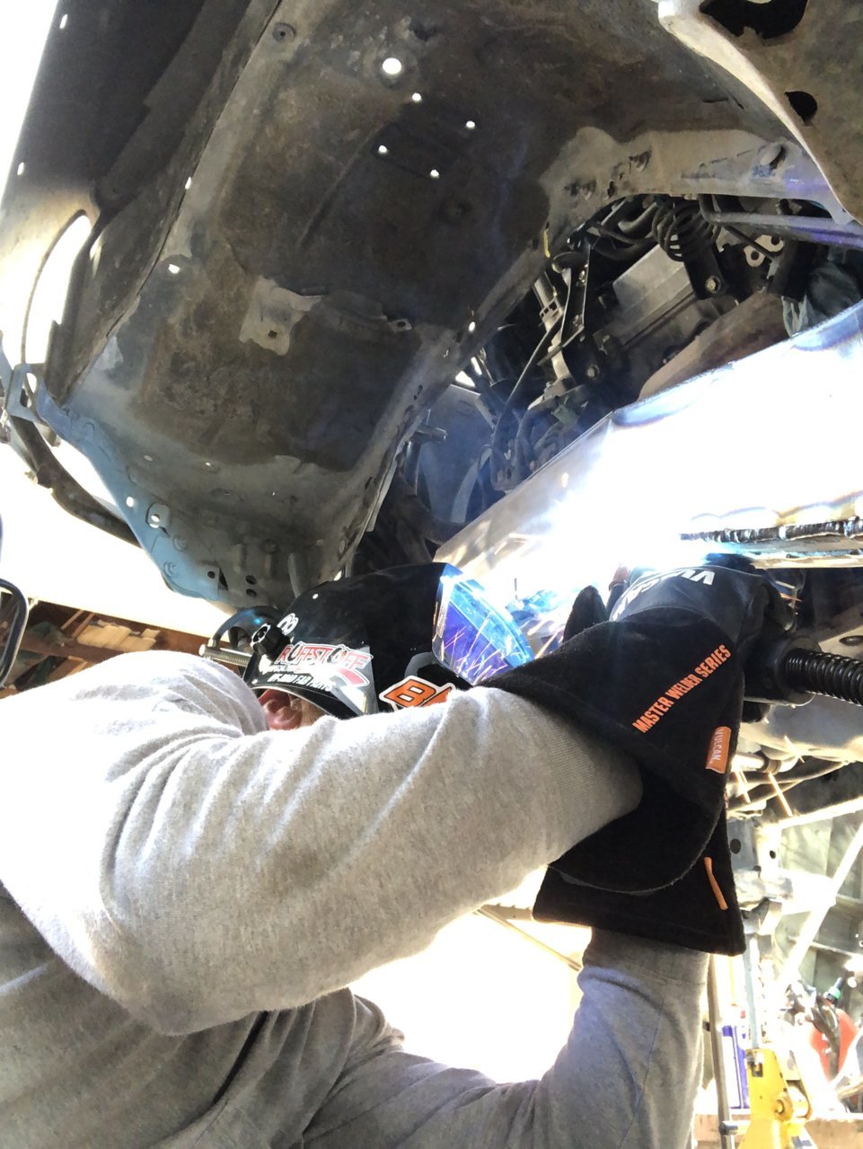

    I got the drivers side frame plate welded on. I am learning a bunch about welding.... Horizontal, flat ,overhead gapped etc. every weld angle needs a different voltage wfs and pull or push angle. Very different than brackets on a table. Fun stuff. I’ll probably get these on and then slide the axle under the front to start to mock up link arms.

  17. Aug 16, 2019 at 9:55 AM

    welding overhead sucks :rofl:, but it is definitely different than just welding on a table.

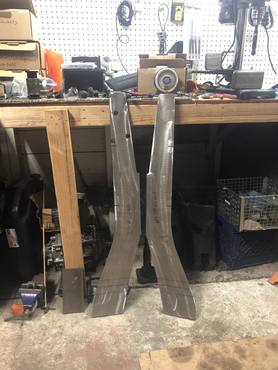

    F051FD20-F2D1-4488-8912-AE5467F9D1AC.jpg 76E6E772-9E05-4CE4-9715-B78904B7A340.jpg 132982CE-F84C-4AE3-B308-7BC6FFE38D44.jpgE35A7012-54C4-48B4-97EF-FD61D5DB77B4.jpgEBBE35D3-0FBB-4585-AC83-6065E9D03E2B.jpgF051FD20-F2D1-4488-8912-AE5467F9D1AC.jpg76E6E772-9E05-4CE4-9715-B78904B7A340.jpg132982CE-F84C-4AE3-B308-7BC6FFE38D44.jpg
