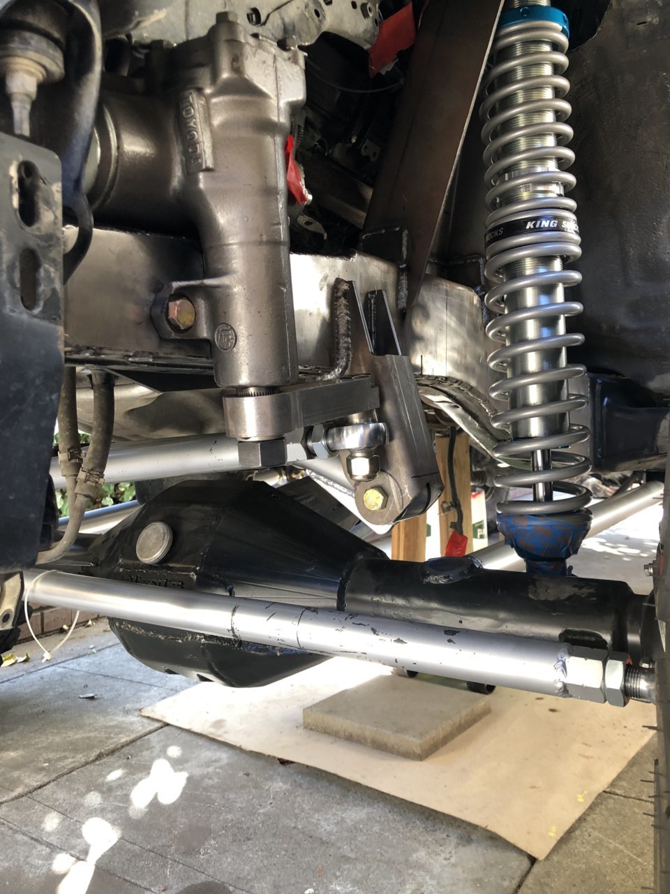

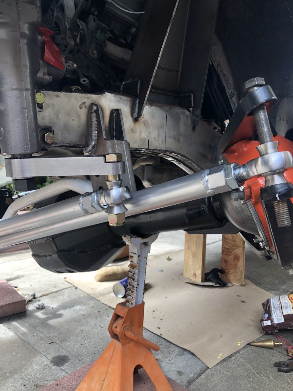

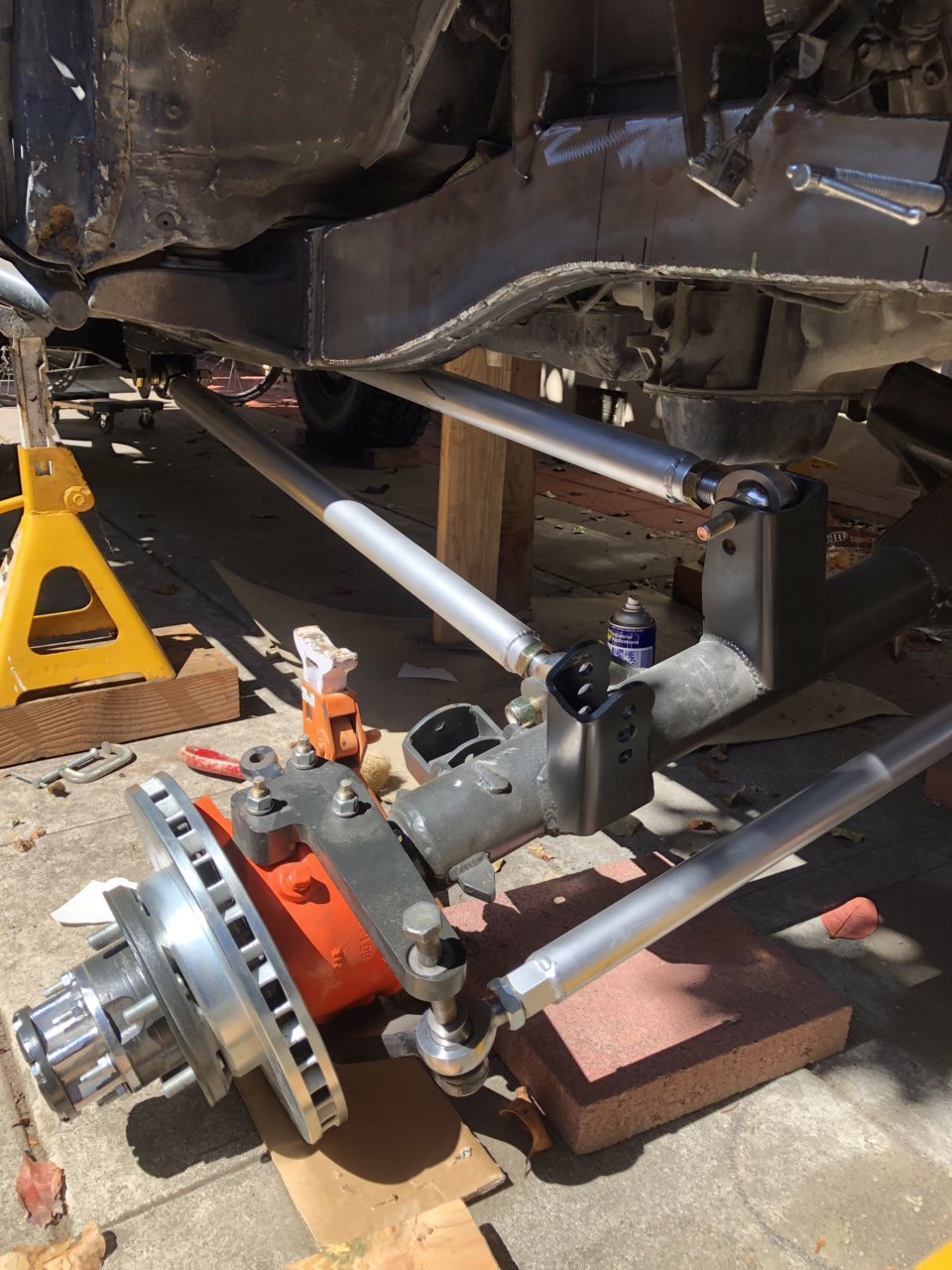

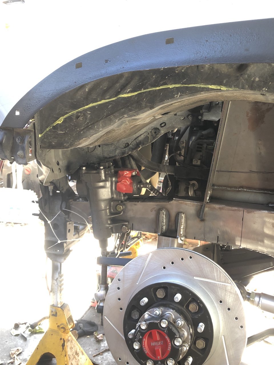

    021A69C7-A741-46CE-BE3B-7AEBA0FD2C29.jpgOoooh how sic are these.
    2C858DAE-3B37-414F-8AF7-24C5E2D4D032.jpgTesting for binding. Still can drop 2” on passenger side

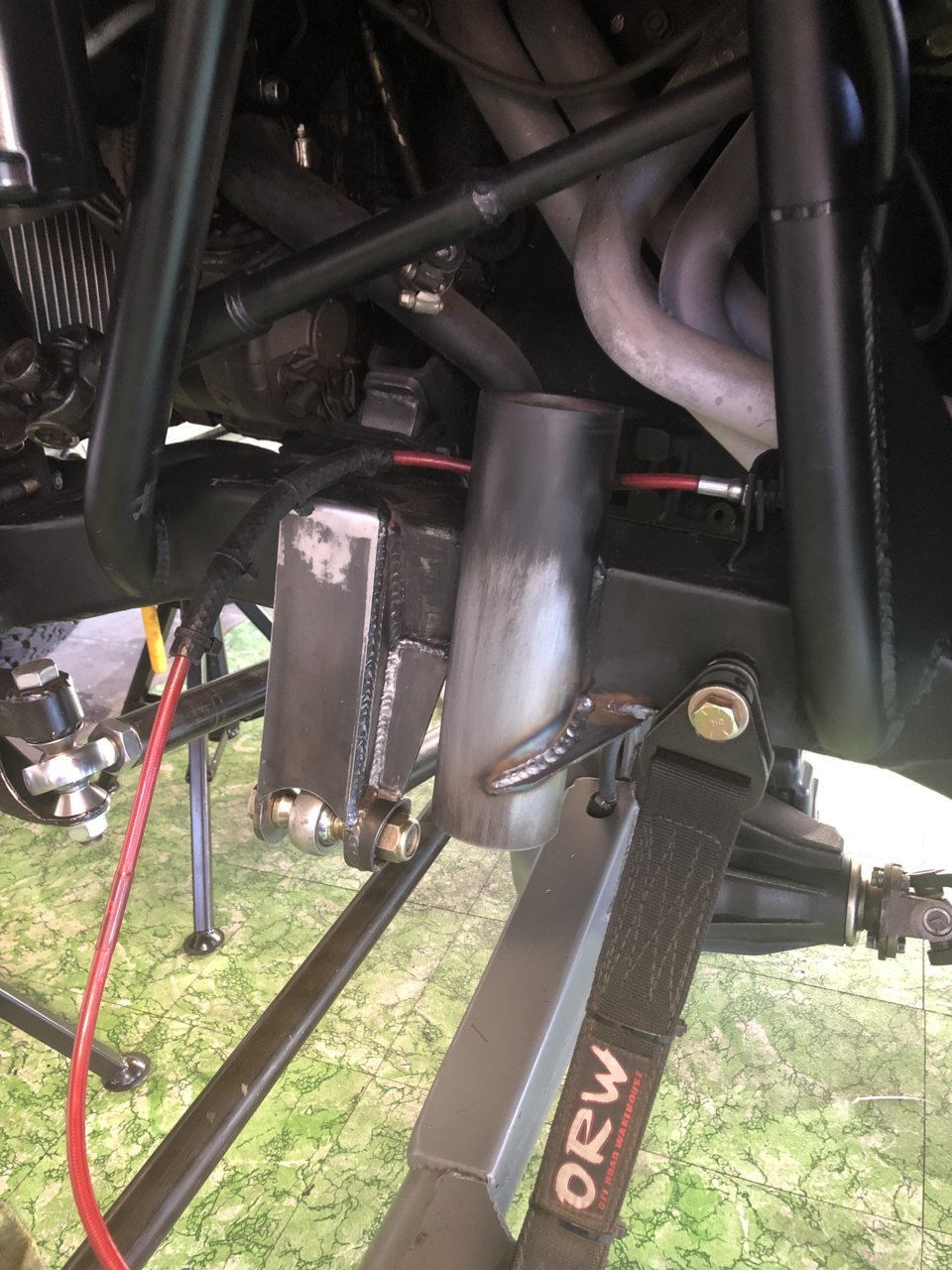

    DDAD1D33-931A-4653-8A00-D1EF060128B4.jpgPanhard mount is very cozy up there
    A729CF3E-8114-4E8D-82ED-D6A3CCDAB9D1.jpgUpper link just barely brushes the frame. If it is an issue I will drop the link 1 hole.

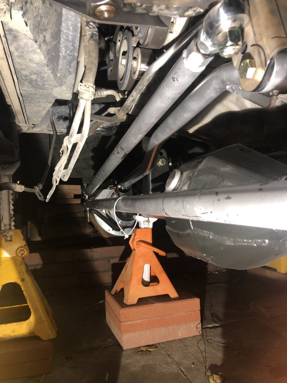

    3 link solid axle 2011 Tacoma 4x4

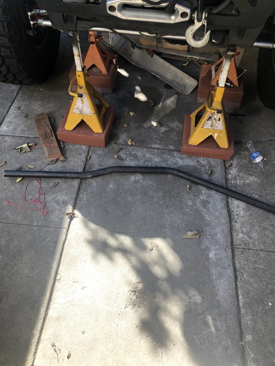

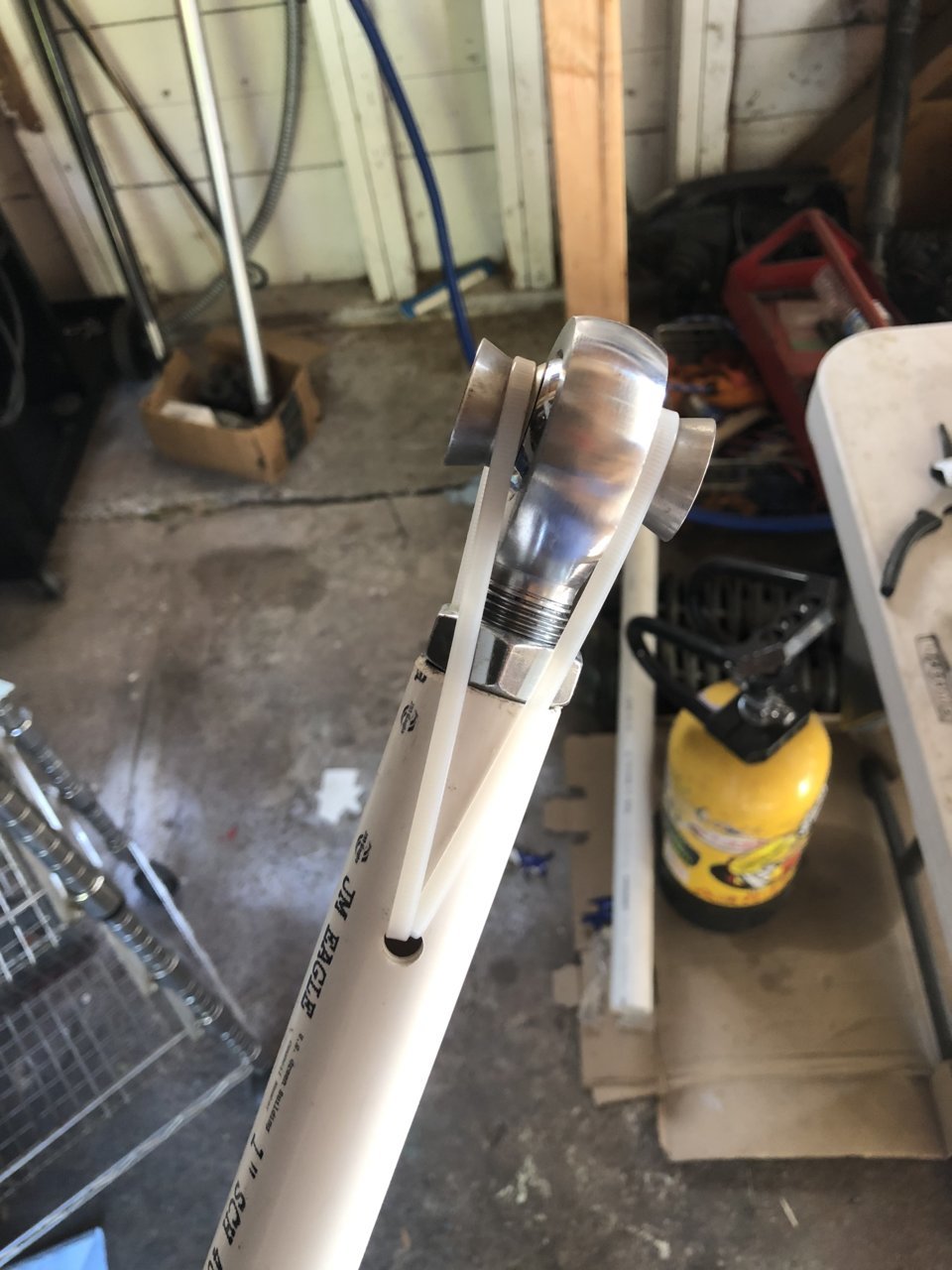

    Heated and bent a piece of pvc to mock up a panhard link
    2591E954-9E9F-4E8D-918C-FCA29AFE8EEE.jpg DB34D93E-129C-438A-B13E-B30D9EA3E3E2.jpg

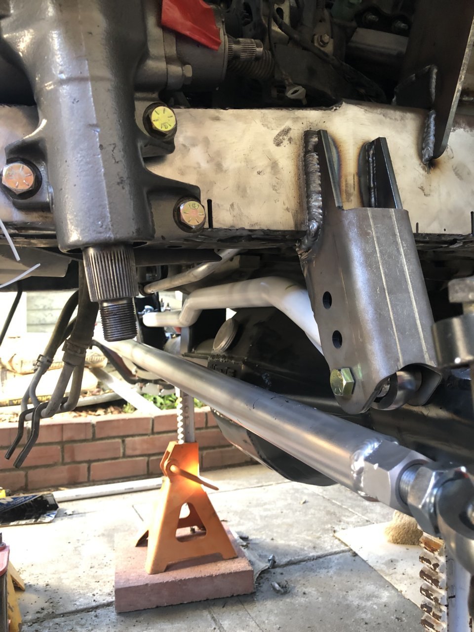

    :annoyed::facepalm:Drag link is in the fucking way of the tie rod. I need to shave 3 misalignment fittings cut the bolt shorter and HOPEFULLY that will take care of things. It should buy me about 1.5” I don’t want to raise the ride height at all if I can help it...

    From my experience I would double shear the pitman arm and the panhard needs way more reinforcement... it will tear off the frame if you beat on it

    I don’t understand how you don’t have room to double shear the pitman?

    Sunnyvale California

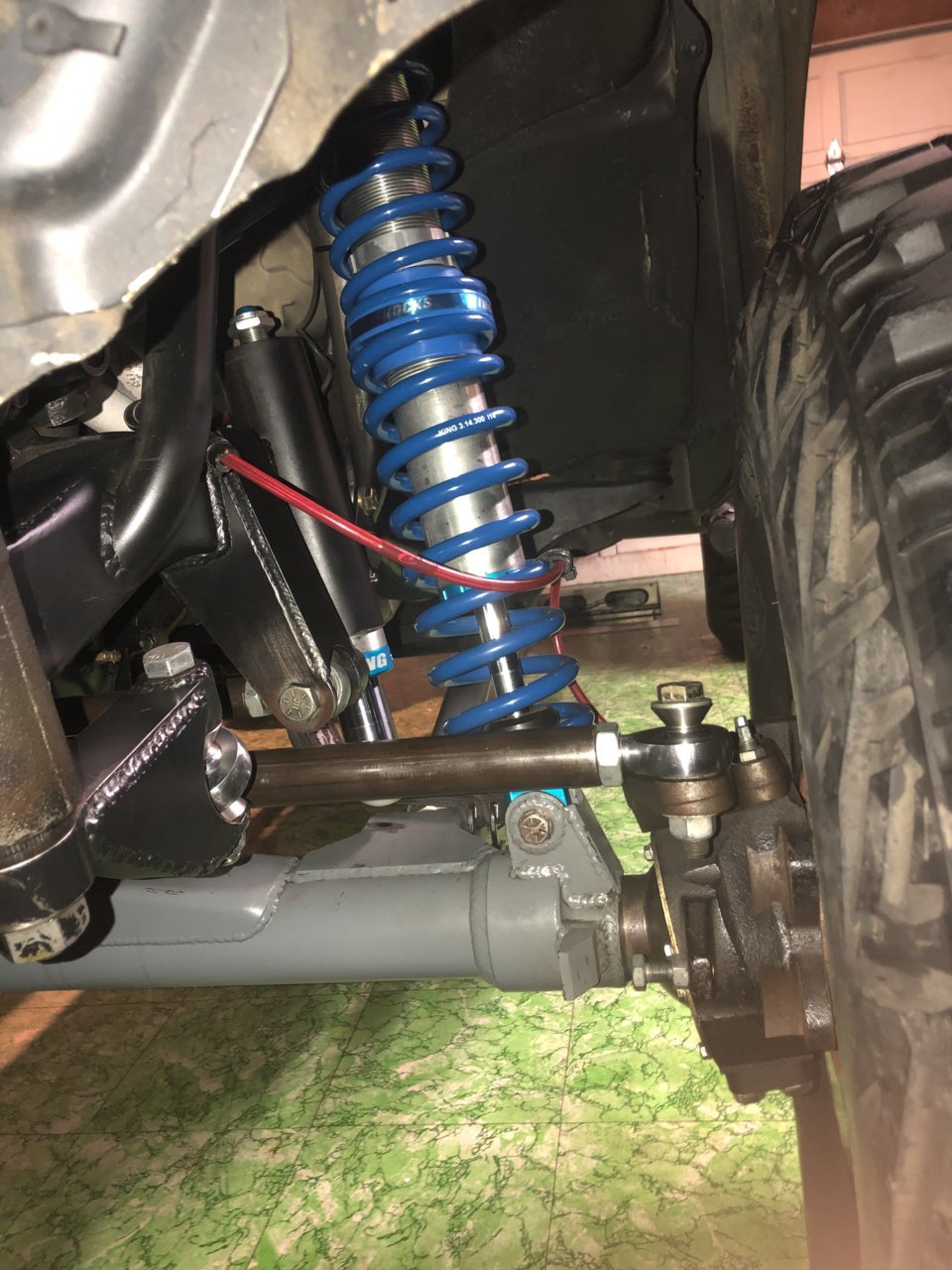

    With Driver full bump and pass full droop I am very limited on clearance at the drag link bolt misalignments and nut being able to clear my tie rod. When turning from driver to passenger. I already cut down my misalignment fittings and bolt so things pass. It is tight on space. I can easily address it later if it looks like there will be room.
  12. Sep 23, 2019 at 9:48 AM
    #72
    Pdugan6
    Pdugan6 [OP] Well-Known Member
    Aug 11, 2013
    #110271
    1,489
    Patrick
    The Slee off-road steering arms are very long and that is the main reason for passing issues with the tie rod.

    Gotcha, my tie rod clears the head of the panhard bolt by 1/4” at its tightest spot

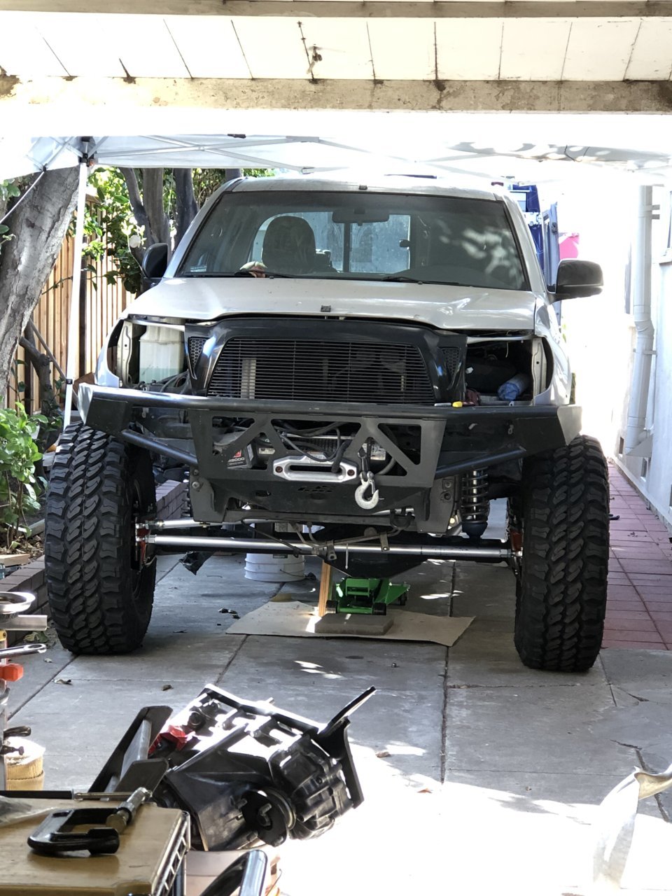

    Im off to go get my panhard bar bent up so I can finally put the vehicle on its own weight. :bananadance:

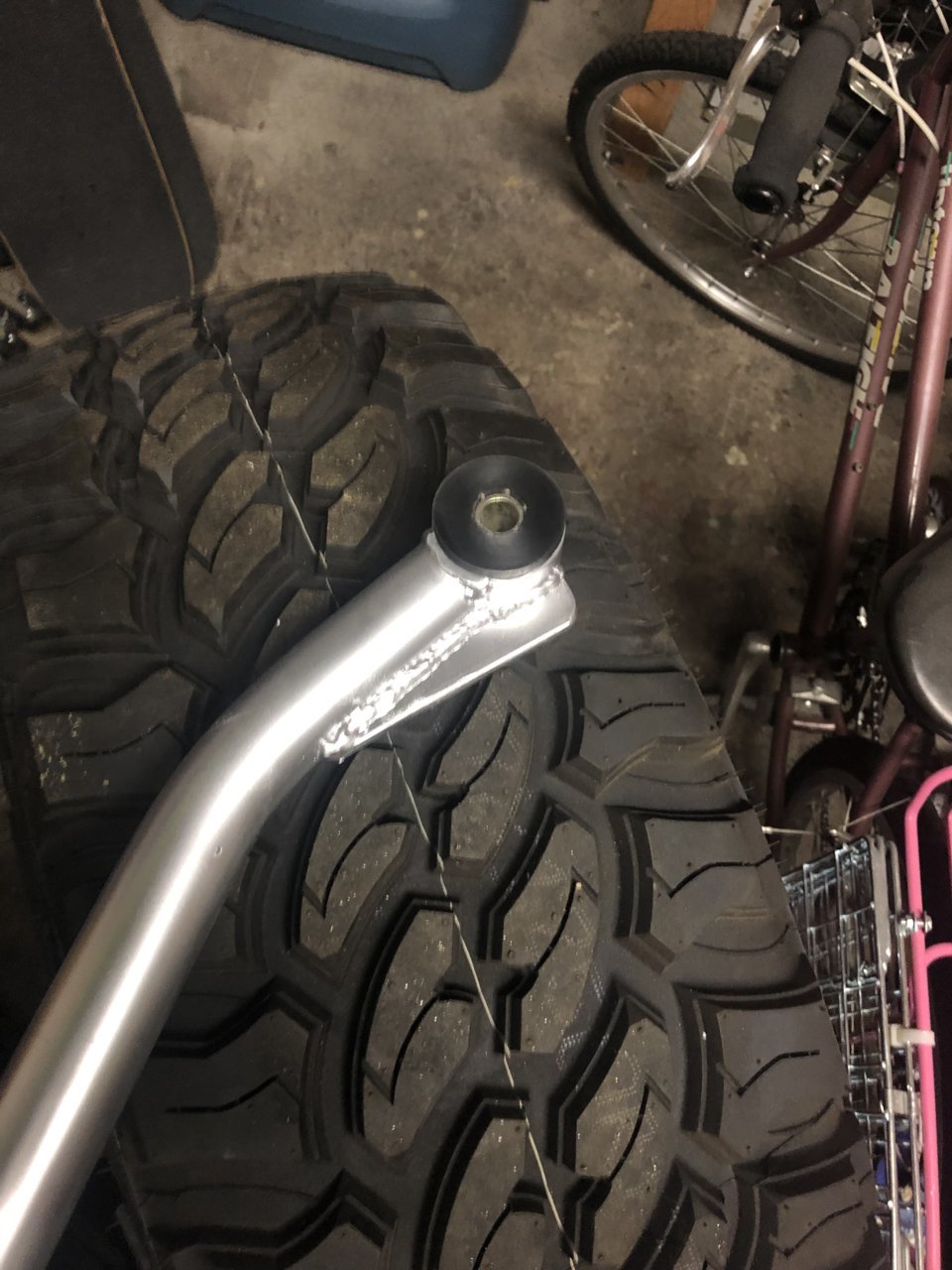

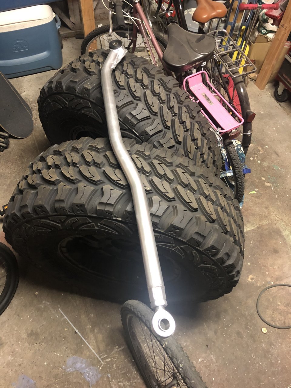

    What wall thickness tube are you using?
    I would also suggest using “mohawk” gussets in the bent sections

    .25” I will def do some Mohawk gussets.

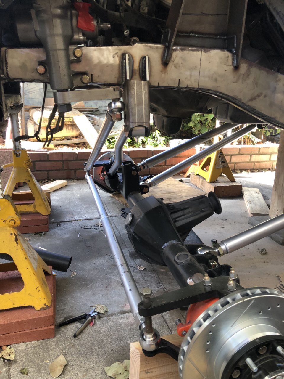

    I need to cut the track bar and weld on the ends and gussets.
    tgelata and Anderson like this.
  18. Sep 27, 2019 at 8:39 PM
    #78
    Pdugan6
    Aug 11, 2013
    #110271
    1,489
    Patrick

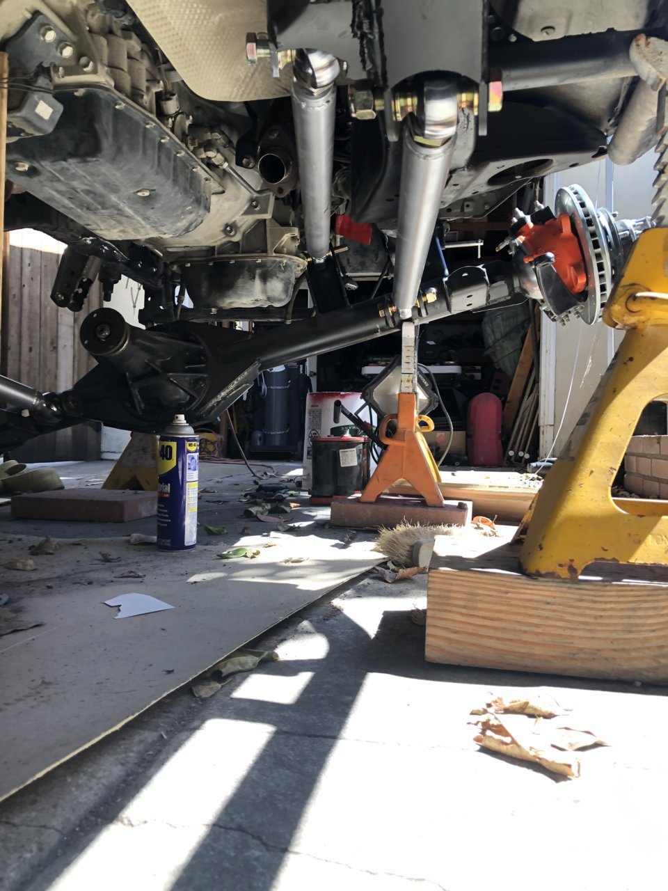

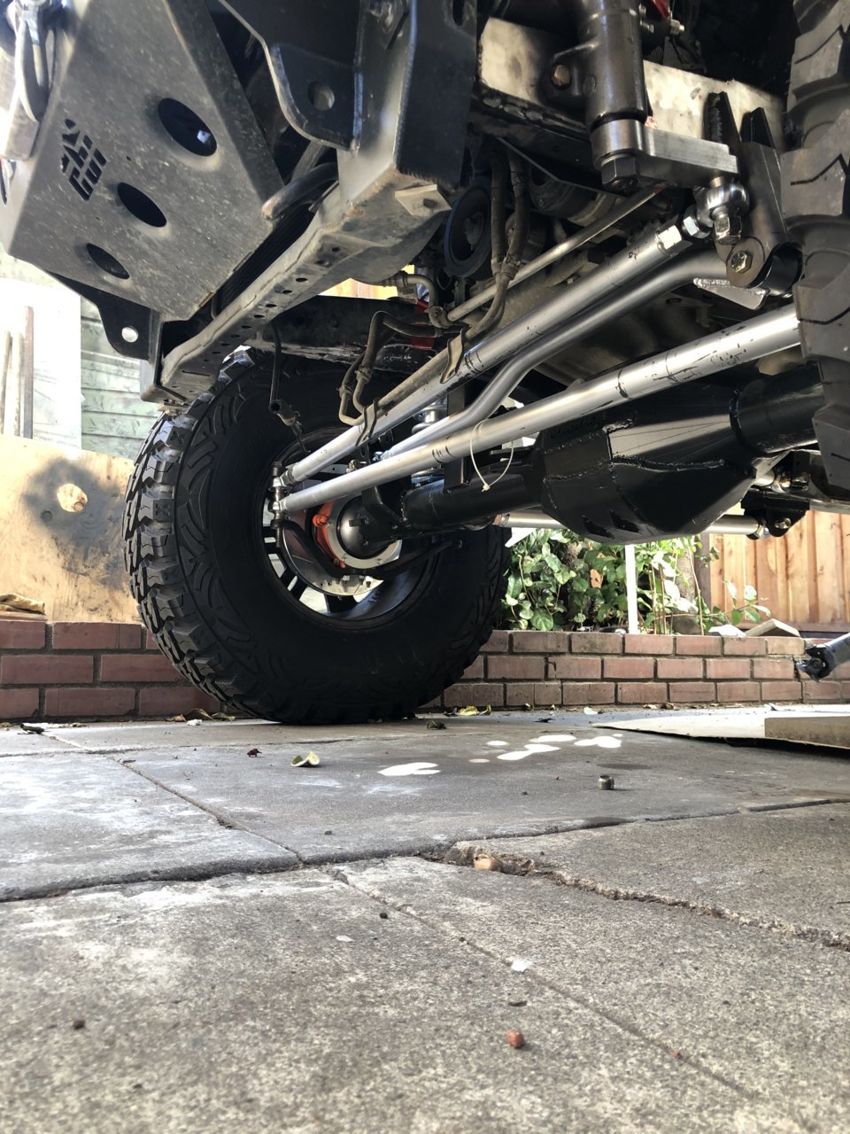

    Finished my track bar. It turned out well. I took my template to Arabia’s off-road in Campbell and Jeff bent it up great. I used a ruffstuff specialties bushing and sleeve for the frame side mount and ruffstuff 7/8 heim at the axle side.
    E2B75990-9572-40FC-A5C3-69E6D5C9BC54.jpg C10B860E-83D8-4A13-990C-A05F66DF81CA.jpg 33833E58-DC51-4533-8D68-E35229AC34BF.jpg
  19. Sep 28, 2019 at 8:01 PM
    #79
    Pdugan6
    Aug 11, 2013
    #110271
    1,489
    Patrick
    Put it on its own weight for the first time today. Looks good. Need to adjust the springs still. Right now I’m 3” up travel with frame at 22” I will take note and then concentrate on getting the t-case and crossmember in. Still lots to do but getting closer.

    Looks really good! You should be proud!!
