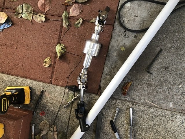

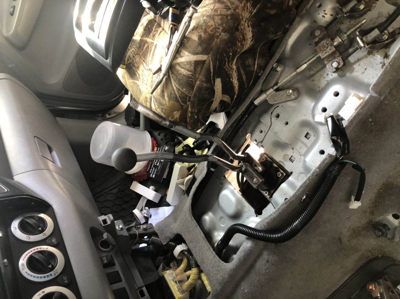

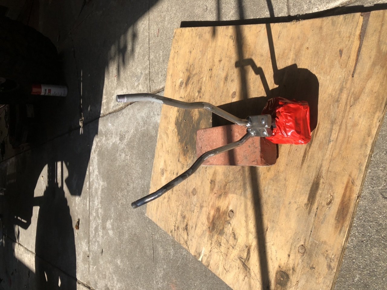

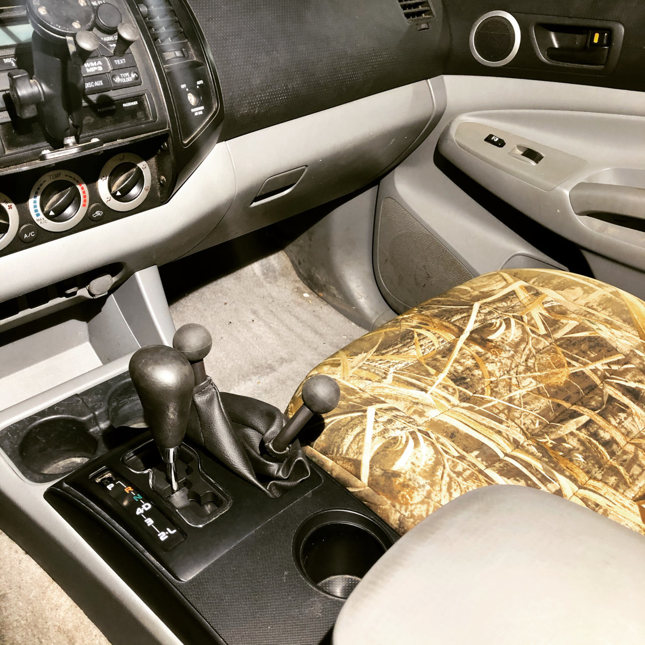

    Good progress on the sticks. Got it figured out and all welded up. I am waiting on some shrink wrap for them and then I’ll get the center console back together. 5B179FA8-F2CA-4FA1-8230-69E21A524ADC.jpg 0B5FF9DE-7F0B-4C86-B585-544DDBA2AD5C.jpg E4DE4516-0D17-466C-AC99-A20A1483A387.jpg

    Super pumped on the finished product with the twin stick install. I have a vid on my insta. #thehunterandhunted. D74F6AFE-6F15-4F42-B4D6-4442E70260B3.jpg

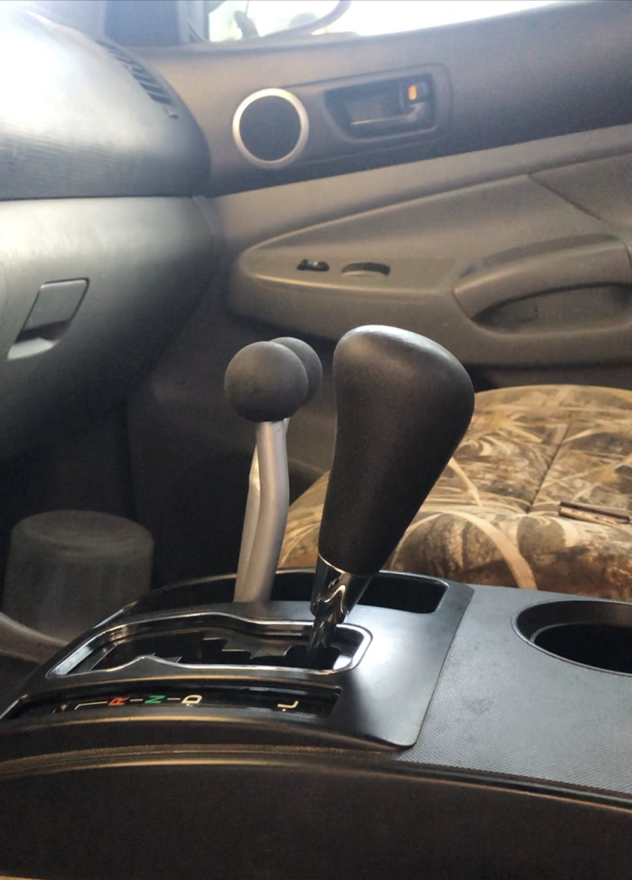

    EDEC4001-2E35-4710-B2B1-C00B8A054D05.jpg Pic with console back together and I put black heat shrink wrap over the sticks and pleather boot in place. :oldglory::woot:

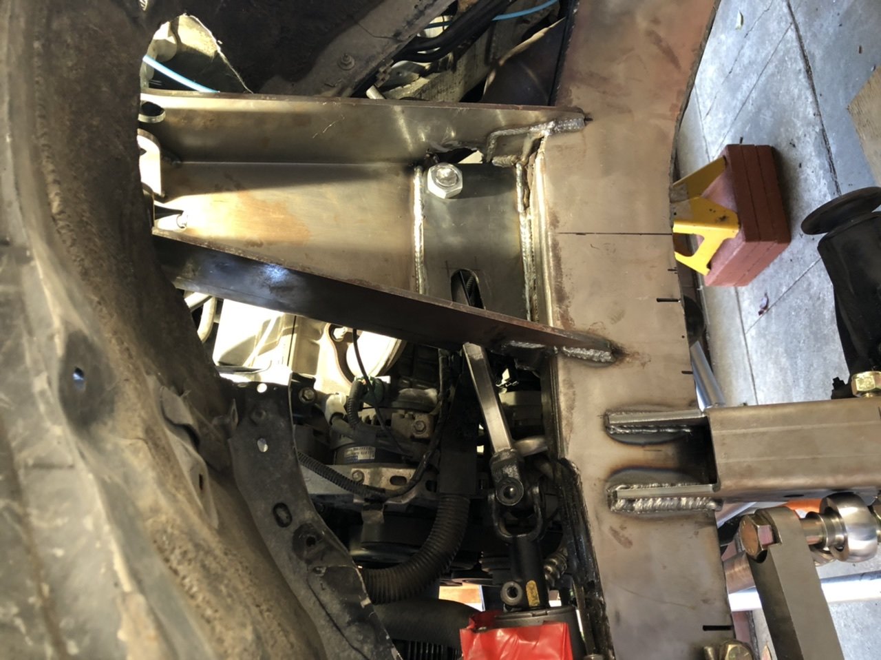

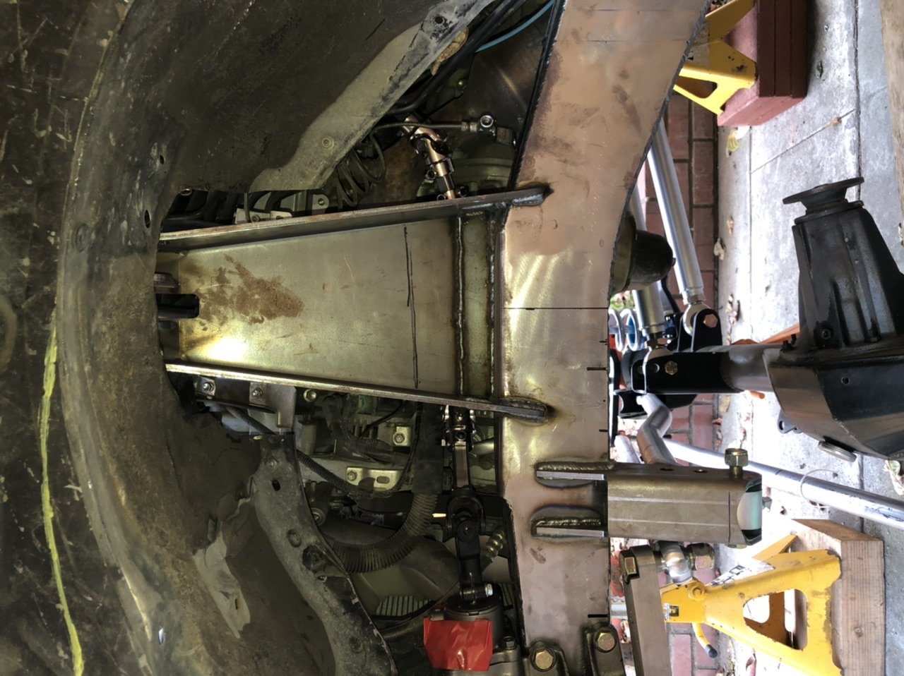

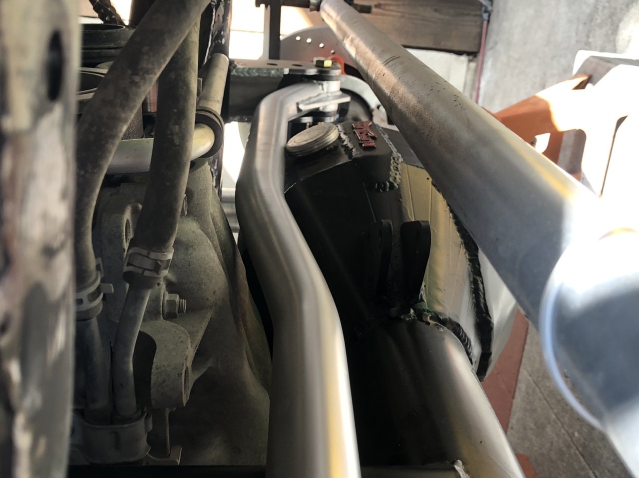

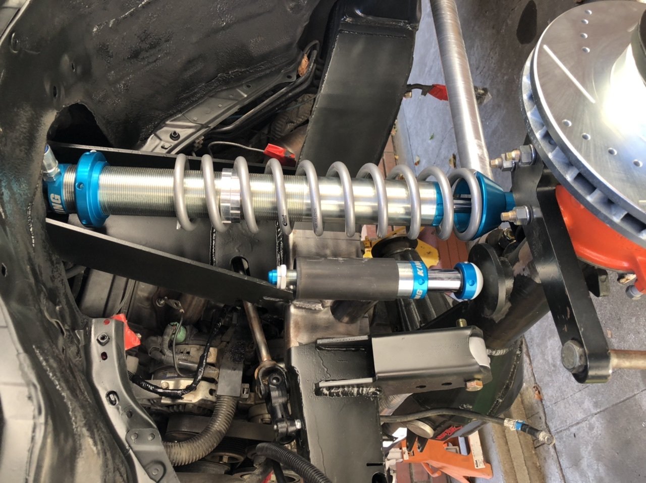

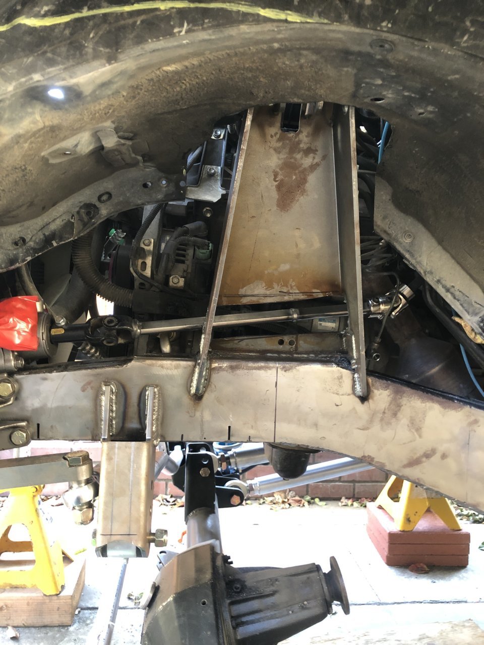

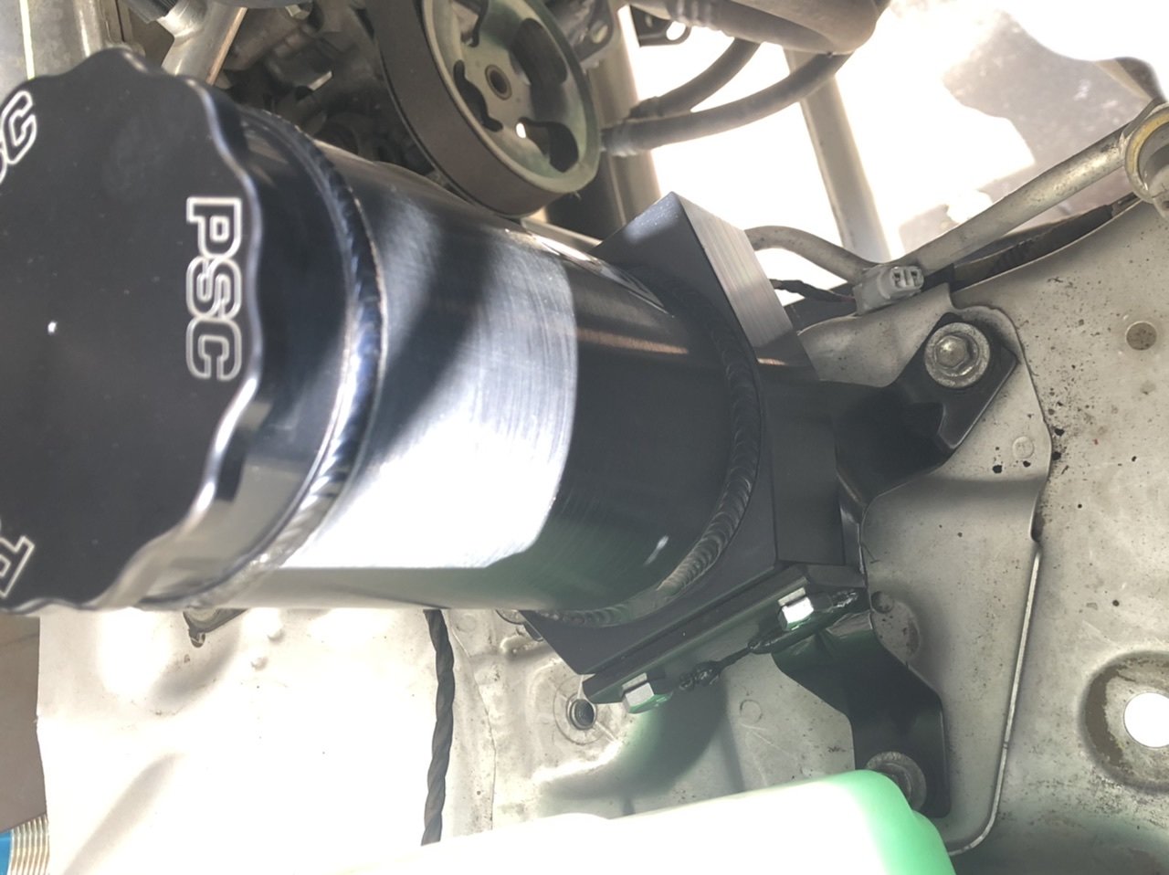

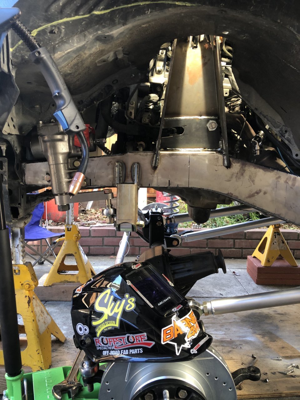

    I’ve been trying to get some things accomplished on the truck but it’s been tough. I did round one for the steering column connections and it bound like fuck. I decided to Channel through the shock tower and simplify the steering. I will Sleeve the cut with 2” tubing. 20FD69BC-E136-4E04-9F30-8827C1A77DF5.jpgB687B86E-F334-45EE-8A28-7F91A21B6515.jpgimage.jpg

    Build looks good. The little stuff always takes a while to button up. You just gotta keep making forward progress.

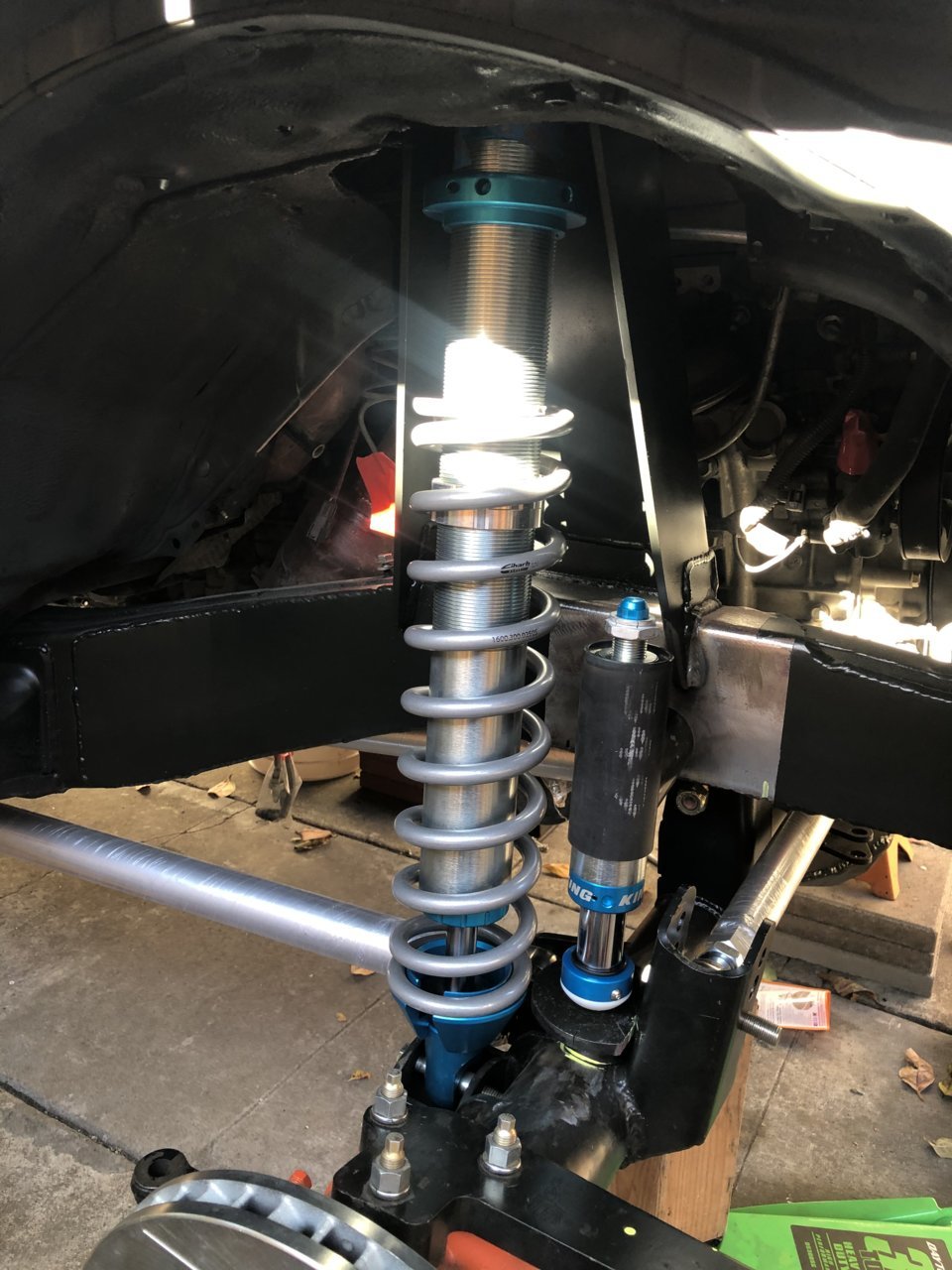

    Looking good, Pat.
    Coil overs still clear with the steering tube through there? Can’t wait to see this up and going again!

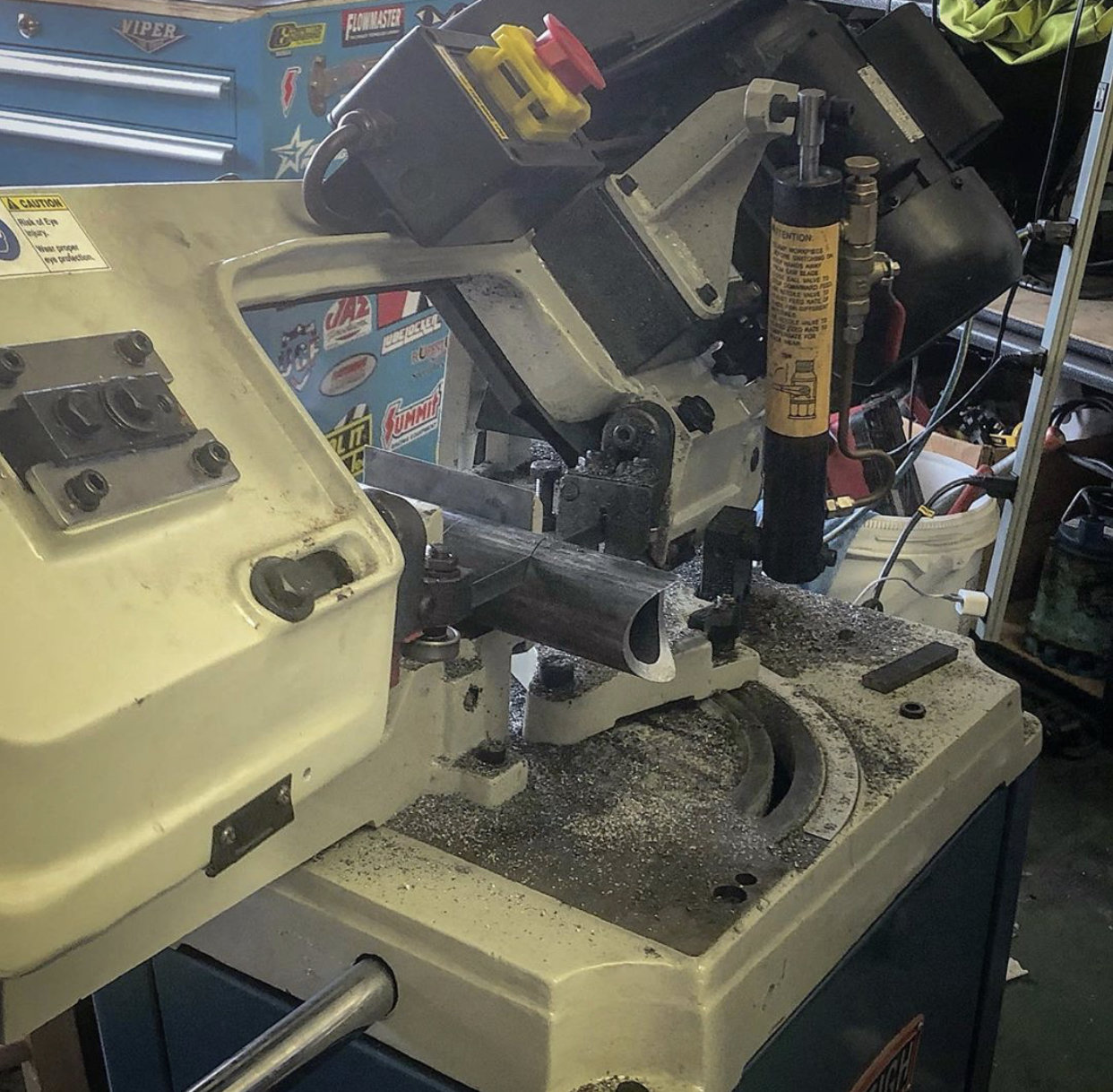

    Cutting some pieces for the air bumps.
    C50E7743-8320-43AD-8927-54EDB33208E7.jpg 597576AA-7229-40FD-8BDF-20FE8B870B82.jpg

    Making progress on the bump mounts.

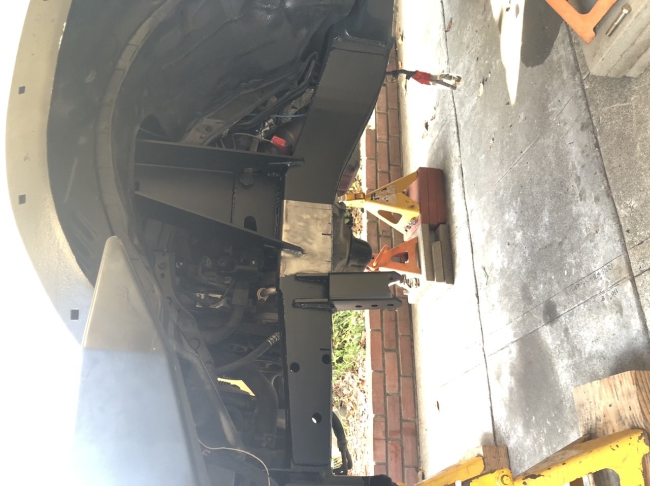

    I'd consider plating in that panhard frame mount, I've seen that style crack because they aren't fully boxed in. Really don't know why it isn't from the manufacturer.
