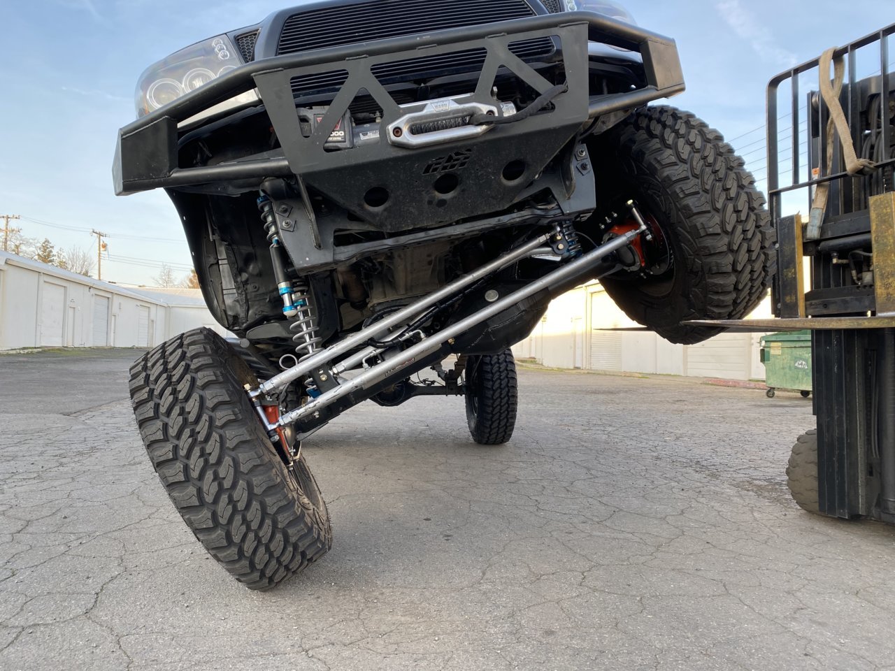

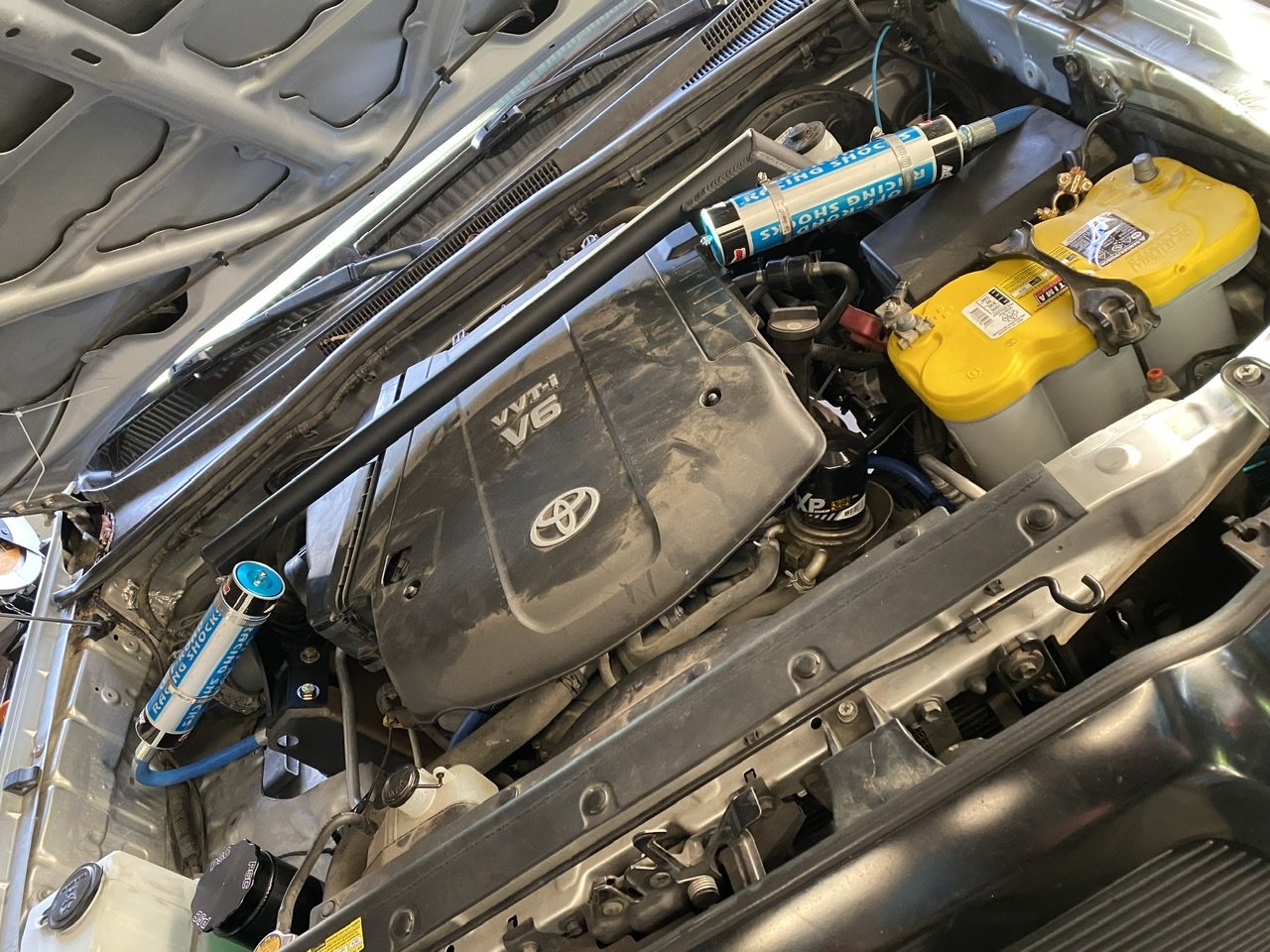

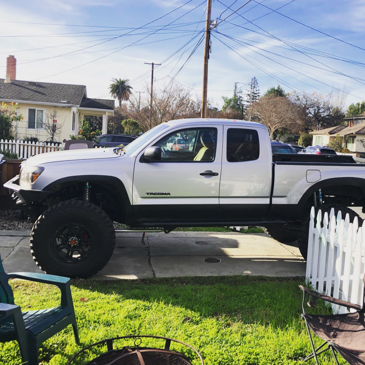

    Dropped off at Cali fabrication for regear and hydro assist and to rework the steering box a bit forward.

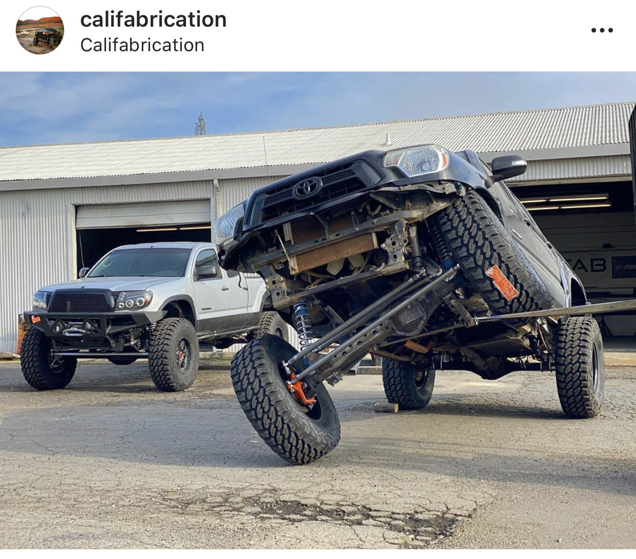

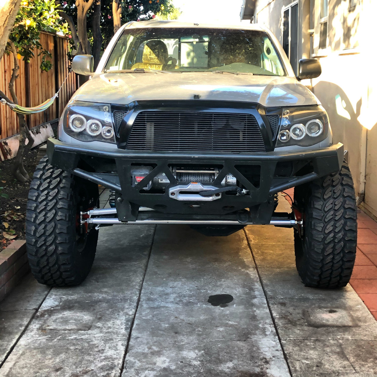

    Ty. To be honest I really didn’t realize how Much work it was going to be. I really learned as I went and kind of got lucky with my placement of things. It was good to take it to a shop for the hydro and regear. Califabrication looked over things and tweaked the steering box forward and engine brace. I pick it up tomorrow. 29B2A1BC-2E61-4953-8C0A-3DBB4213EECC.jpg 9ACB99E2-2EAF-4ACF-9A11-46C402E49C17.jpg

    I did end up having to move it forward. IShould not have gone with the predrilled location in frame plate.

    To clear larger tires I always tell people to push it through the core support. It’s a huge limiting factor when you can’t go any farther toward because the steering hits. I regret not pushing mine farther but won’t be re drilling that anytime soon.
