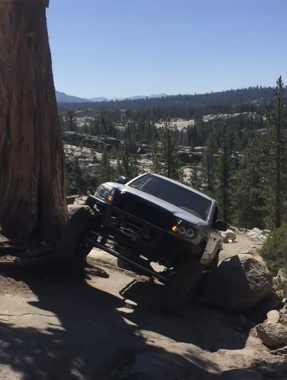

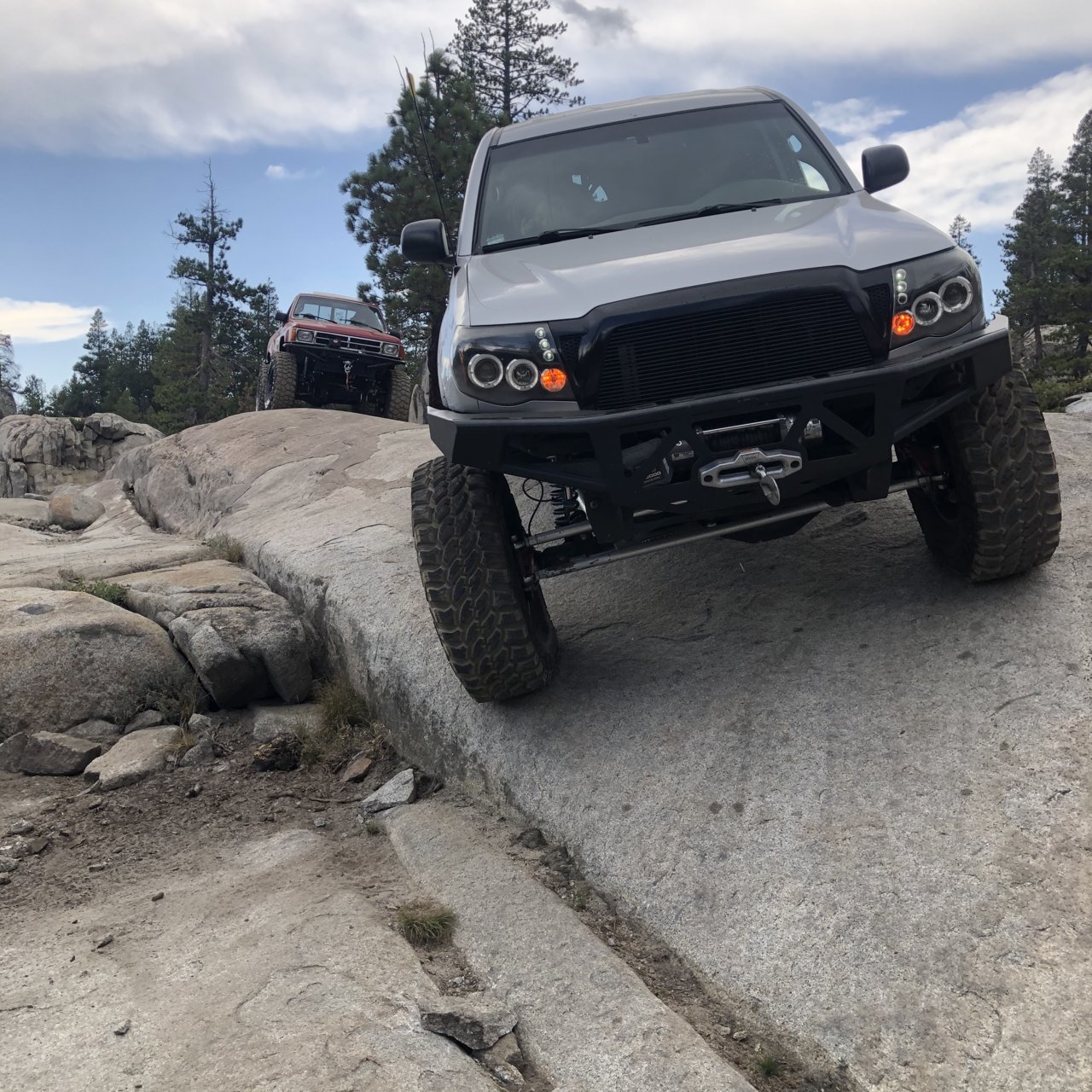

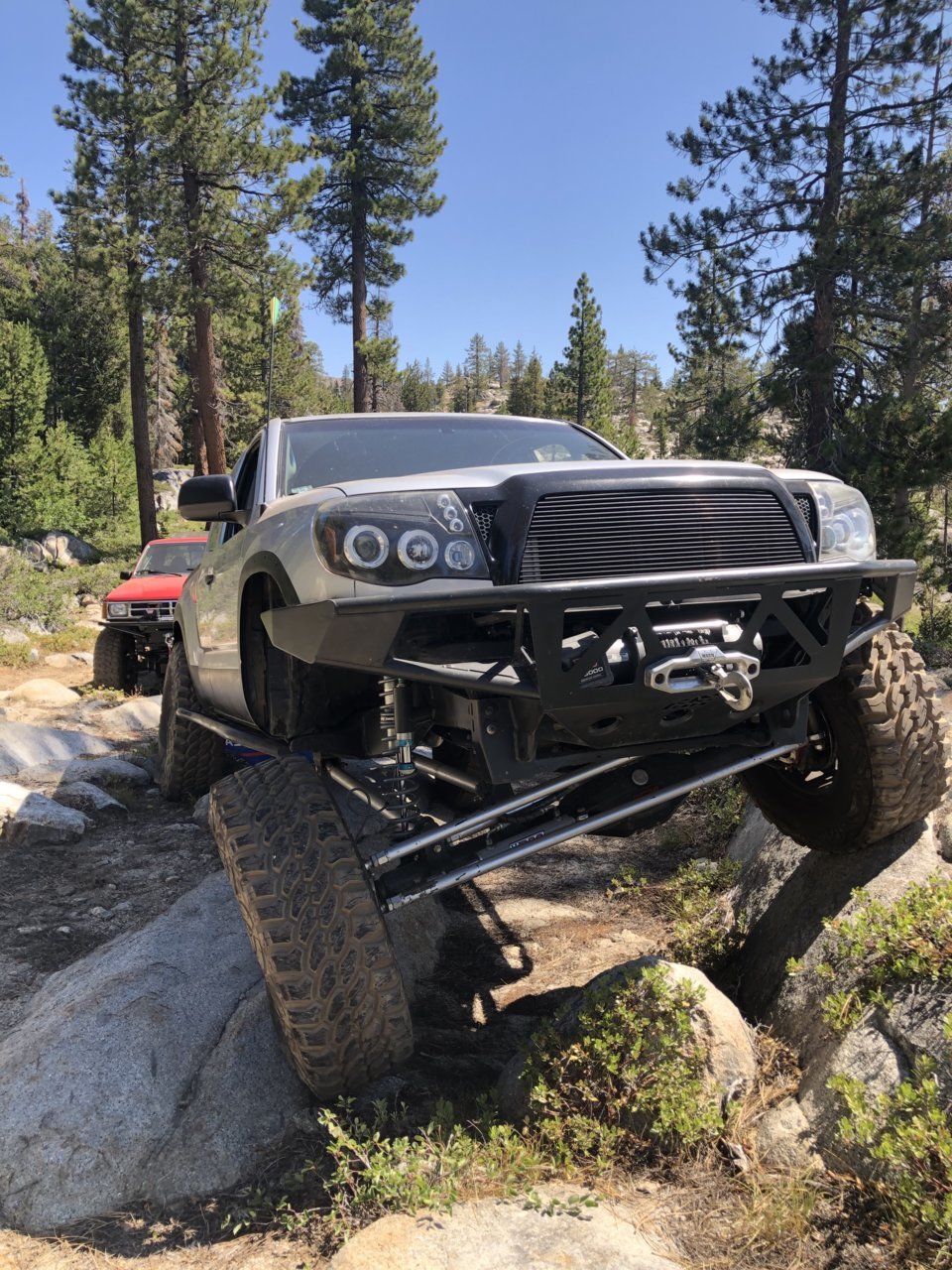

    I went to slick rock and camped right after the bridge from Utica side last weekend. It was the first time out since the build. Really fun running the trail back and forth. Not many pics. The gauntlet at the lake alpine side was really difficult and loose. Going down isn’t really a problem but up is tough.

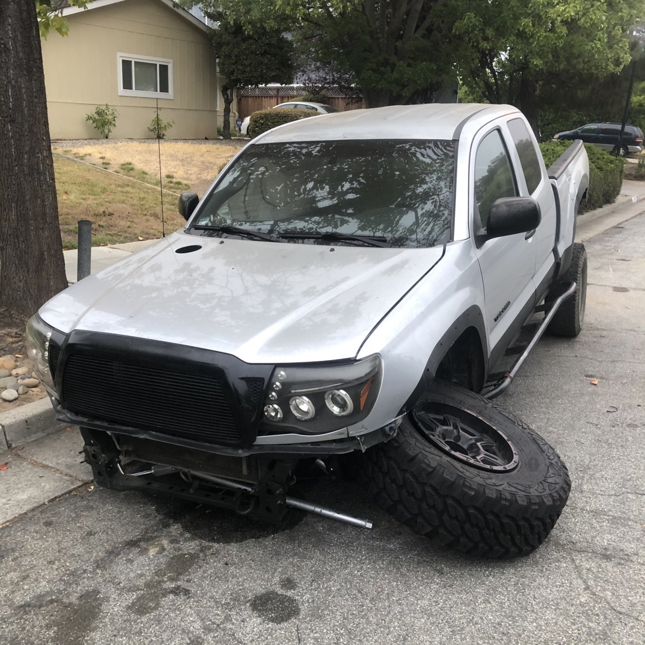

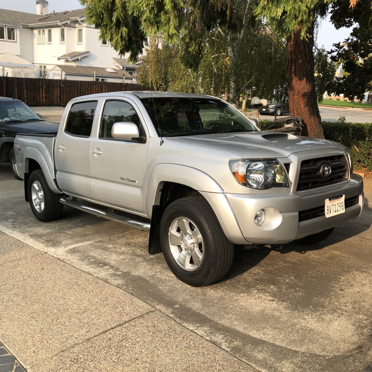

    By the way my truck was totaled. Tboned at a red light. I picked up an 09’double cab short bed super clean inside and out 66,000 miles. It will be getting all of the parts from the access cab. I have my new housing on order (the housing was bent in the wreck)and am on the list for hellfire knuckles.
