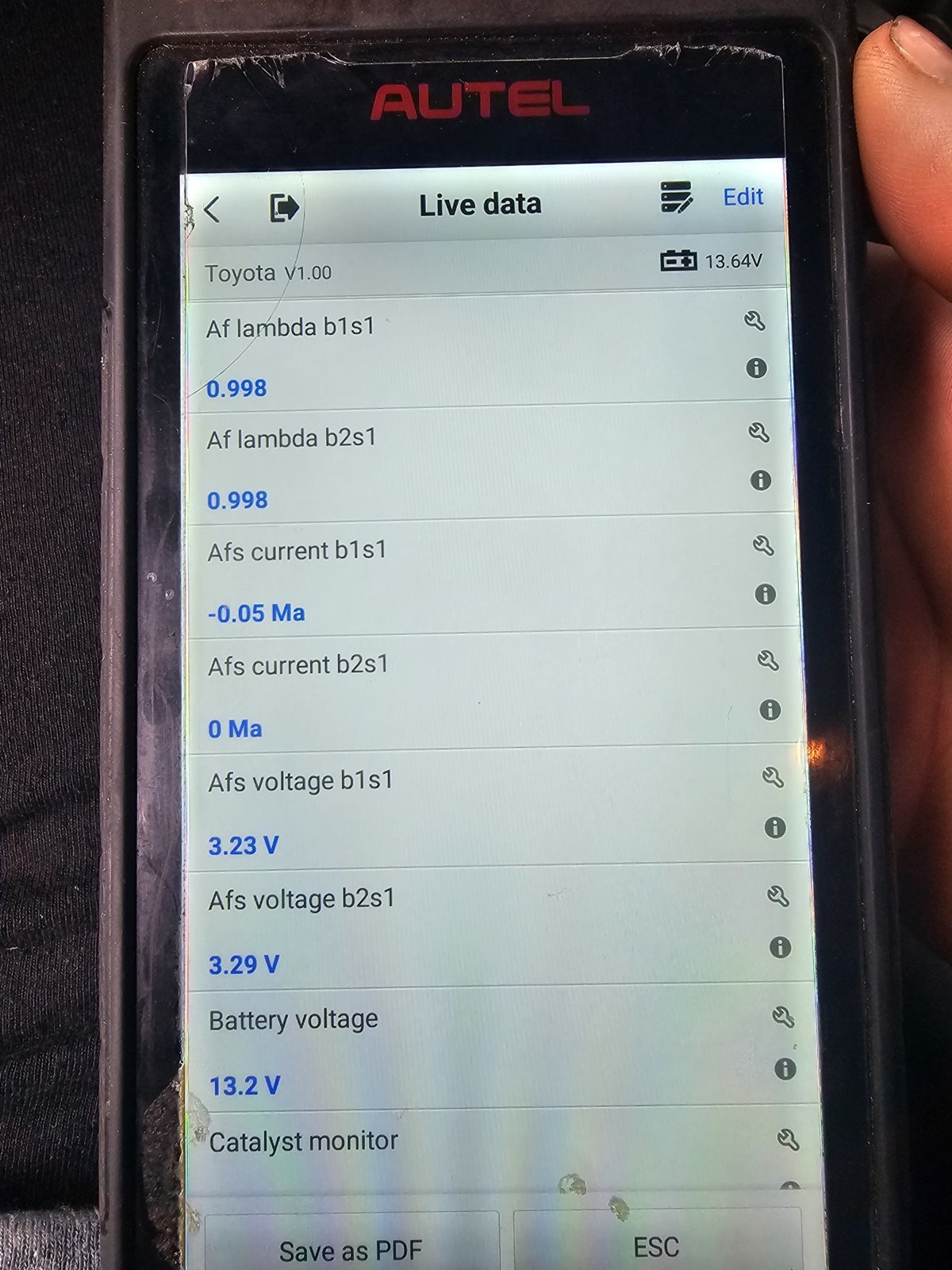

    Ran into a problem after and engine swap.... the truck runs great but have a p2241 code I replaced the 02 sensor (driver side upstream) with denzo one. code immediately comes back on. here is some live data if someone can help me out thanks :)

    If you can verify the sensor is good (you can swap the upstreams and see if the code follows the sensor or not) then you likely have a shorted wire. Are you sure you didn't pinch any wiring?

    Thanks for the reply , I put a new one in and got the same code, the wires look fine nothing pinched. kind of stumped atm other then on the file I posted the MA reading is 0 on the bank I'm having a problem with.

    Gona have to check your wiring then, you either have an open or short to ground on one of the AFR signal wires, I left the wiring diagrams and the code criteria/testing in my earlier post. If you have any questions just ask.

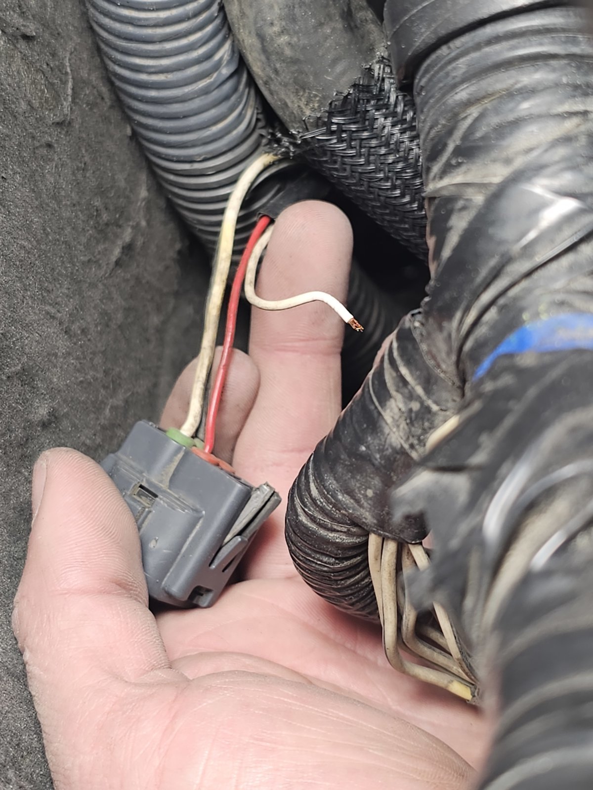

    Just kinda gave a tiny tug on the wires and this one came off so I'm hoping it's the signal wire ...lol I'll give and update after I reconnect thanks

    That will do it
