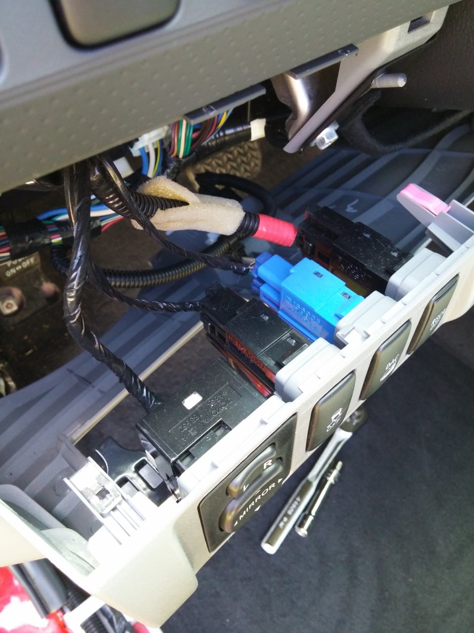

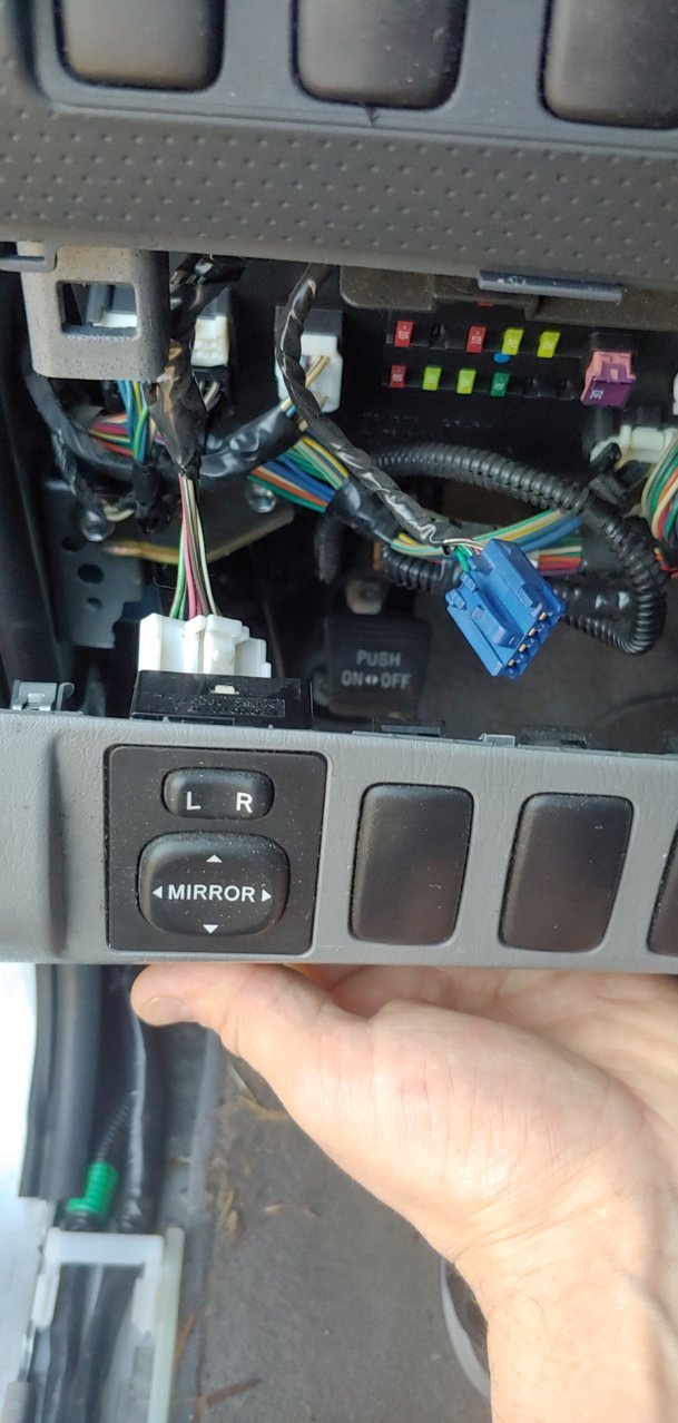

    Hey guys got a quick question. I'm working on installing a remote starter system for my truck. and when I was pulling the panels off there was an extra blue connector next to my mirror switch. and this blue connector was plugged into a dead plug. I was kind of wondering what the blue connector is for. and if I can possibly attach another switch for another function on my truck

    Its probably the prewire for fogs. Just connected to a dead button.
    you might be able to buy fog lights, and an oem switch and have fogs! What package is your truck?

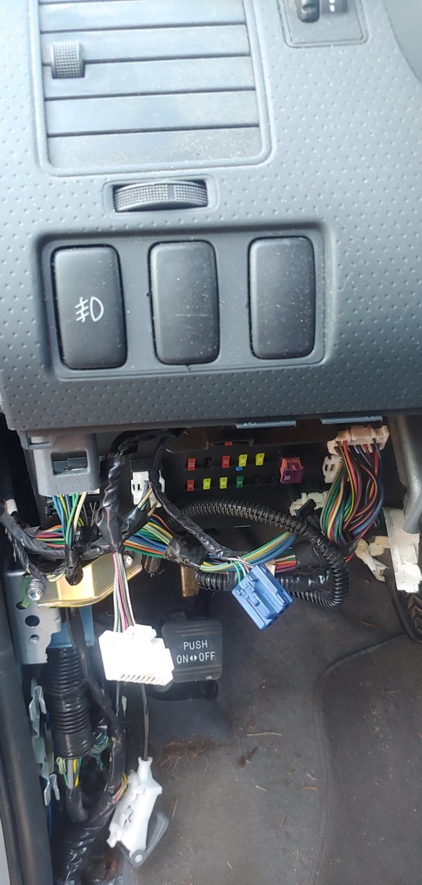

    above that on the upper part of the dash I already have a fog light switch.

    There’s several connectors left behind depending on what options you got with the truck. Toyota uses a standard wiring harness across models that included the connectors without the added accessories.

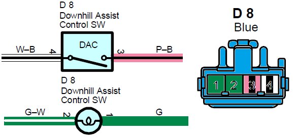

    Green and green/white are the illumination wires. White/black is ground. It's hard to see what the 4th color is. If it's pink/black, most likely it is DAC.

    So it looks like possible traction control button

    P.S. : Adding the (DAC) Switch to connector will NOT activate/enable Down Hill Assist in you 2006 Tacoma.

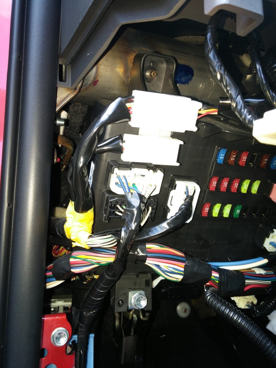

    Is NOT for the brake controller. Brake controller connector is white and located behind driver's side kick panel.

    The 7 wire trailer plug is for electric brakes. The brake controller connector is located in the drivers side panel in the foot well
