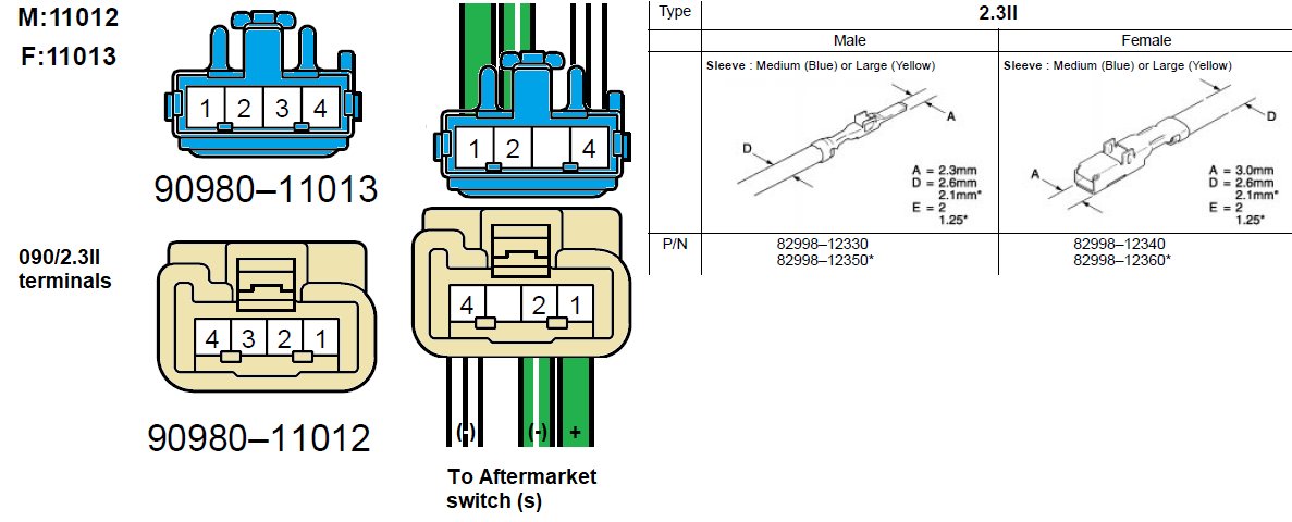

    Okay thanks guys I did find the brake controller connector behind the kick panel but I was just curious about the blue connector so thank you

    So you may add aftermarket switches...just add a fused ACC source...
