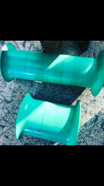

    The trade off of a 22hz tuned box for auto mobile installations isn't worth it as the port has to be THAT much longer needing more gross volume.
    I'm perfectly solid that you will be more than happy w 30-33hz tuning in a 1.4-1.5 cf net box. That is already quite a big box for behind the seat. A slot port is going to eat up a ton of volume, way more than the pvc aero ports, and won't sound as good or won't be as loud.
    We see it all the time in our big builds. This is an example of bigger custom
    Made flared ports, 8 and 10 Inch internal. One is for spl, one is for lower tuned demo and dialy
