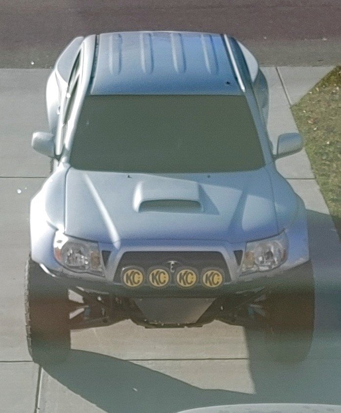

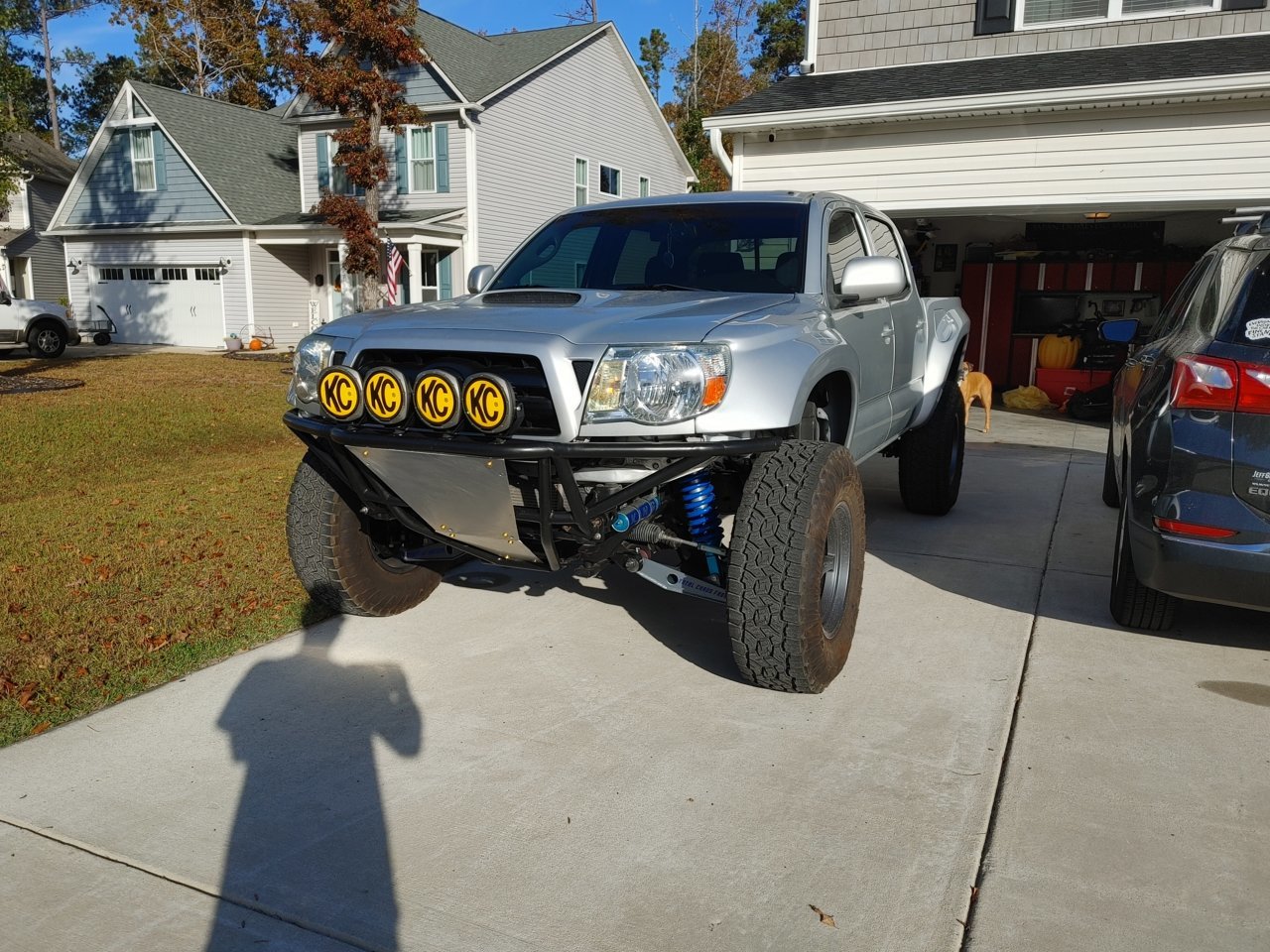

    The problem with the baja look is no matter what wheels or fenders you have your lower control arms make it look weak sauce.
    4 inch glass, 3.5 Long travel. No wheel spacers on 0 offset
    +6 glass is for the +4 long travel
