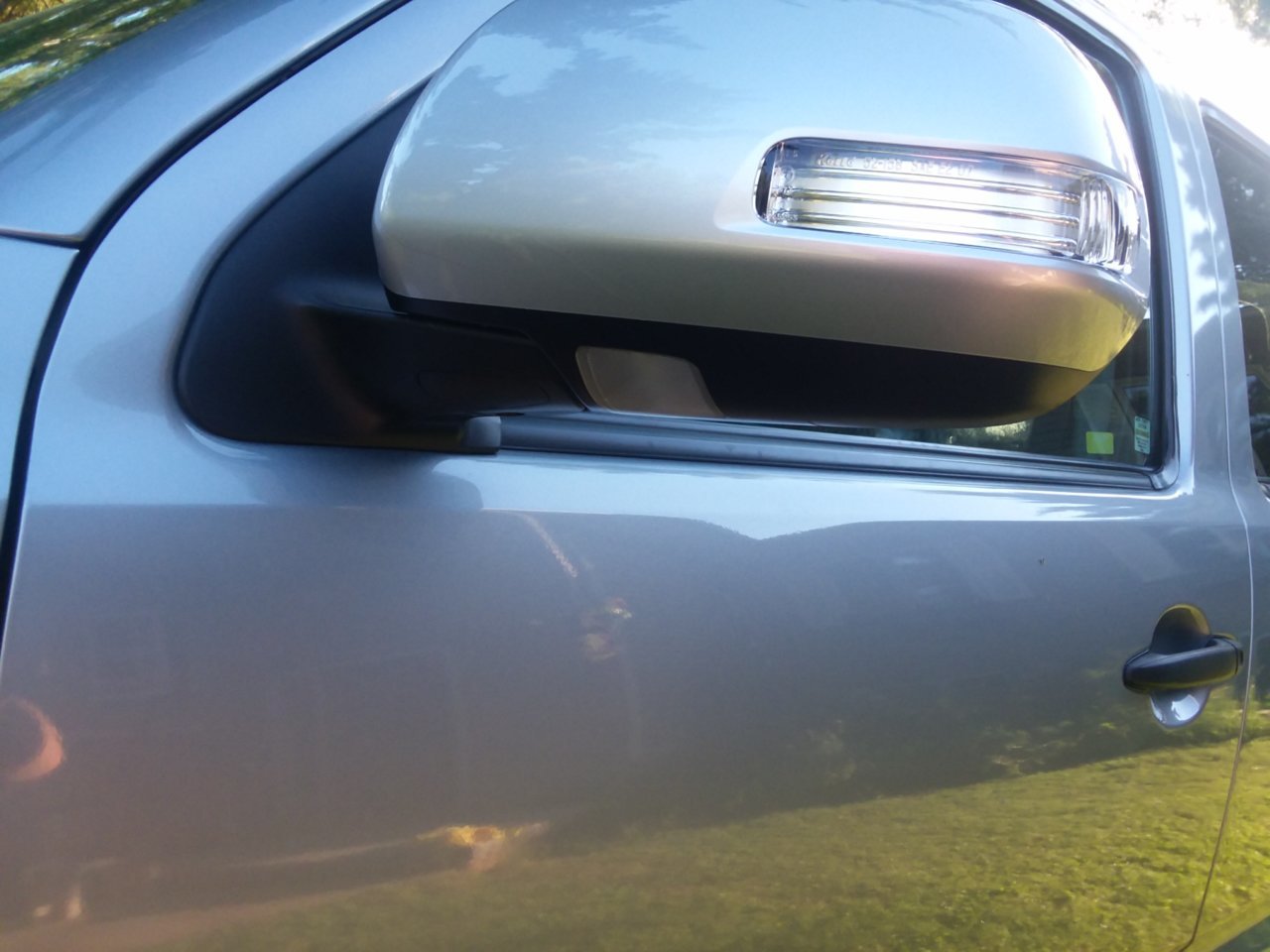

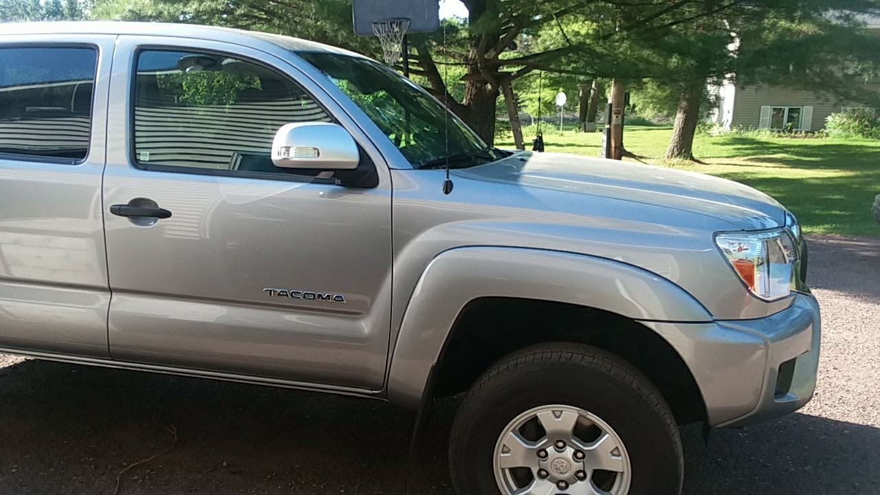

    I changed my mirrors with 2013 4Runner LTD mirrors so I could get heat and puddle light too. It is a pretty big wiring job, but easy if all you want is the turn signal as my 2015 had the wiring in place for that (not a sport...) I posted a while back about it and the process...
