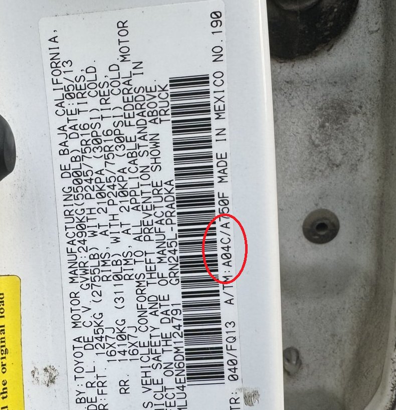

    Take a look at your door jamb sticker and dollars to donuts it will say A04A as your axle code. What's been said about you not having 4.10 from the factory is correct. As far as which gears you should run for 37s, 5.29 will be the better choice with your auto transmission.

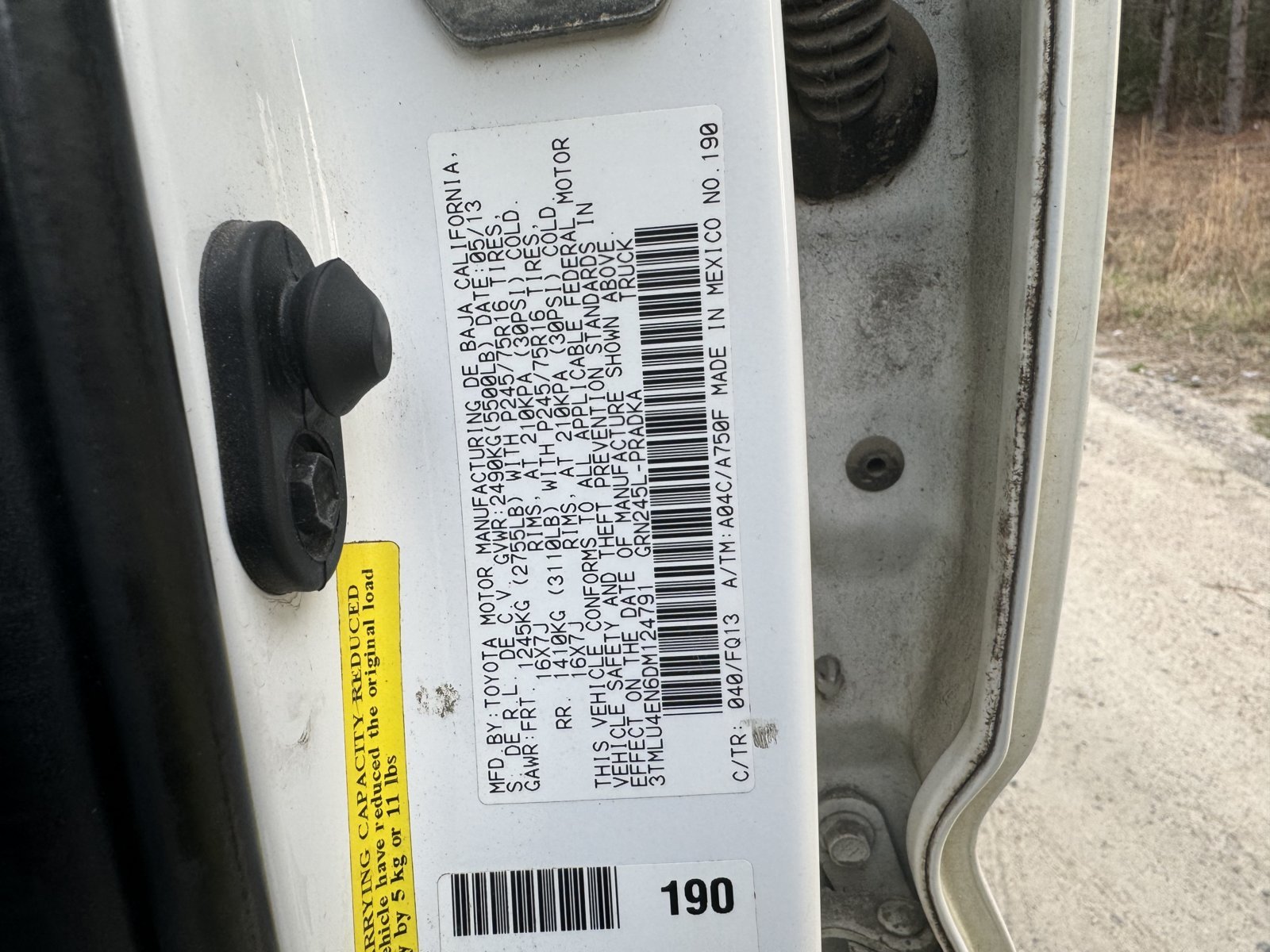

    IMG_3198.jpgY’all tell me idk

    A04C 8" ring gear 3.73 gearing with a lsd rear end

    I was close, and also surprised you have a limited slip.

    I Reckon previous owner already switched them I’ll admit I was wrong

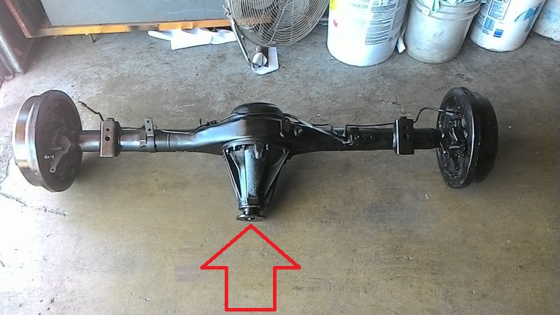

    Someone else correct me if I'm wrong, but here's how I think you do it, though I've never actually done it. Might be worth double checking what I'm saying with a YouTube video.
    Let's say you have 3.73:1 gears, that means for one full tire rotation, your pinion will rotate 3.73 times. Put your axle on jack stands and then disconnect the rear driveshaft. Take a paint pen or something and make a mark at the top of your tire and the top of your pinion. Slowly rotate the tire, counting how many times the pinion rotates. After one full tire rotation, your pinion should have rotated 3.73 times.
    This is your pinion.

    Correct, 1 full tire rotation should turn the pinion/driveshaft 3 3/4 with 3.73 gearing
