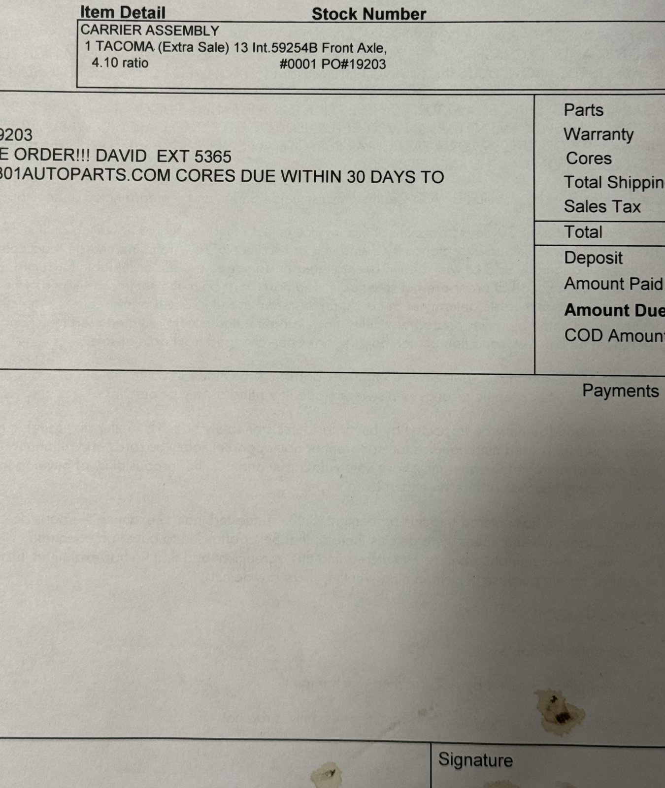

    IMG_3200.jpgUnless on paper they have the wrong gear ratio it’s definitely a 4.10 up front

    There's a bunch cut off there, does it show the VIN it came from?
    Yours definitely came with a 3.73, both your axle code and VIN show that.
    For those asking about the "C" in this case, it does not mean a physical LSD. 2008 was the last year LSD was available.

    I cut off some names and prices but no, vin was not listed and yes they proved me wrong earlier this truck definitely came with 3.73’s but I had replaced the front diff and that’s the one I put in and it very well could be 3.73 they just have it listed wrong on paper but I reckon I’ll check the front tomorrow to be sure
