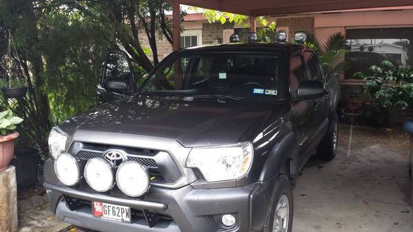

2nd gen tacoma roll bar like this?!?!?!?

    BUCKLE UP! It makes it harder for Aliens to pull you out of your Truck.
    Roll bar could save your life. Like.

    I wouldn't trust a roll bar like that one in the EBay listing. If you look, it bolts to the bed rail. Anything bolted to the bed rail would be useless in a roll. The one in the post above looks like it MIGHT be the kind that bolts to the frame, through the bed, which is the only TRUE roll bar. Just my opinion. Now if you want to just utilize it for lights, then yeah, that one would work just fine.

    ^agreed. Plus they are made out of exhaust tubing and would fold up like a lawn chair under a fat girl at the mildest of flops. Good for mounting lights...on a single cab. The AC and DC cabs are too large and block the light pattern leaving a shadow where you need light. Sure did look cool on the "back to the future" truck though!
