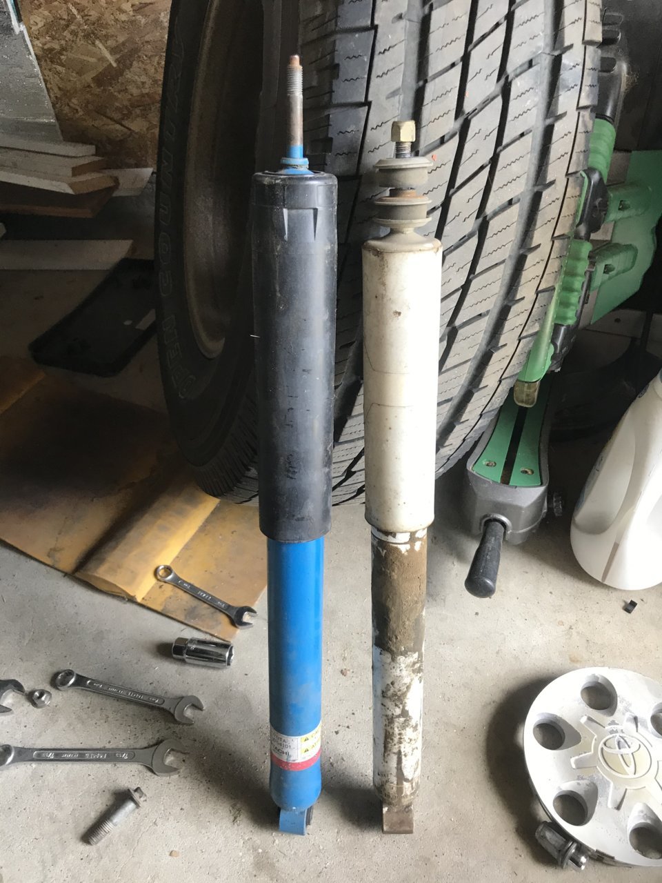

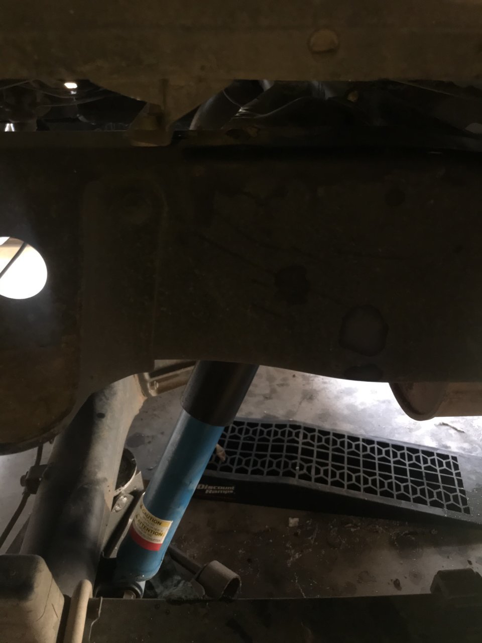

    So I got motivated and swapped the rears off my 2018 Sport onto the 2002Tundra. Easy swap. I will be driving about 100 miles tomorrow And report back. The Tacomas Hitachi shocks are maybe 1/2” longer, and certainly easily compressible, even compared to the very Old KYBs I took off. Were KYBs the oem brand? i may try the front coilovers this weekend. Look very similar as well

    Rear end feels great. Nice ride. No bouncing. These Hitachis from the Tacoma Sports are a VERY cheaply made shock however, nowhere close to the Bilsteins 5100 or 5160s I prefer. I wouldnt rely on them for any rough stuff or significant weight on the rear end. will go ahead and install the front coilovers. Im expecting a mild lift perhaps as they seem longer, will try to measure before and after.
    edited with photos. Easy job but VERY tight getting to top nut. Lift would make everything easier.

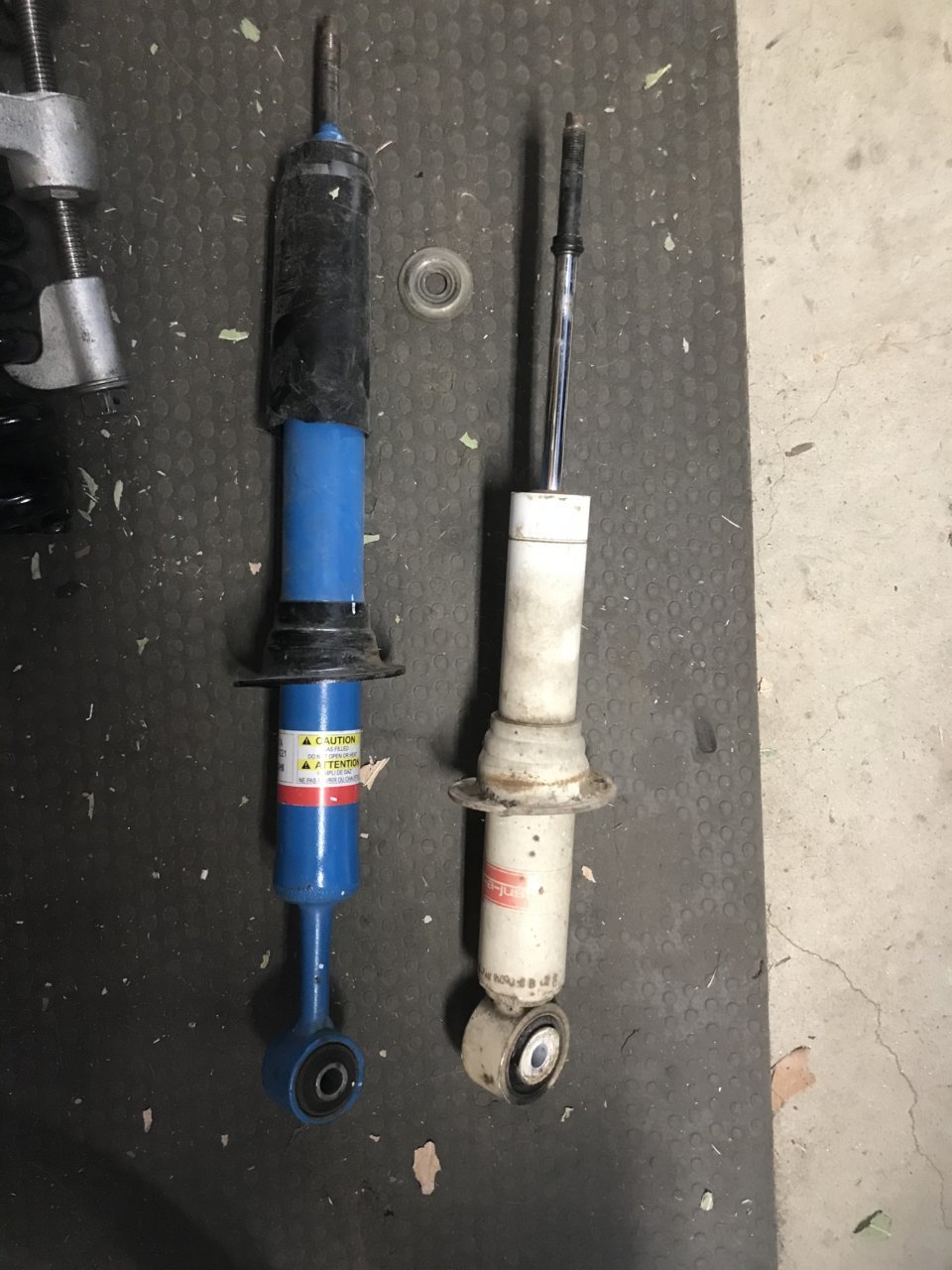

    3E936F2D-9D44-4657-81C9-CBDABABCCF76.jpg Long story short. They dont fit.
    1. The top hats are different spacing for the 3 bolt heads.
    2. the shocks are vastly different, as you will see in the pix. The bottom coil flange is much higher up on the tacoma strut, and that, along with the extra coil would probably lift it 3” or so.
    I tried to swap top hats even, but with the length of the Tacoma coils, my basic coil spring compressors could not even get them back together. The very old kyb I removed actually had more resistance to compression than the Tacoma Sport Hitachis. Im sure its how they designed these cheap a- - shocks tho.
    i will likely get a coil over setup thats already put together in the future. All the bushings are pretty much shot, and need new roll bar bushings. sorry guys!
