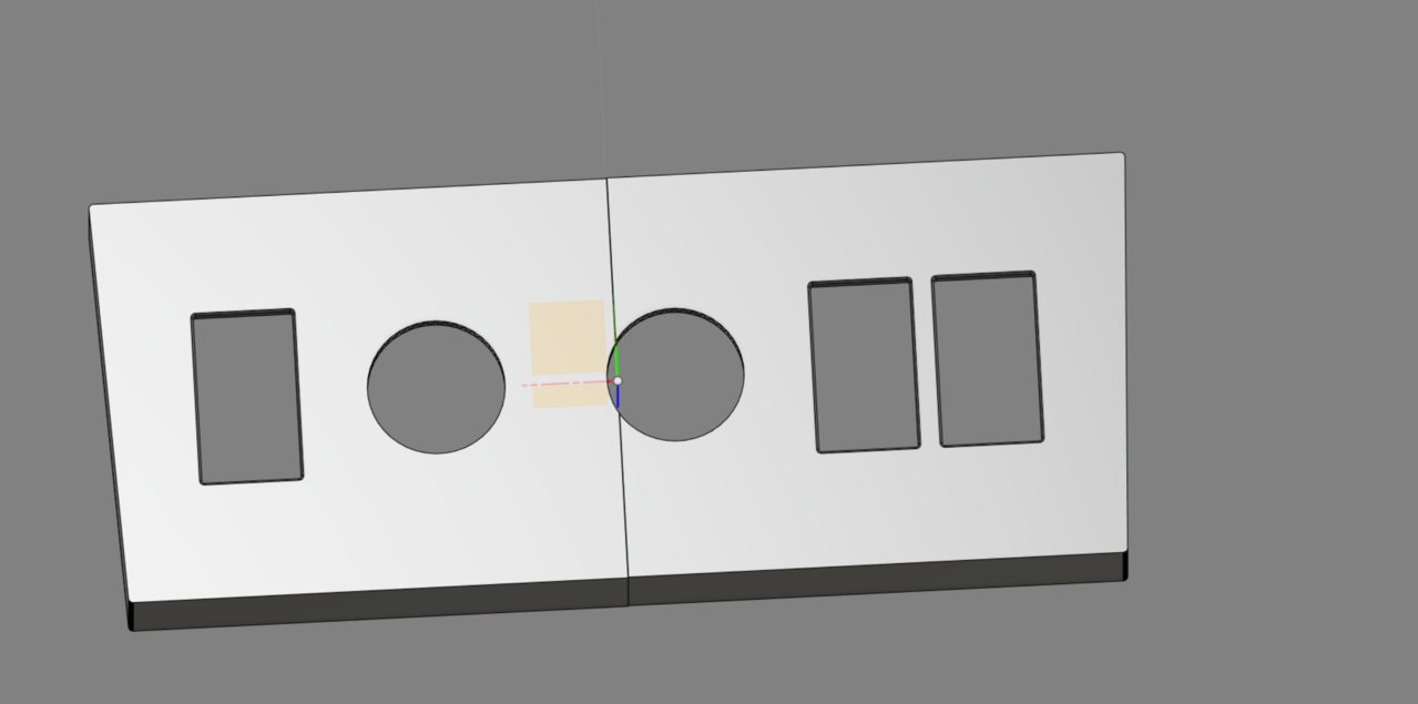

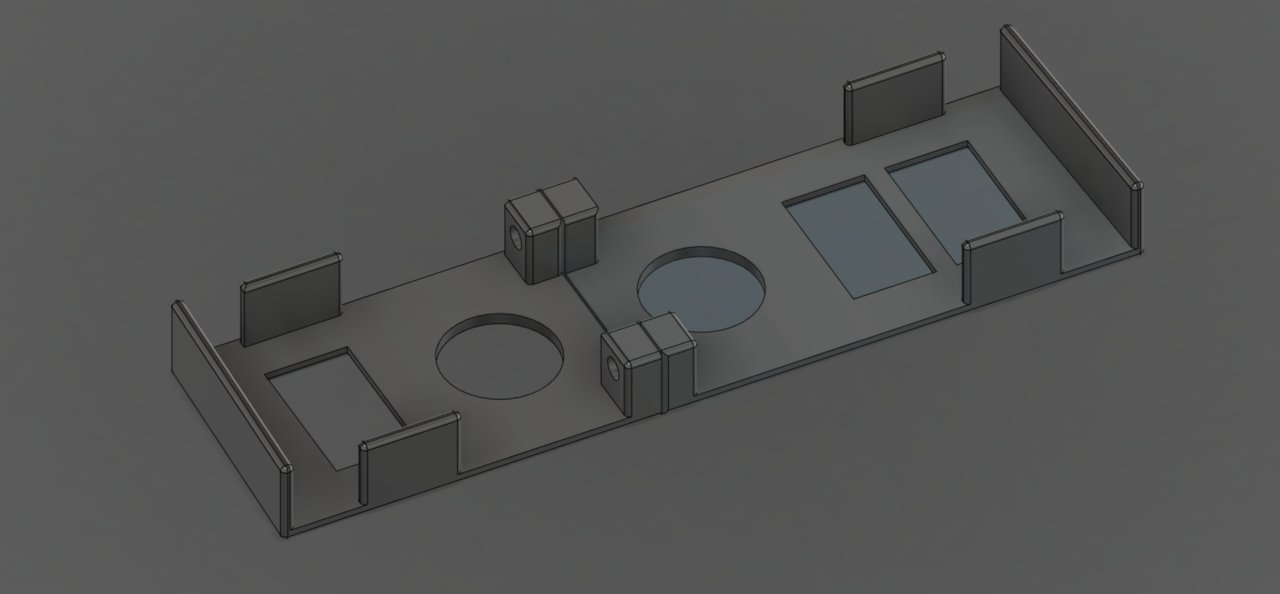

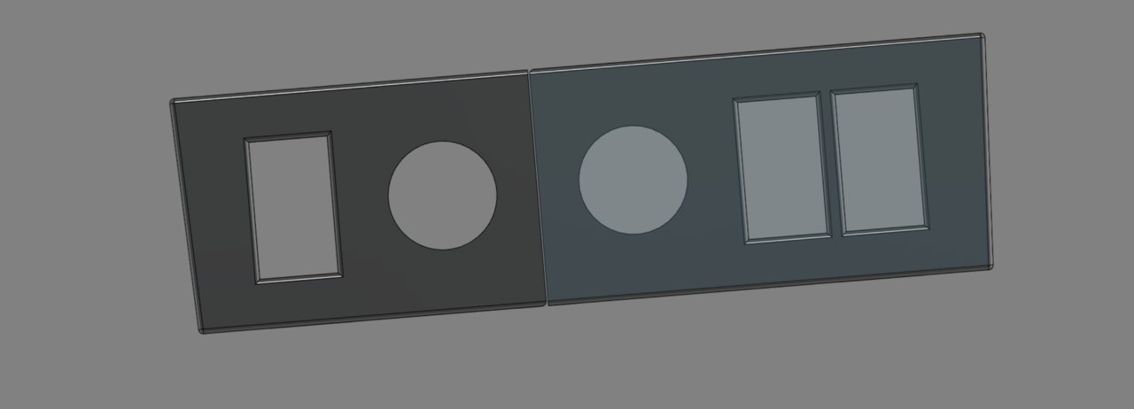

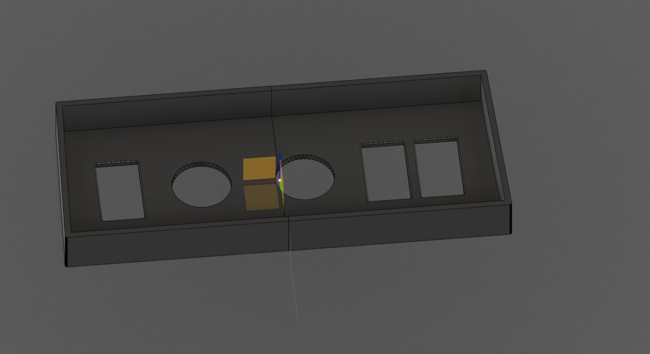

    as for the mount, here's the update nobody asked for:
    Whelp currently printing v2 (v1 would work for automatic trans, but ive got the 6spd so the pocket is a shorter.)
    v1 was planning on just gluing together as the retaining ring for my volt meter holds the two pieces together,
    find out its too big to fit
    onto v2, finger gauge the [ pocket (roughly 2.5" not original 3"+) -> remake file and go for sturdier assembly with two metric bolts laying next to printer.
    t-2hrs till test fit. :fingerscrossed:

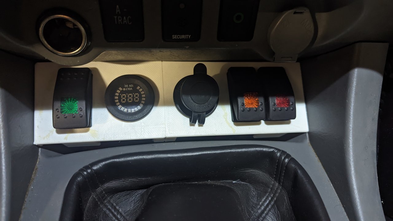

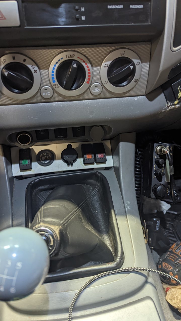

    update:
    v2
    So there's a bit of a radi along the bottom I didn't pick up on, will fix in v3...
    Fitment width wise is awesome.
    got a little excited and mounted all the switches upside-down ( It's 11pm and I've been studying all day... my brains a wee shot)
    besides that im pretty excited to wire it up to my light bar, ditch lights, and rock lights, having the extra ciggerette style plug is great for the used up plug all winter from my heated seat covers, and the voltage meter doesn't hurt for the campsite tune station...
    Will update in a couple days with final bracket/installed photos.
    comment below if any of you other manual 2nd gen owners would like one and I can get working on printing / shipping estimates.
    roughly I'm in about $5 per print with the metric nut/bolt/plastic
    (wouldn't include switches) but any classic switch should fit
    plan is to finish with high build primer, sand with 800 grit,
    spray with colour matched "SEM interior color match spray paint"
    can re-model for up to 7 rectangular switches, +- round ones if want more or non at all.
    Let me know what you guys think! Cheers.
