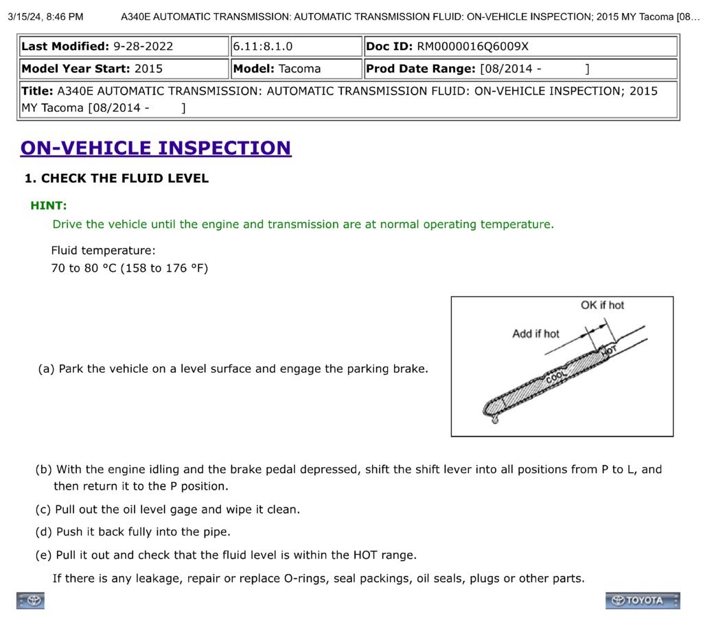

    I have a 2015 4x4 2.7L with the 4 speed automatic. I have a dipstick to check the transmission fluid level but I tried reading the owners manual to see what’s the correct way to check the transmission fluid level. Does it need to be running in park? Or does it need to be turned off? I know some manufacturers have different ways to check the level on the dipstick. If someone can either send me a link to a thread going over this topic or just help me out it would be appreciated.
