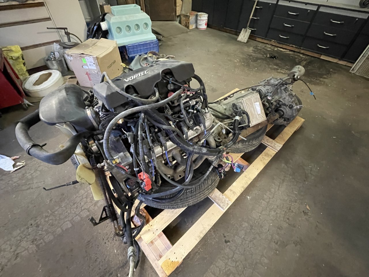

    So I thought this might be helpful and interesting to others on here to document a swap to a V8 from the ever so faithful 4.0.
    Why do a V8 swap? Well, why not. As simple as that but not so simple in practice
    I am in the process of frame-swapping my truck thanks to Toyota's reliable frame failure. Unfortunately missed out on the dealership completing the work due to my truck being imported from the US into Canada. As a result, Toyota US said it was not their problem, and Toyota Canada it wasn't their problem either. You can see how this game of passing the buck went. Needless to say, I ran out of patience and decided to solve this problem myself.
    Somewhere along the way the talk and thought of a V8 came along and then about a week or so later I picked up an LQ4/4L80e/NP246 setup. I also grabbed an NP241 tcase to go for a manual setup to simplify the installation and increase some reliability.

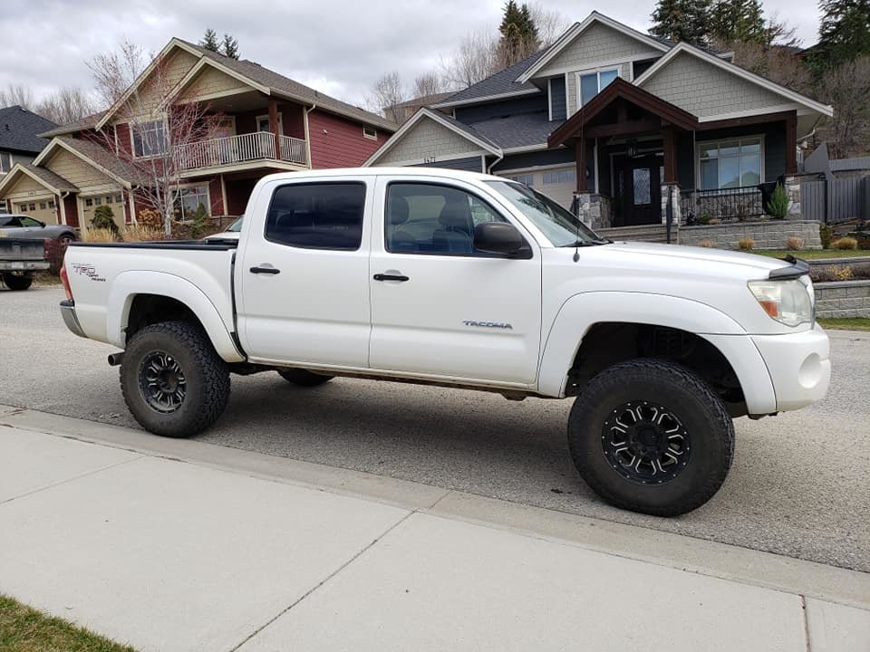

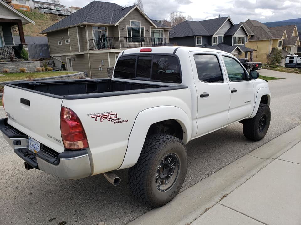

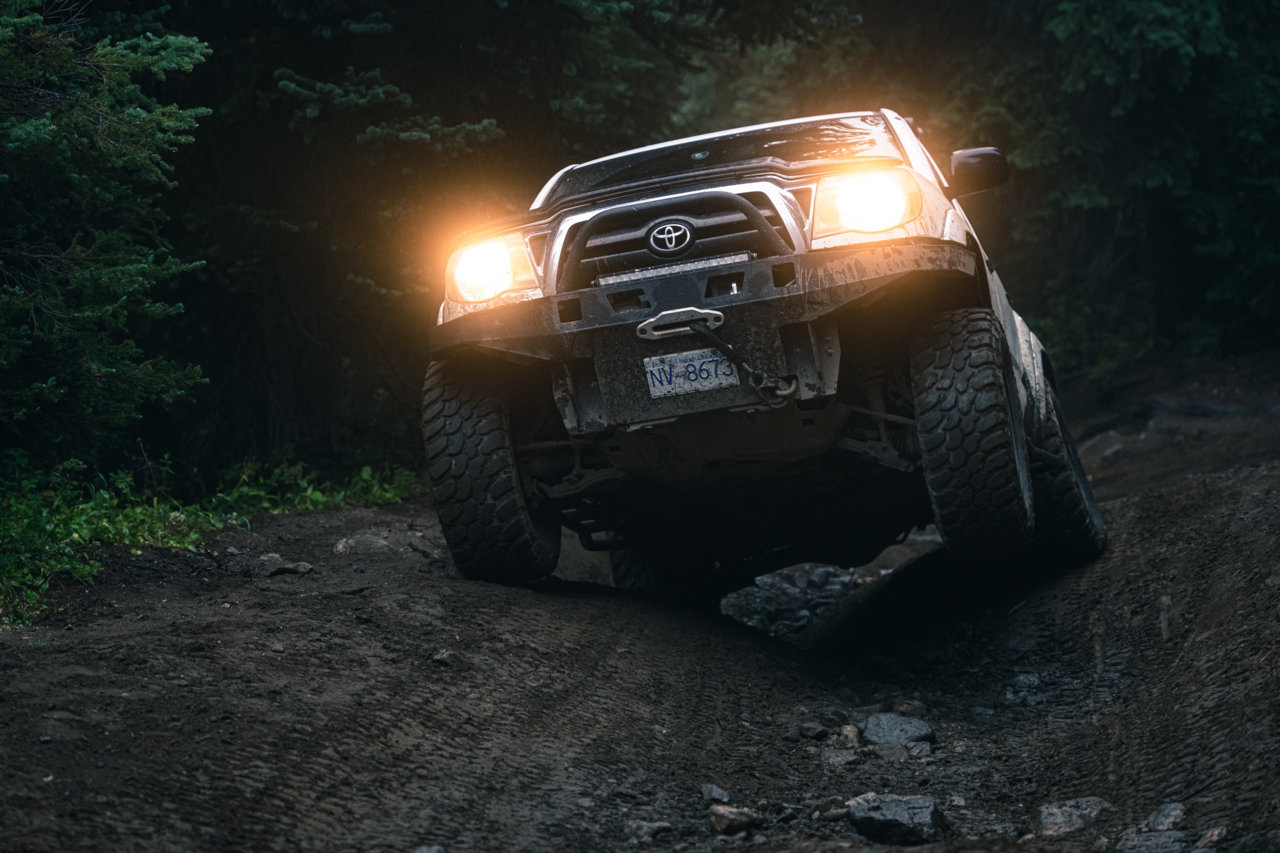

    Here is how the truck looked when I picked it up 2 1/2 years ago and a few more recent photos.

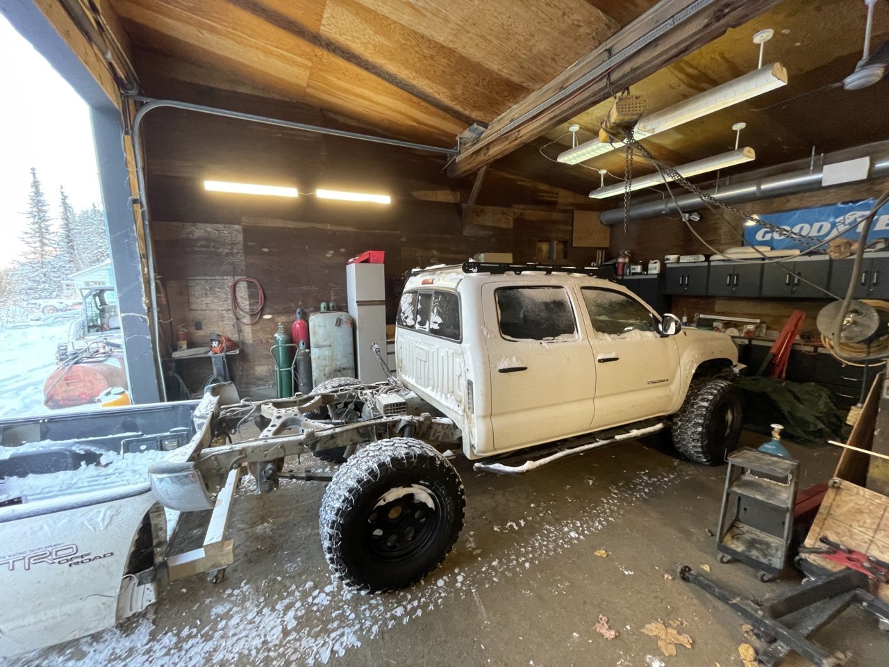

    The current state of things at the moment. Along with the -15C temps.
