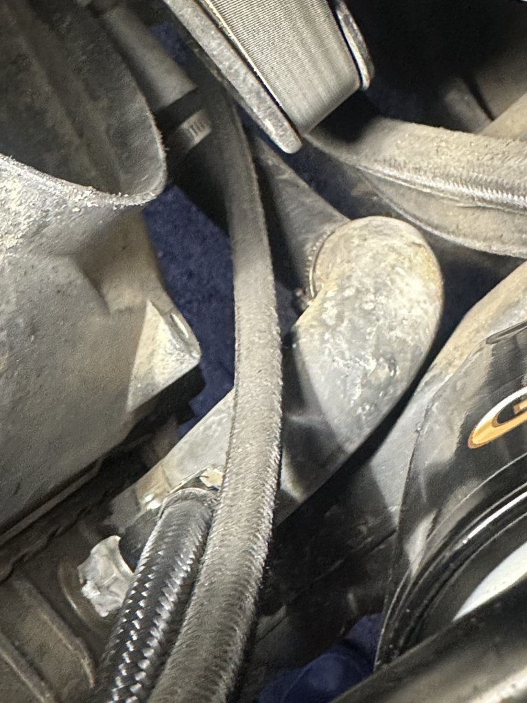

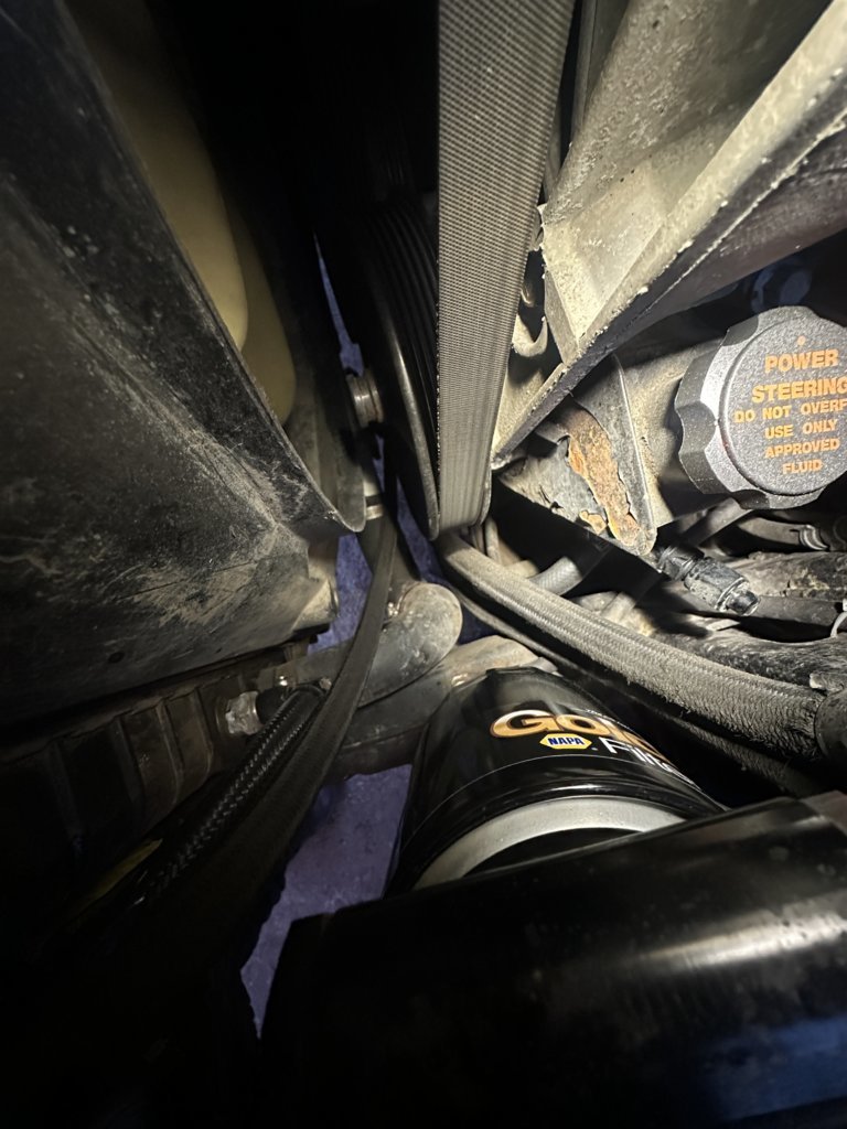

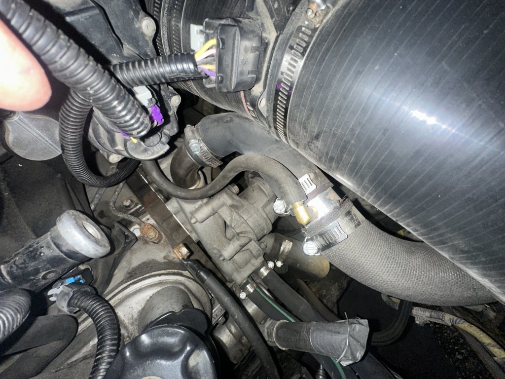

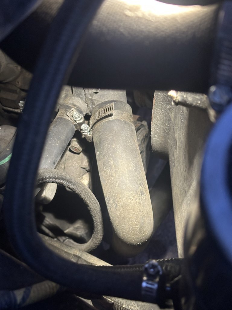

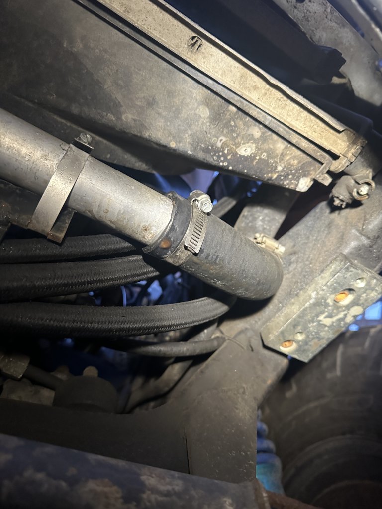

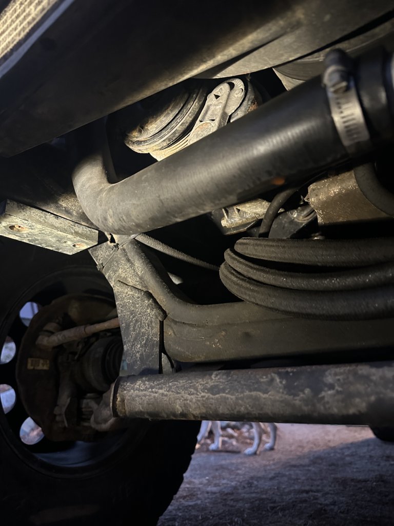

    I bought some AC Delco ones and a piece of aluminum pipe:
    These don't fit as is. They will require a barb connector on the drivers side lower radiator connection and another barb connector with a steam port on the upper hose. I got a piece of TIG welding rod and used that to mock up a route for the coolant hoses. I went to the local parts store and those 2 AC Delco ones worked out nicely with a couple of cuts.

    Did you have any trouble bleeding the system with the extra amount of hoses?

    Forgot to take some for you but this might help you. I do need to tidy things up a bit haha.
    No issues at all.
