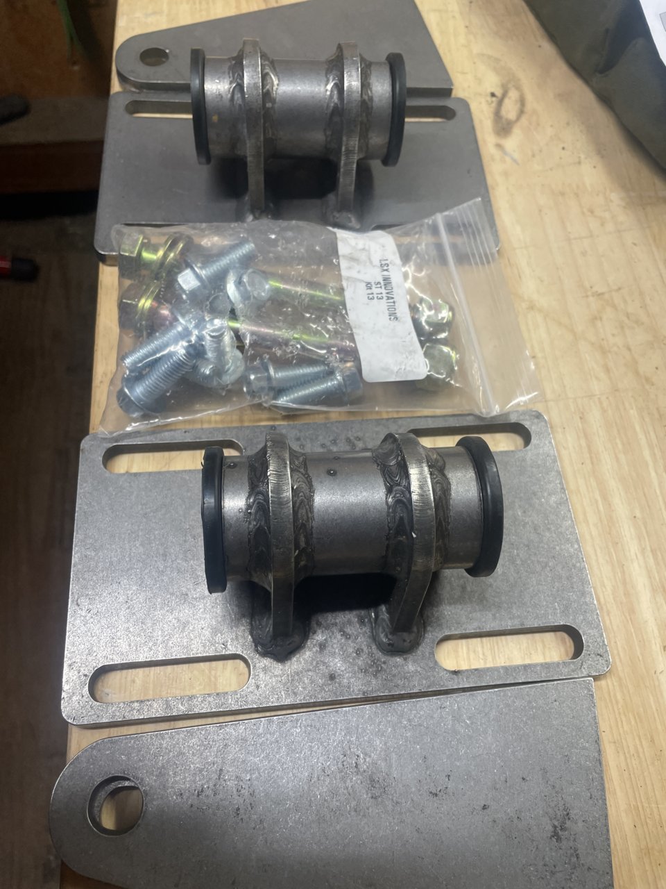

    LSX engine mounts turned up finally. I've been looking all over BC for NP241 slip-yoke eliminator kits to no avail. Does anyone have any preferred company to get them from? I was looking at Offroad Designs kit.

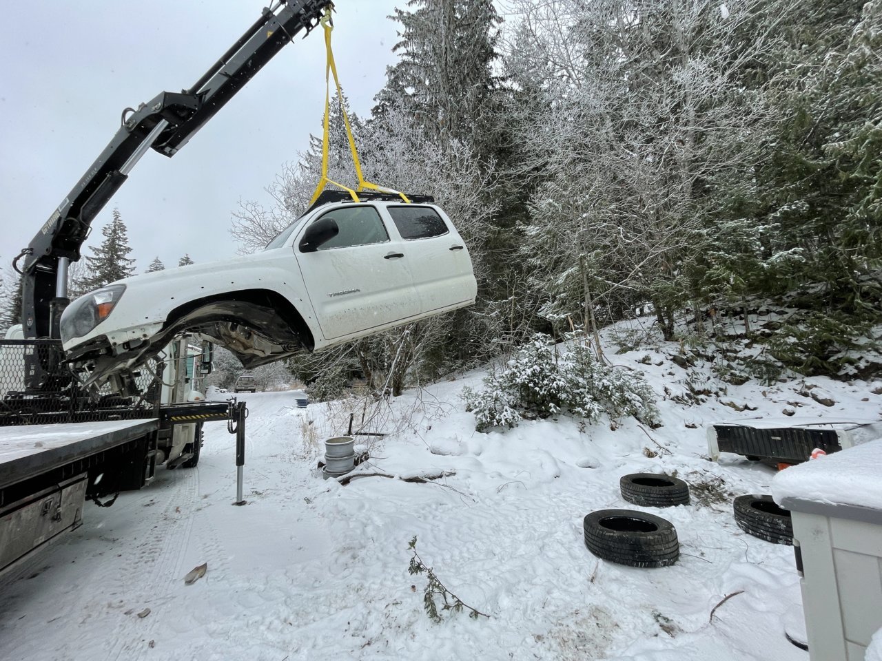

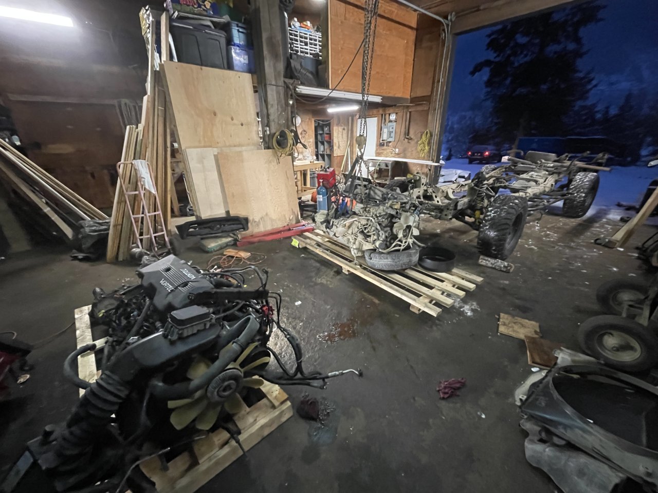

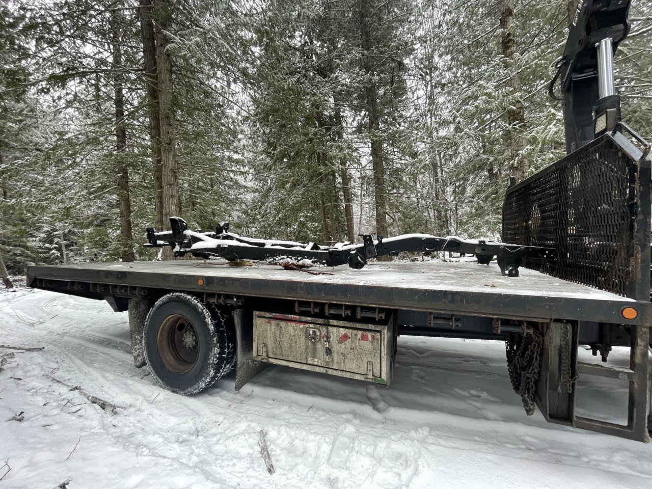

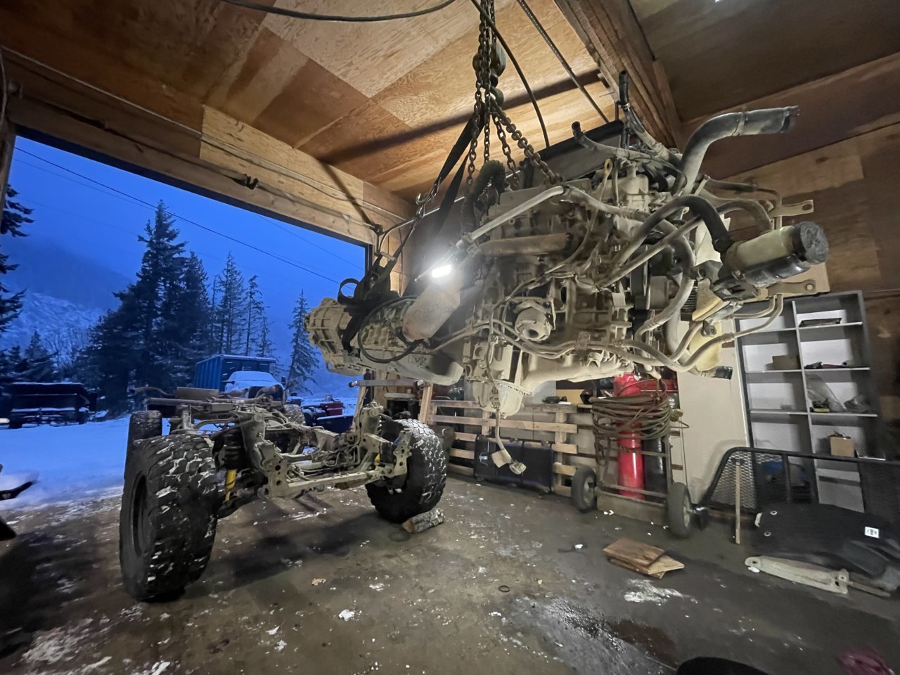

    Made a bit of progress today. Had a buddy come around with a HIAB to move the frame and lift the cab off. It made life a lot easier haha.
    Then while had the time I thought I might as well continue tearing the frame down. Engine/transmission/tcase all out as one assembly. Pulled the driveshafts and exhaust as well.
    All that’s left is the suspension/ diff’s and frame wiring before the old frame gets chopped up.
