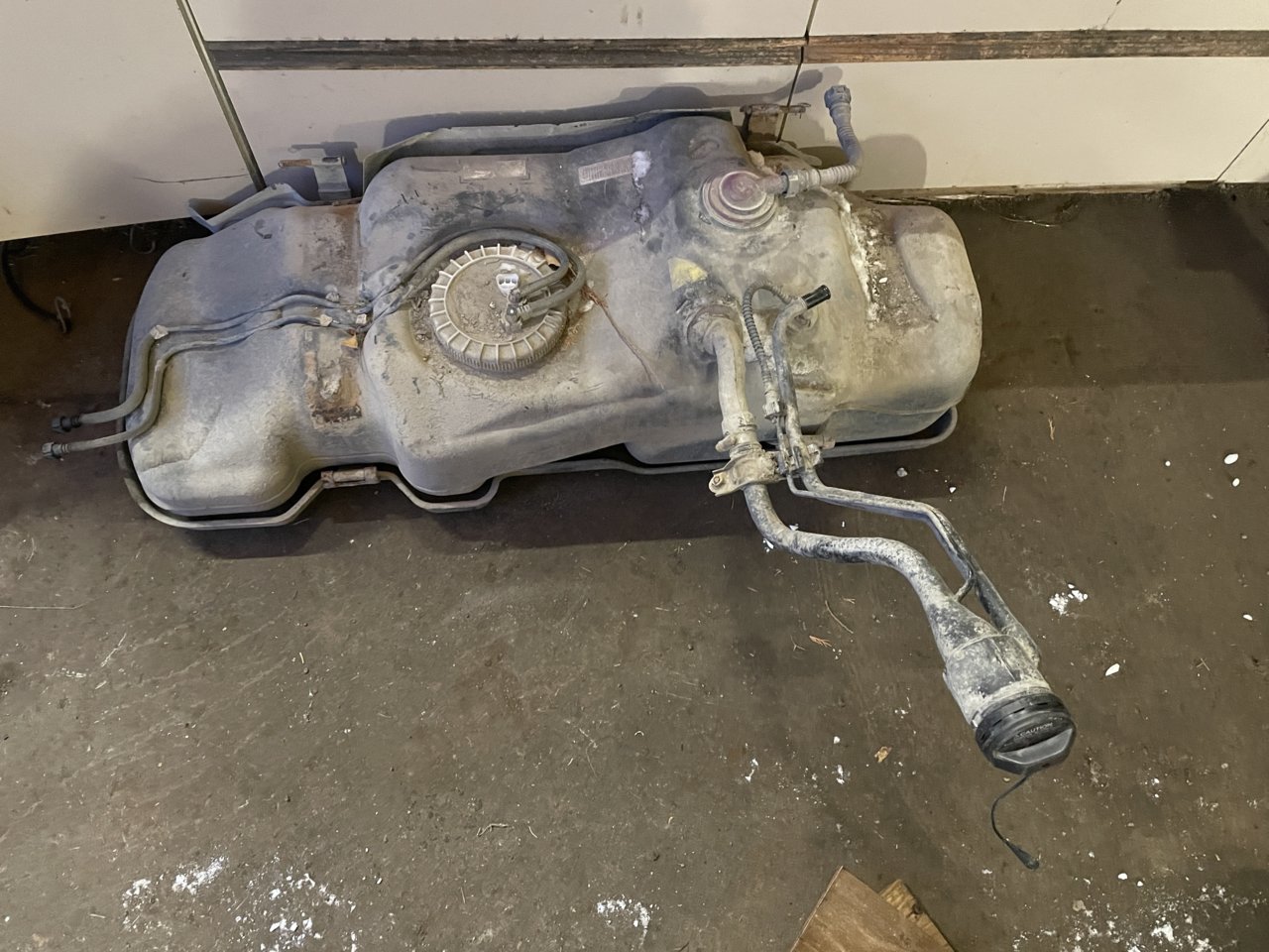

    Fuel tank is out. The 2 band that hold the tank up were pretty stuck in there due to rust. I had to cut the bolts out on the frame side due to it snapping the square nut in the frame.
    By the time I had done that I was over the cold. Back at it tomorrow.

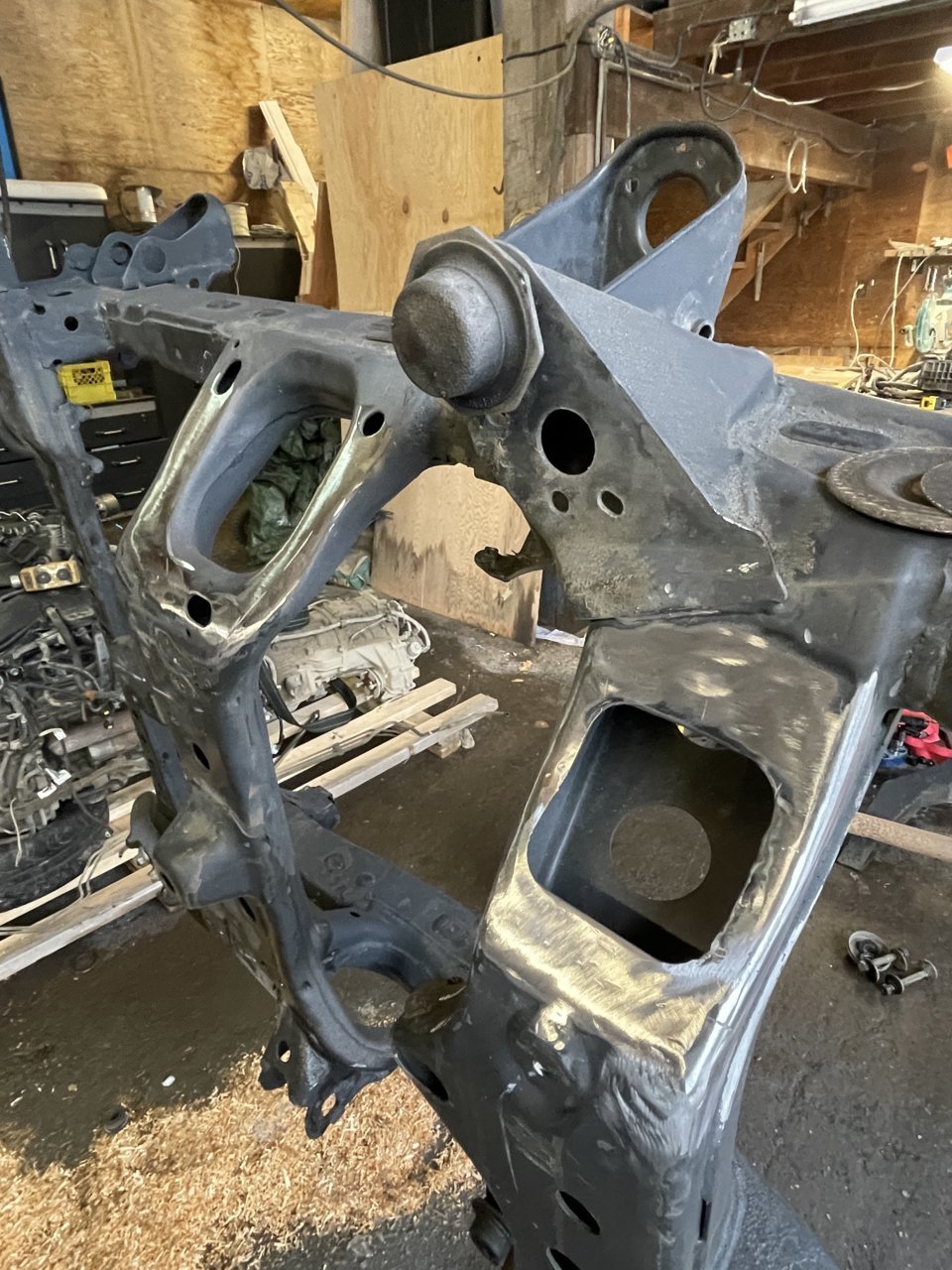

    Wow Nice! 454 Motorsports is wrapping up my DMZ SUA kit right now! Such a neat process. He also burned in the DMZ Frame boxing kit, but one neat thing he did was dimple died it for extra strength. IMG_1920.jpg

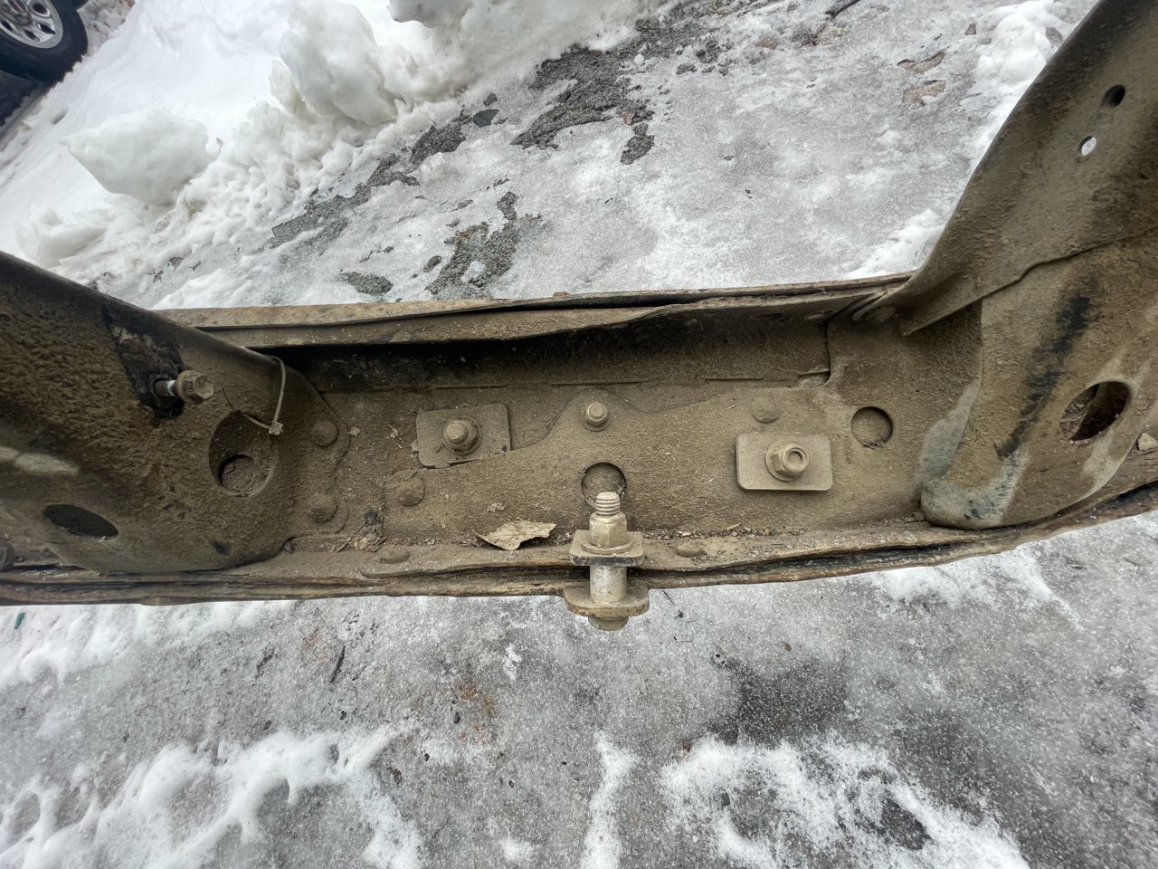

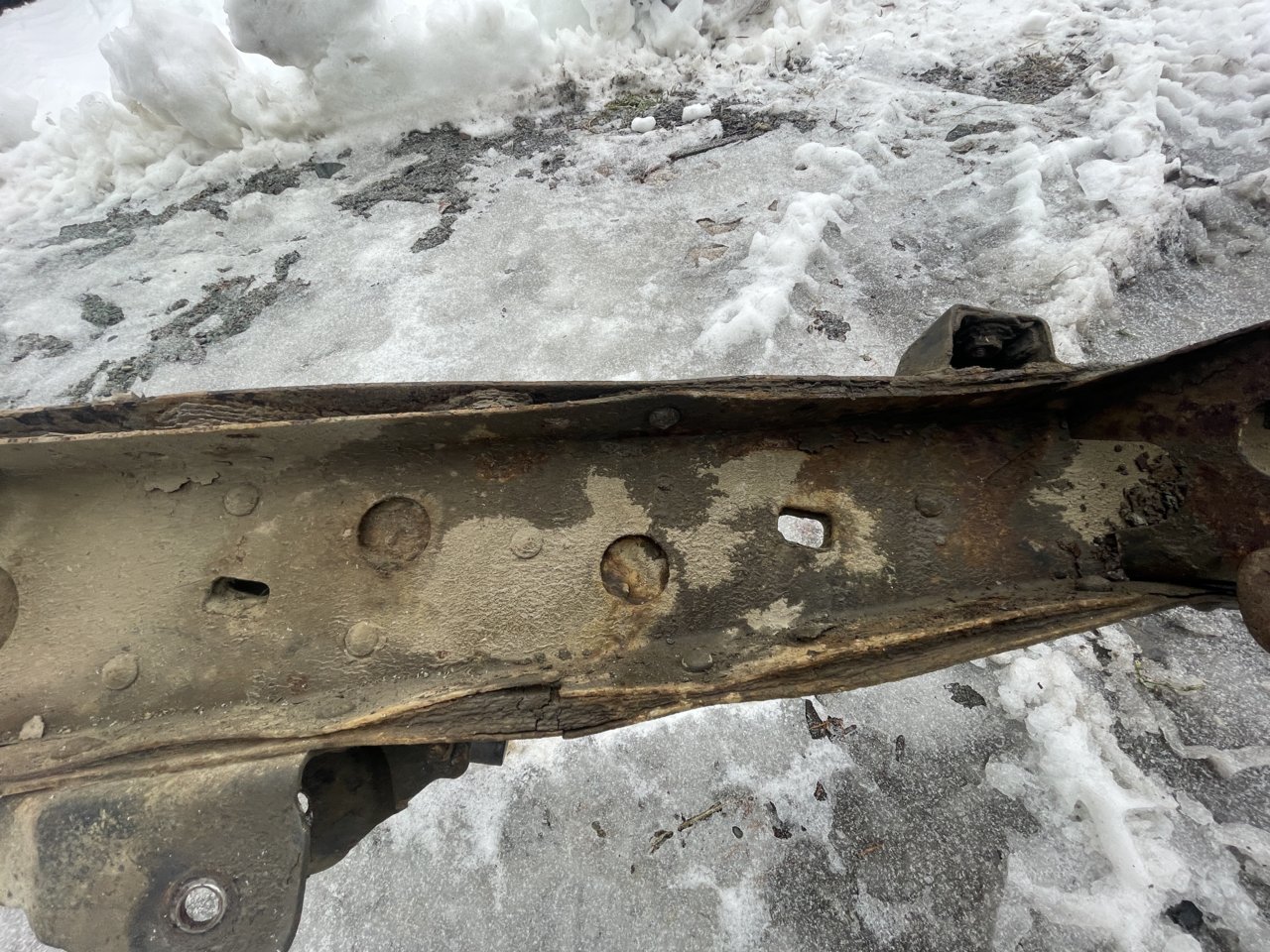

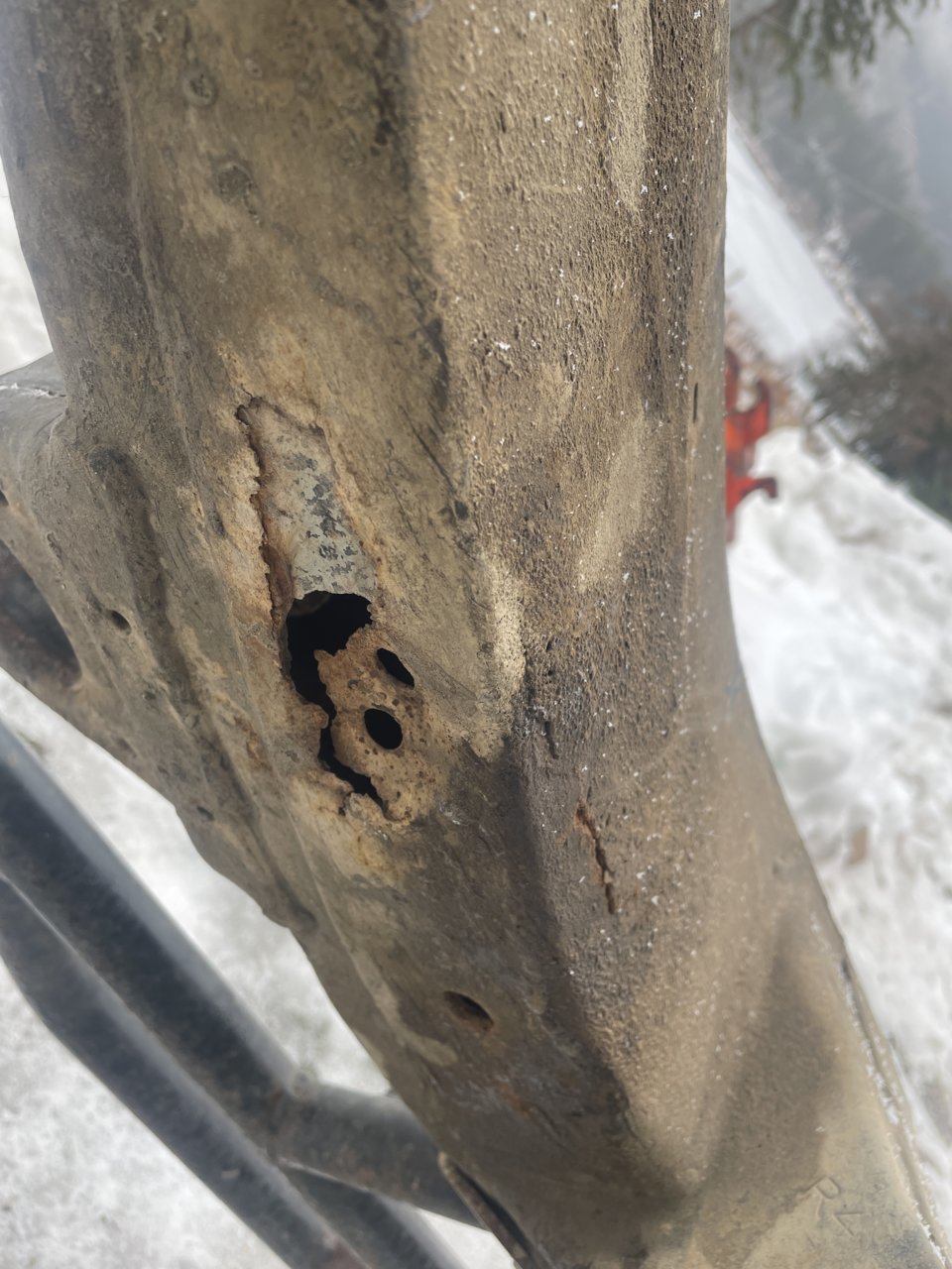

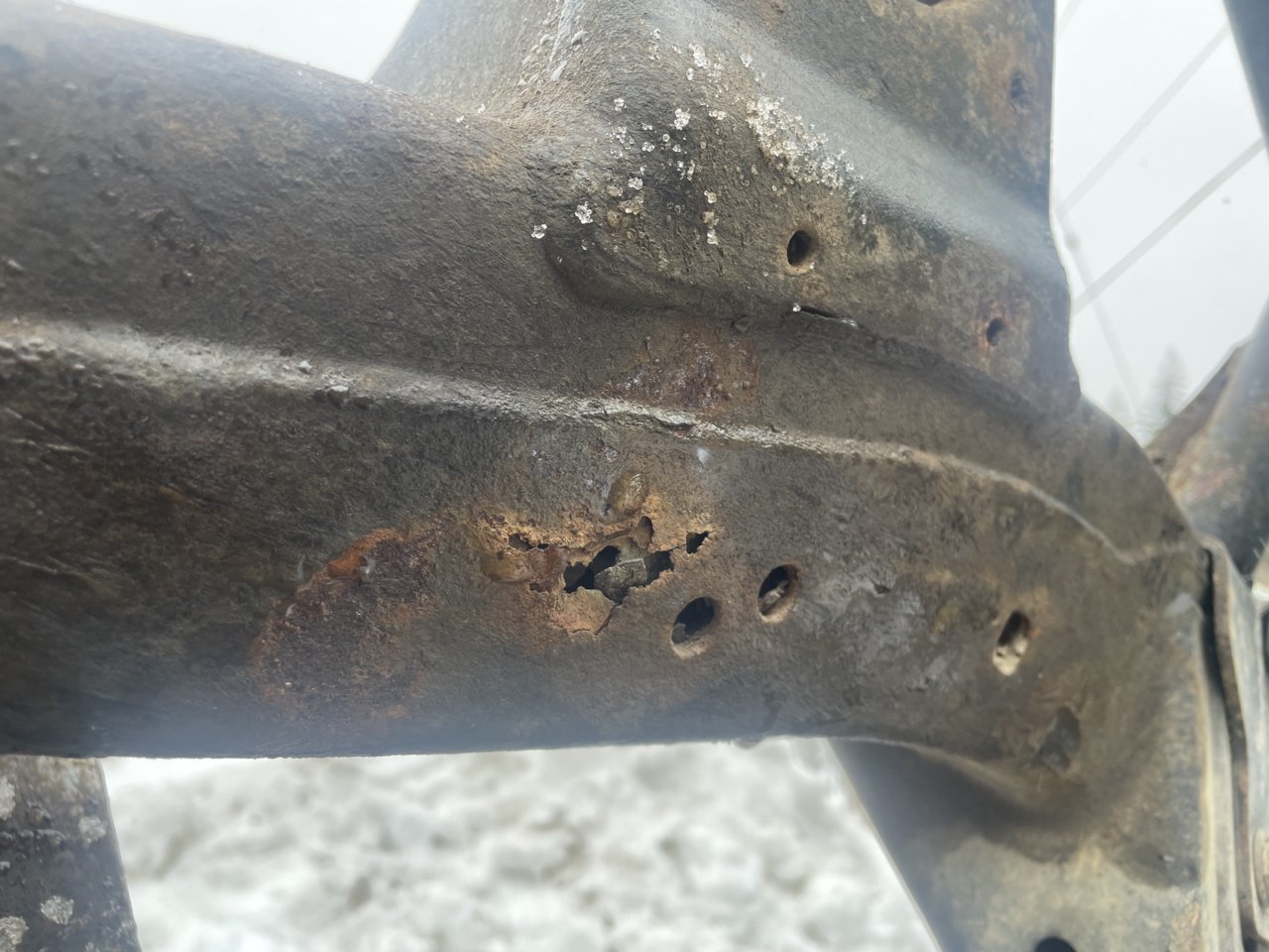

    Here’s a few of the culprits. It’s definitely not the worst I’m sure but still a pain to have had to deal with.

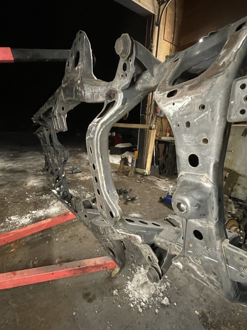

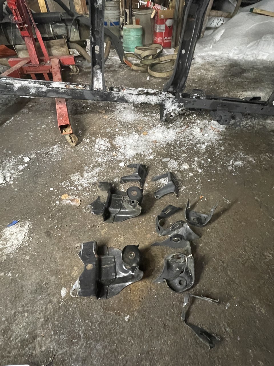

    Had a good day cutting and grinding all the rear suspension mounts off and did the same to the LCA pockets as well.
    This would suck to have to do on the ground.

    BC
    Yeah those are nasty holes. My frame looks similar unfortunately...

    In the first picture, you can see the rough outline of where the frame was patched prior to me buying it.
