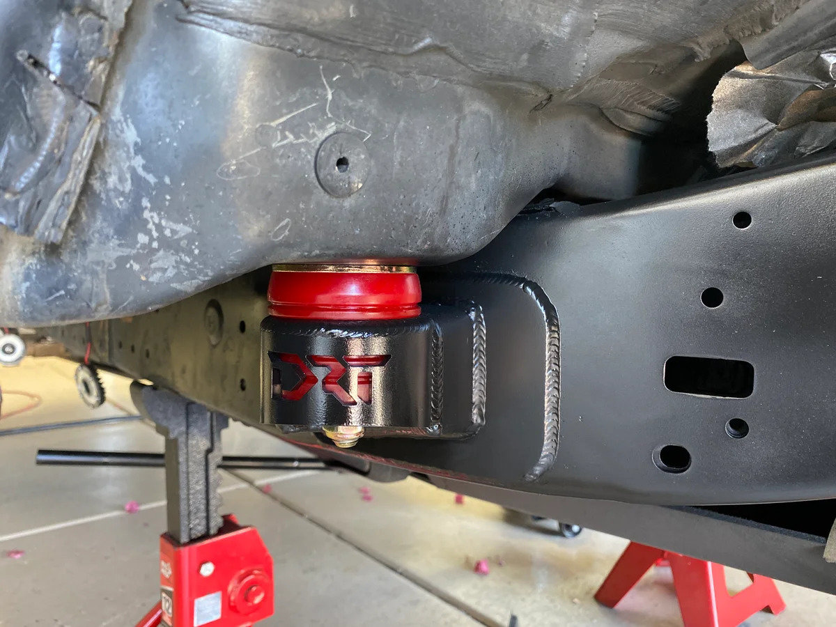

    If you're going full LT you should do a CMR, not a CMC. I have 35's with a CMC and it still rubs. Going to be doing a CMR when the front stuff Is installed, going with DRT Fab.

    I’m gonna hazard a guess that he’s going with the JD Fab LCA pivot kit that lets you move the wheel forward. Not really a good idea to sacrifice the cab mount altogether for a truck that still get driven on the roads a bunch. It’s there to keep the tire from crunching your legs in an accident.

    I’m wanting to keep the factory cab mount as long as I can with the CMC and if I can’t can’t get it clear properly then I’ll relocate.

    yea it’s going to see some long distances especially driving south so I’d would like to keep the cab mount to avoid exactly that.

    I mean it's not a removal, just a relocation. the mount itself stays in the same place, but the part where it attaches to the frame is a bit further back.

    Well you are effectively removing the frame horn’s ability to stuff the tire in an accident. But anyway, don’t mean to high jack…

    You make a good point. But hey, if im prerunning my truck and get into an accident severe enough to push my tire into the cab, you'll know I died with a smile on my face.

    Depends on the wheel/tire combo. I've installed several of the JD pivot kits now, and some trucks still rub on an aggressive cmc + the firewall with the LCA pushed all the way forward, and some don't.
    Maybe you should just do a cmr, cuz I know you're gunna wanna do 37's eventually anyway

    Good to know. On my old frame I had the CMC and only had rubbing at full stuff and tuck.
